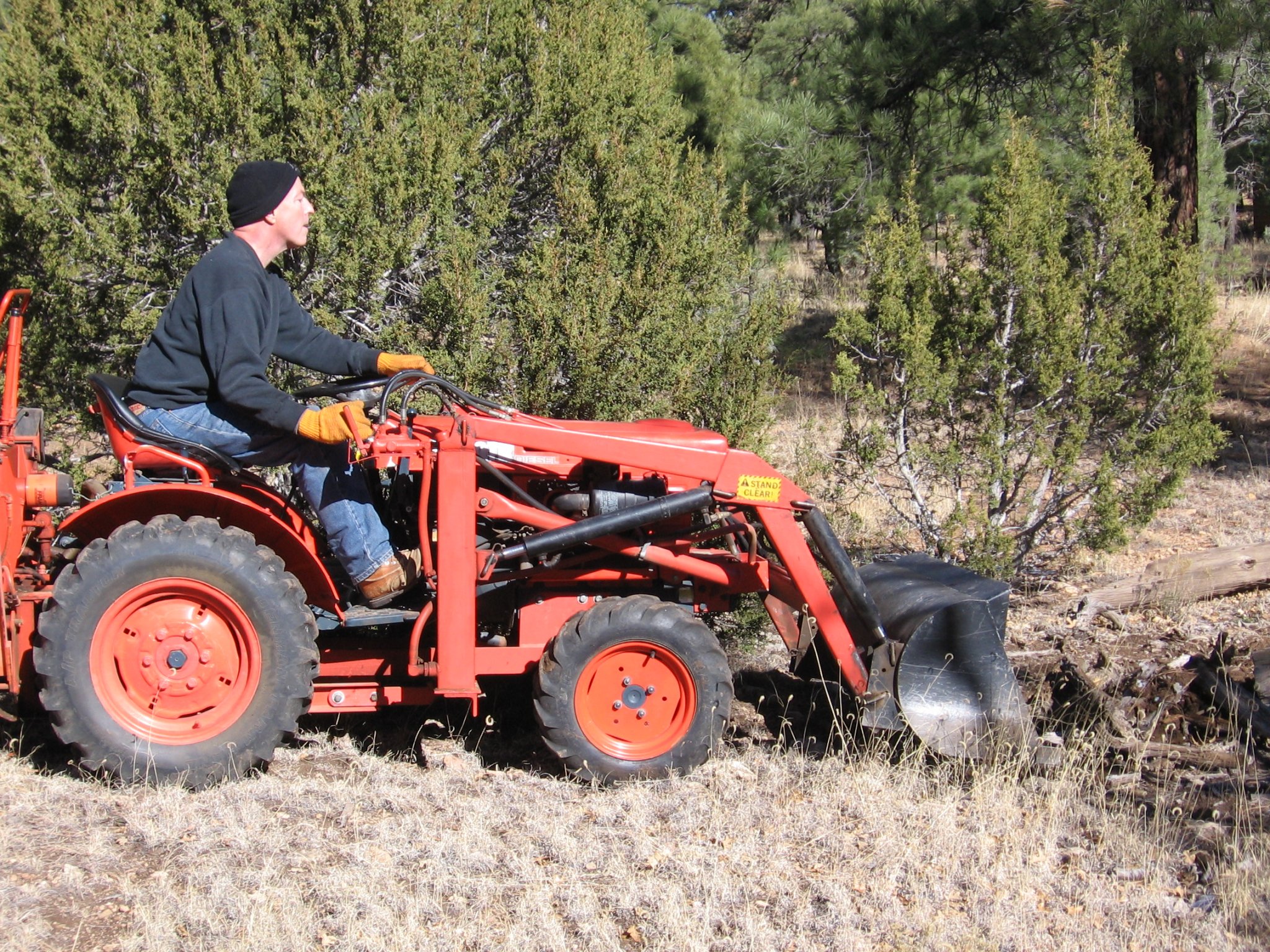

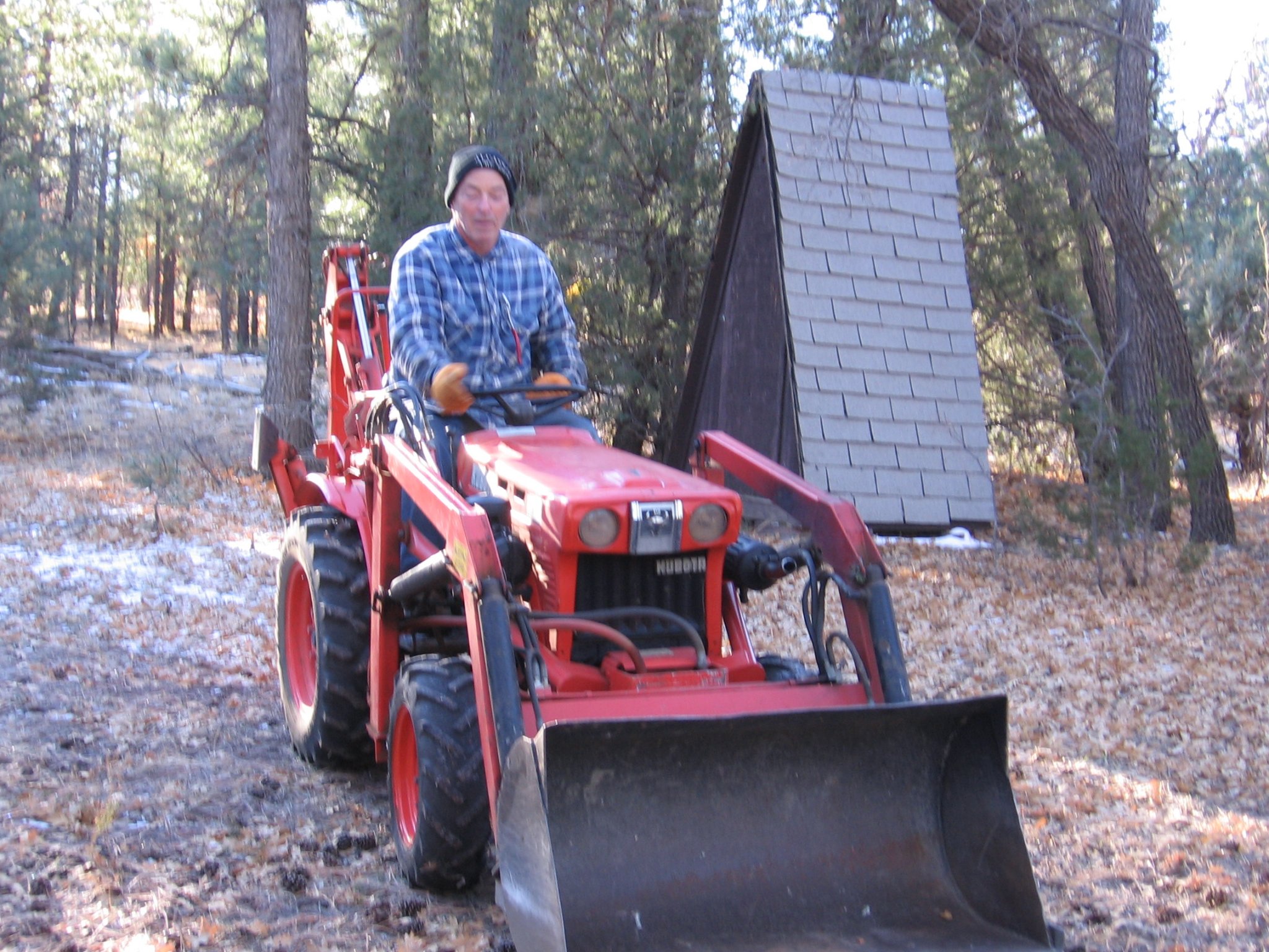

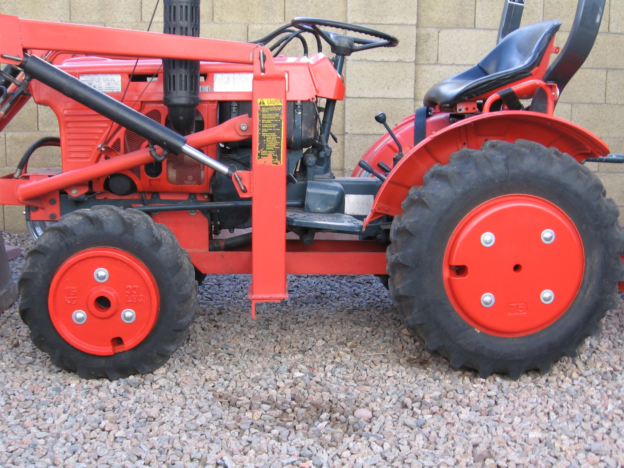

Don't know anything about B6000 tractors, but the loader appears to be a B219.
I say appears because it looks like there is an extra crossmember on the loader frame, right in front of the radiator, down low. And either your tractor is a lot smaller than a B7100, or that bucket is wider than normal, although the design looks like a a standard bucket, which is 42" wide.
The location for the nomenclature plate is on the inside of the left upright, down low. Mine was heavily painted over. Some appear to be missing altogether.
Some pics for comparison:
View attachment 45864 View attachment 45865 View attachment 45866
