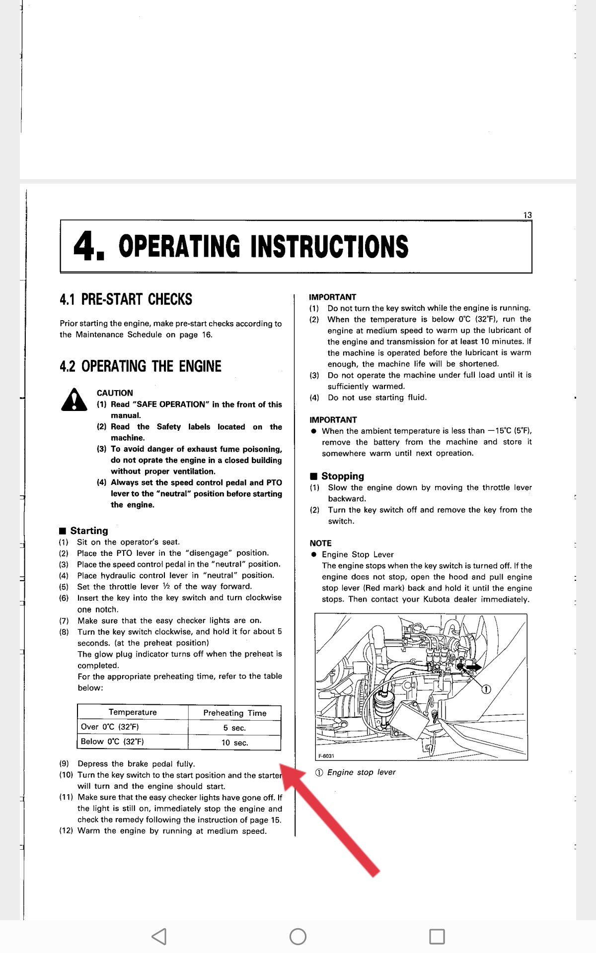

2) My understanding is that the glow plug light is on a timer.
Others on here may know better - and if I'm blowing diesel smoke up your skirt - but here's my guess. According to the owners manual you turn the key to the pre-heat position and the light comes on. The light goes off when the pre-heat is complete. Then you can start the LT. So it's probably a sensor (bi-metal strip or thermistor like in your kitchen oven) that is closed when cold and opens when it gets hot (so yes it would know if your plugs are working). Not a timer (i.e. electrical timer).
If you're having issues with the glow plug light or glow plugs themselves there are older posts on OTT discussing this in-depth.
