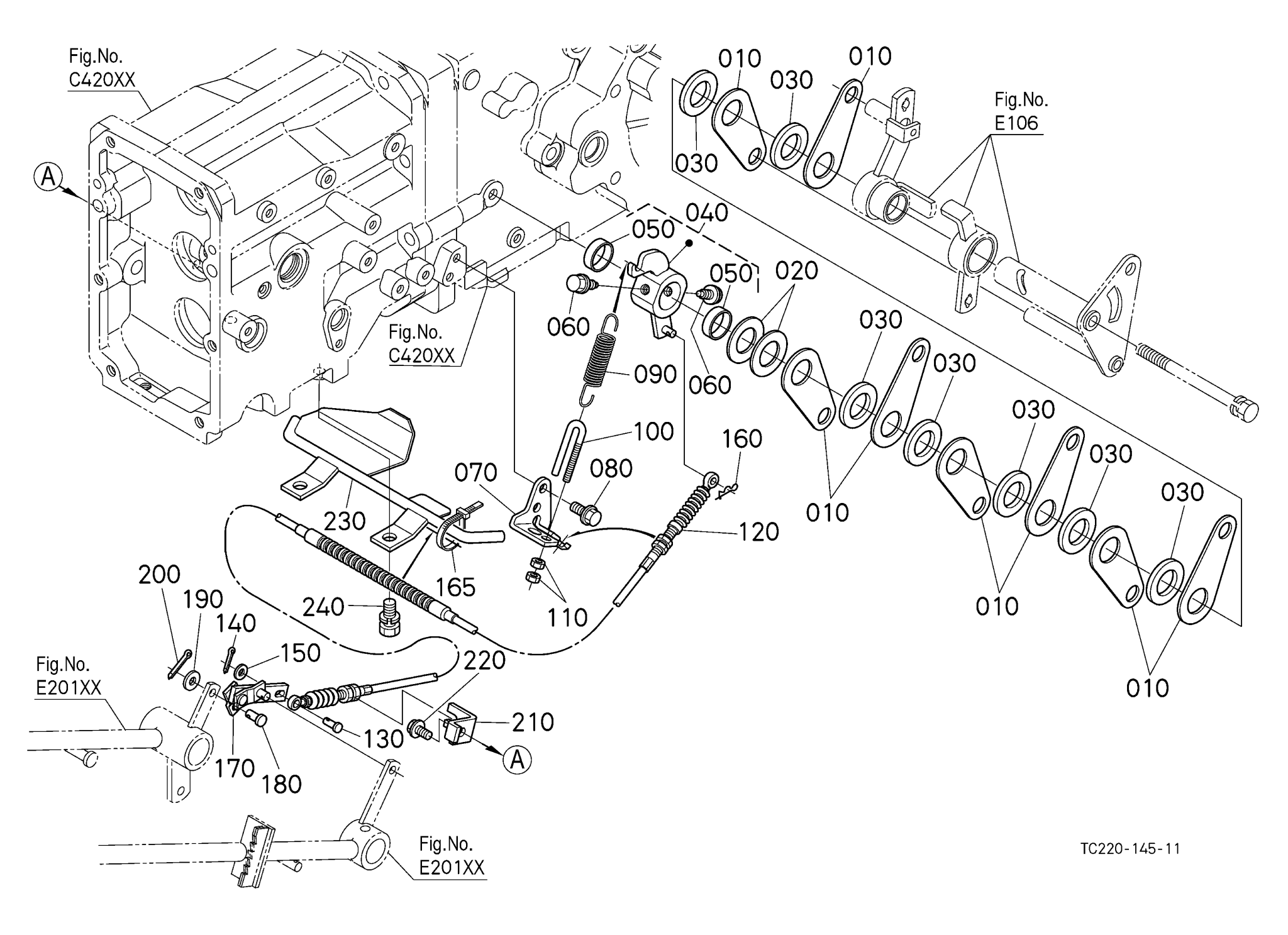

I was lubing my L2800 yesterday when I came across a fractured cable and I have no idea what it is for. It is a wire cable in a sheathed jacket, 24" long, connects from the foot brake linkage at one end, then goes under the transmission and the other end connects in the middle of a s-load of links and levers coming out of the opposite side of the HST. Both ends of the jacket have 2" of threads making it adjustable in their respective mounting brackets.
I haven't noticed anything not working so I am baffled. Anyone have any ideas?

Thanks guys. That's it, #120. Never have used cruise control. Yep, I just checked, the lever is there but if you had asked me yesterday, I would have denied I had cruise.
Where did you get that great parts breakdown sheet? Are they available online?

Just a little more information... what it does, when you have the cruise control running, if you hit BOTH brake peddles... cruise control lever will be canceled (physically the lever will be pulled back to neutral). If you only hit the left or right brake, cruise will still function as is. Great for quick "U" turns!!!
And Cruise Control was standard... not sure when that changed, I know it changed when the next model, L3200 came out but not sure if the L2800 "Extra Power" (2008) if it was standard or was an option.
