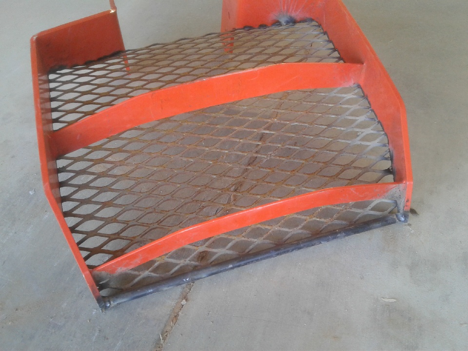

I welded my grill guard in place. and painted it. Brush Guard 1.jpeg Brush Guard 2.jpg Brush Guard 3.jpg Brush Guard 1.jpeg Brush Guard 2.jpg Brush Guard 3.jpg Brush guard 4.jpg Grill guard 1.jpg Grill guard 2.jpg Grill guard 3.jpg I used a 1/2" steel rod on top & the bottom is open. I did the expanded metal to weld in & hoping to get a grapple in the near future.

Looks Great, and your right, if you are getting a grapple you will need one. Apparently you didn't have any problems with the dimension changing when you took the guard off the tractor? I know when I did mine, if I took the guard off the mounting brackets opened up and would have had problems getting it back on if I would have welded off the tractor, so I built mine mounted to the tractor.
After using the grapple in the woods I almost poked a hole in the hydraulic filter from a bush that had been cut off. So just cause you can protect the grill, be aware of other bad thing that can happen. I hope to fabricate a skid plate to protect the filters under the tractor this winter if I can find time.

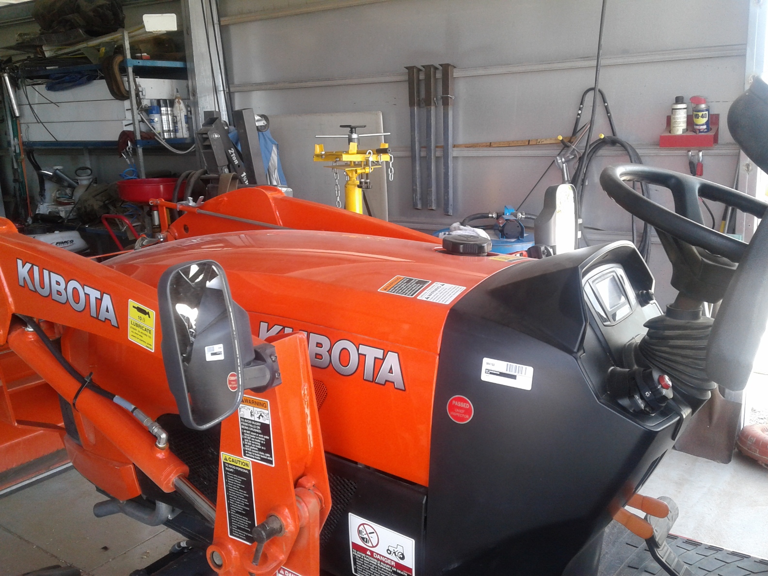

What type of mirrors you got there?

what thickness / gauge(?) are you guys using for the expanded metal part? Im not sure what to ask my supplier for, need something a novice like me wont blow through with the mig either.
Mirrors.jpg The mirrors are just some i seen on amazon I used alum angle and drilled and taped the sides of the FEL. I had to make them very tight so they didn't vibrate and move, I use them mostly to watch the sides of my box blade so is not to hit anything. they sure come in handy.
I measured my expanded metal and it appears to be about .150" thick. Might be 1/8 inch nominal thickness and after painting and rough edges it measures .150". At first I thought it might be a little too thin but the other scraps in the "shorts" bin at the welding shop were way to thick. As it turned out, once welded in place there's no doubt it's thick enough. I placed mine on the outside of the grill frame and its like trying to compress an eggshell inwards after welding it in place. I'm sure welding it in place on the back side gives the same results but I wanted all the room i could get on the back side for when opening the hood. On the B2650 there's not much space between the grill guard frame and the front of the hood.
Here's my grill guard: A $12 Kubota B2650 Grille Guard | OrangeTractorTalks - Everything Kubota
You won't have any trouble welding it in place. Even with the thin metal mesh....start your arc on the heavier base metal and move it to the thin expanded metal for just enough time to accomplish the weld.
I did not make a grill guard, but I did use expanded metal to fabricate a guard that covers my hood and head. I think I used 10 gauge expanded metal.
Keep in mind there are two versions of expanded metal, the standard one that is best for a non slip surface, as it has sharp edges, and a flattened type that seems better for our uses on the tractor.
I think the pictures in this thread show the flattened expanded metal.

View attachment 51345 The mirrors are just some i seen on amazon I used alum angle and drilled and taped the sides of the FEL. I had to make them very tight so they didn't vibrate and move, I use them mostly to watch the sides of my box blade so is not to hit anything. they sure come in handy.
Nice mirror setup, but I'd need the mirrors when the snow blower is mounted on the front instead of the loader. Hmmm...

What ya need there is "forward view" mirrors. So you can see forwards when going backwards.
