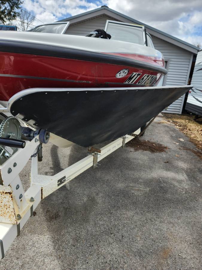

I’d never-before seen the hull-shield you posted in the pics 1911…. I like those. Where/How
much?
(They look like they’d maybe be of some assistance loading-up in rough-seas also.)
I have 0.6 miles of gravel road between the highway and my house and I pick up lots of stones in the tread of my tires which get flung off when I'm heading to town. So even though I drive slowly, stones are a regular part of driving for me, not to mention rocks falling down onto the roads up here given the geology of this part of the world.
I'd never seen them either but they're called rock guards or gravel guards.

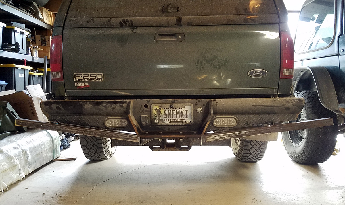

For the record, I'm not focused on the trailer rock guards at this point but on something for the back of the truck.

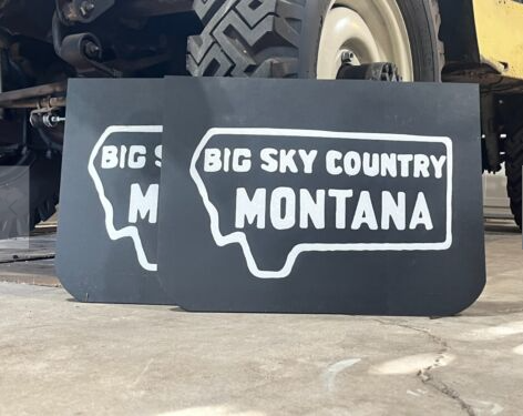

I ordered these generic 30"x24"x1/4" polymer panels and will make a custom bracket that bolts to the Ranch Hand rear bumper. I'll be using these panels with the 30" edge horizontal and trimming the panel to match the bumper. This should keep rocks from smashing the boat or tractors when towing.

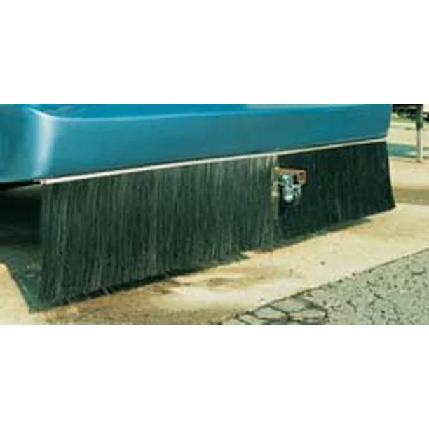

I'm a fan of the Brush style rock guards as they have less wind resistance.

Thanks for suggesting that. It made me think about this some more and convinced me to run some numbers. I measured the distance from the center of the rear wheel to where the flaps will hang and it's 4'-4". So if the flaps are 1.75" from the ground they would in theory result in straight line protection to an elevation of 12" that's 29'-4" behind the rear tires (back of the boat on the trailer). Obviously, 3.5" from the ground would result in 24" elevation at the same distance. I think I'll start at 2" since this seems like a good combination of protection vs. ground clearance.
I've rummaged around in my scrap pile and I have all the steel I need to make up something decent. The polymer panels have shipped and will be here Wednesday or Thursday so I'll get busy making up the bracket. I'll show some photos over the next few days.

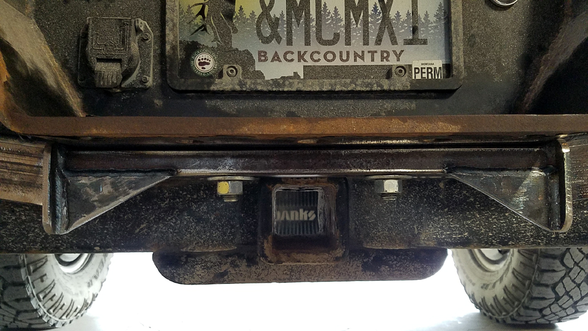

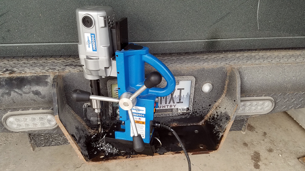

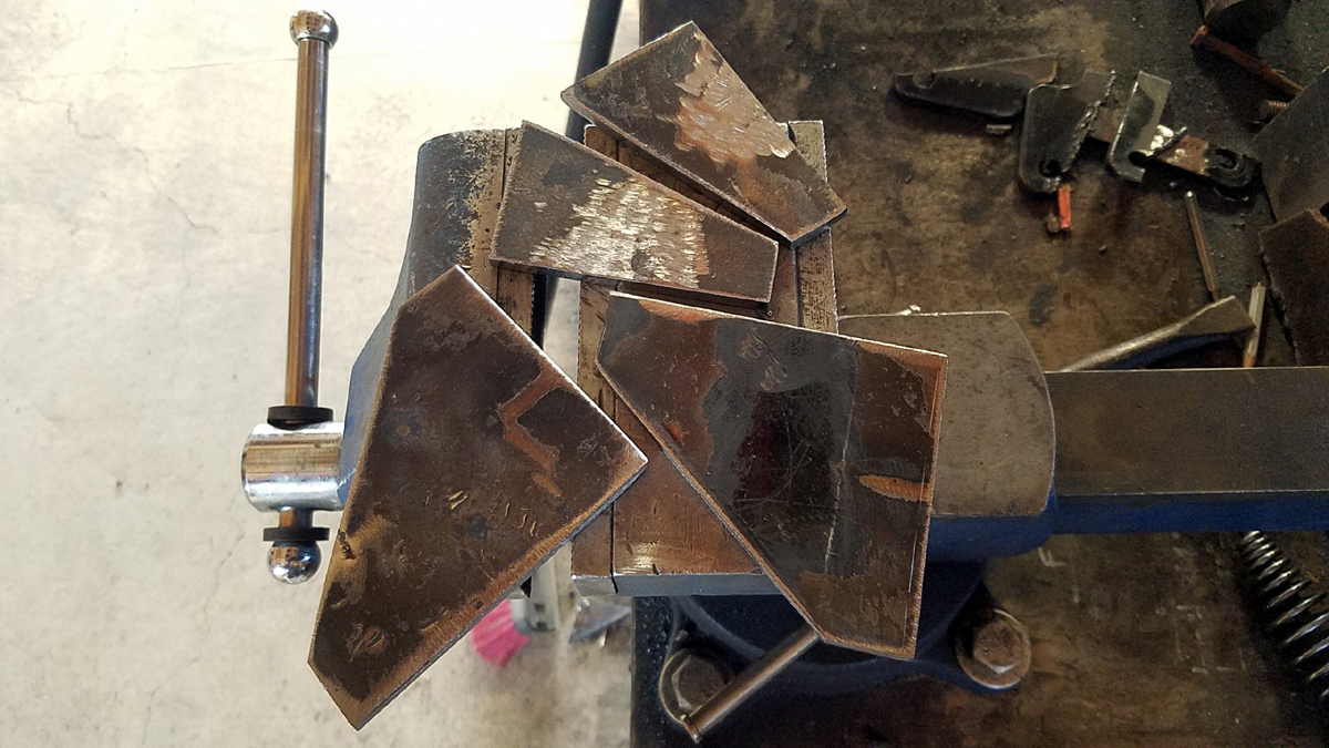

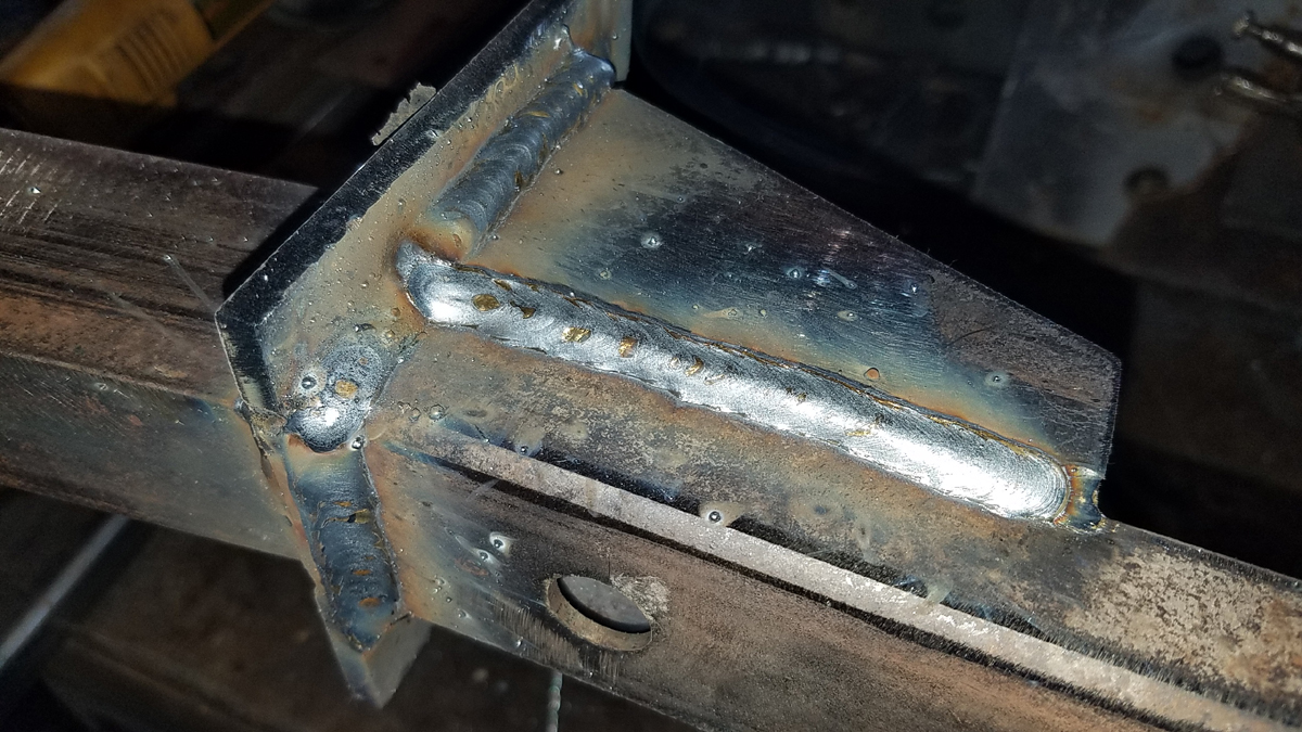

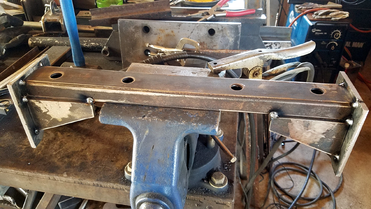

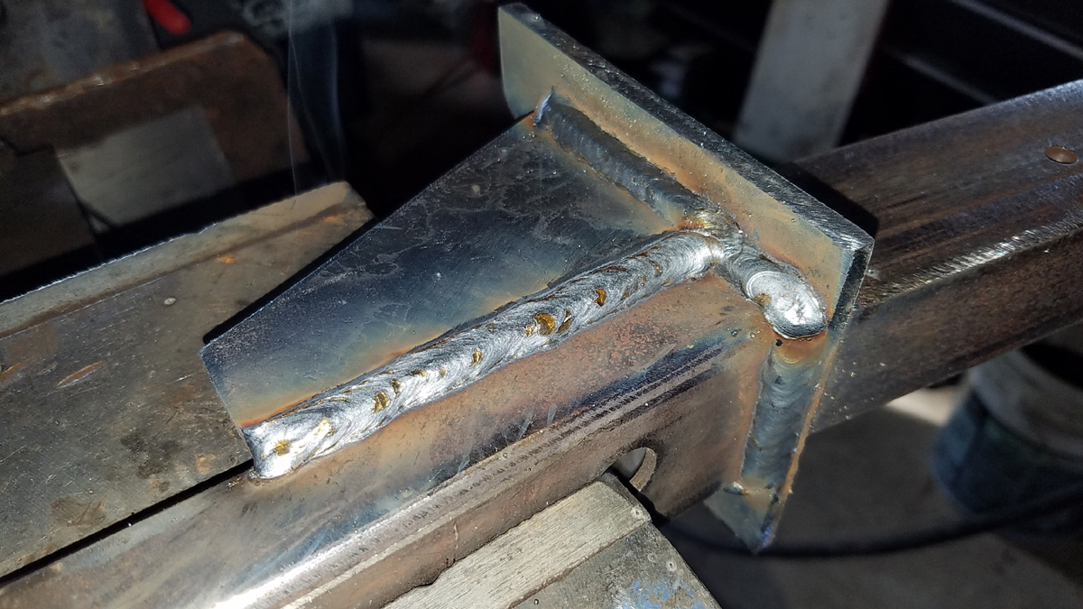

I'm making progress on the budget Rock Tamers using scrap steel. The two polymer panels will be here tomorrow so I'm trying to get the hardware ready. As I mentioned, it's not practical to install the Rock Tamers with my setup so I came up with a plan to bolt something under the Ranch Hand bumper and above the 2-1/2" receiver that could support the mud flaps.

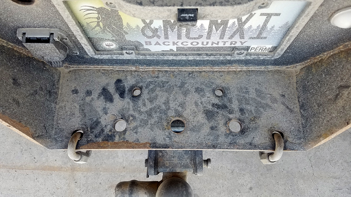

The Hougen mag drill is such an amazing tool and it made quick work of opening up two existing holes in the 1/2" plate to 5/8" and adding two more. The reversible handle is really nice when space is limited. With the mount bolted to the bumper using the center holes I drilled two more holes through the 2"x1"x.125" rectangular tubing to avoid possible alignment issues. I'll be using 2"x1-1/2"x 3/16" angle that will be welded to the end plates of the bolted mounting tube at an angle that follows the lines of the underside of the bumper. I added gussets to the end plates due to the load on the angle from the weight of the flaps and wind loading.
Next up is to finish welding the mounting bracket, cut and drill the angle, and then weld it to the end plates on the mount. I'll post more photos as I make more progress.

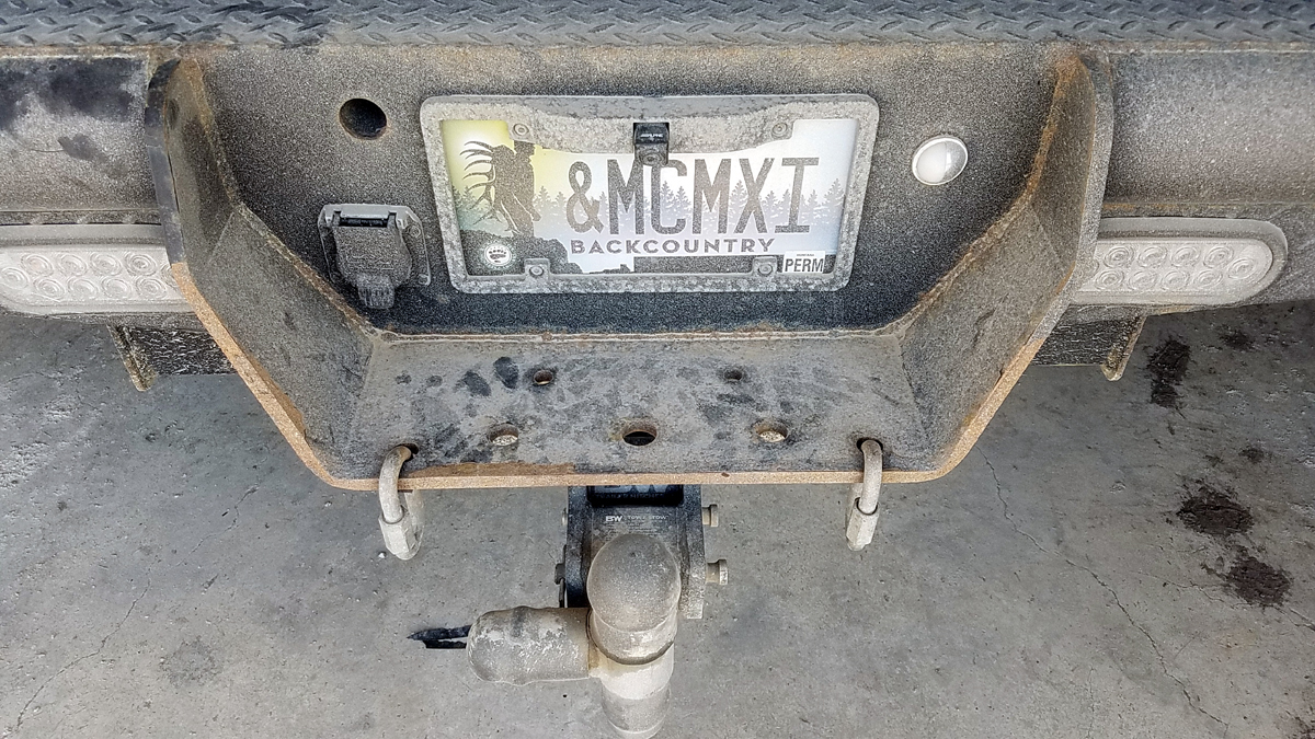

One unrelated thing I want to do is drill larger holes in the step bumper so that I can use shackles (7/8" pin) as attachment points for trailer chains. I don't use the hardware hanging off the bumper for chains but rather have to mess around under the bumper getting the hooks through holes in a plate beneath the receiver. It's a pain and shackles will be a lot easier.

I managed to finish up the mounting system last night but left the two pieces of angle long so that I can trim to a desired width once I've fitted up the mud flaps. As is often the way, I made some changes (improvements) to the end plates and gussets. Overall I'm really pleased with how this is turning out.
I pre-drilled the angle for 5/16" bolts on 6" centers to mount the flaps, but might also use two sections of some smaller angle to sandwich the flaps. I'm not sure if the 1/4" polymer material would hold up to just using bolts, nuts and washers on 6" centers. Clamping the flap between two pieces of angle would certainly be stronger and would provide more support for the flaps under wind loading. Yeah, the more I think about it, the more I like that idea.
