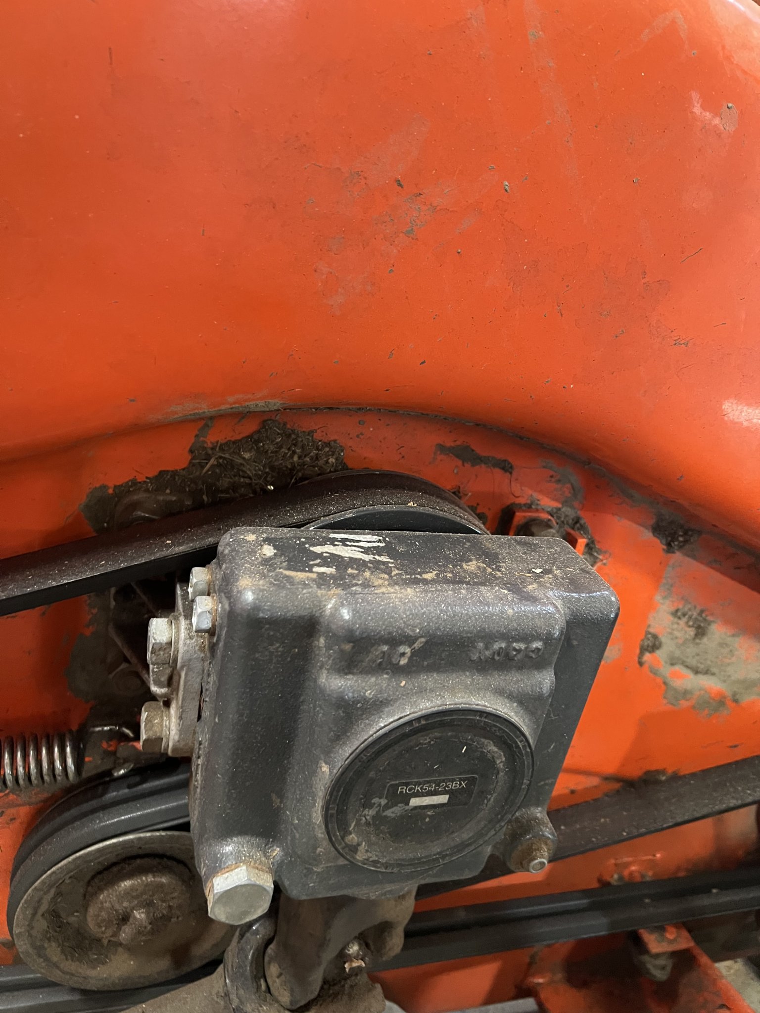

I change mine every Spring. It takes less than a pint, and takes about twenty minutes - most of which is waiting for it to drain.Have a 54 inch belly mower. How often do you change the oil in the gear box? Follow the manual? Every season?
Same hear. Will change mine before mowing starts. Do you folks get the oil from Kubota or off the shelf? Book calls for SAE 90 GL5 gear oil.Oh boy. I feel ashamed I think I am coming on 3rd season.
Got my first quart from the dealer (over-priced). After that, from Advance Auto or NAPA.Same hear. Will change mine before mowing starts. Do you folks get the oil from Kubota or off the shelf? Book calls for SAE 90 GL5 gear oil.
Yeah, that'll do it. Make sure to put a tray or absorbent mat/rags under the deck because the oil will drain thru the hole in the deck housing onto the floor/ground.If i am reading this right, remove both plugs to drain, then put lower one back in and squirt oil in top hole until it starts coming out/the amount it calls for. Will be my 1st time doing this so don't want to screw this up. Thanks.
Have you tried a form a funnel to at least direct the drip to some containment apparatus?Yeah, that'll do it. Make sure to put a tray or absorbent mat/rags under the deck because the oil will drain thru the hole in the deck housing onto the floor/ground.
There are several YouTube vids showing gimmicks to help prevent the mess, but the couple I've tried haven't helped much.
Haven't tried one, but from the pix it doesn't look like it'd work.Have you tried a form a funnel to at least direct the drip to some containment apparatus?

I am not sure you are asking me about the form a funnel or not but will answer as if you are…Your suppose to put oil in it ?
The large (21mm?) bolt on the top of the gearbox is the fill port.BTW, getting the oil into the box since its on the side, little squirts from the side with a nippled bottle?
