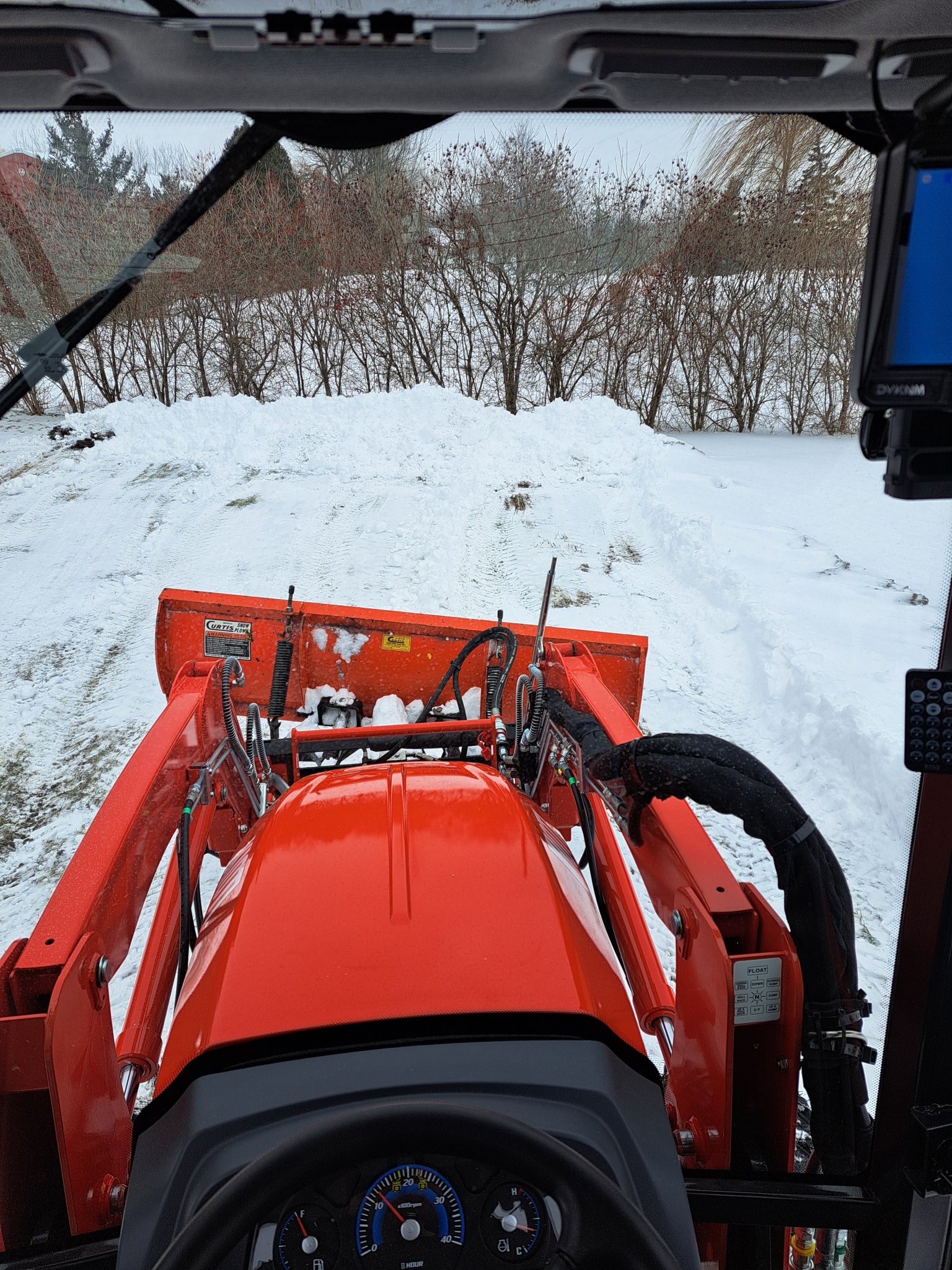

I plow using an L series and a 72" ssqa plow. This winter is my first time plowing with it and sure I definitely tore up the driveway more than I would like. To be fair...the weather has played a role. We don't get the deep freezes like we used to and so the drive way takes way too long to freeze and harden up. Last week it turned into soup.
But yeah plowing with an FEL takes skill but it's fun. I thought using float was gonna work...nope. What I end up doing is using the float to drop the plow down and then back out of float and lift a little that way it just barely touches and the weight of the loader and plow is on the front end of the tractor giving me better traction. It's surprisingly been working great for me.
Sometimes I can curl the plow so it's less aggressive and the plow rides on the pads, this has helped over the lawn and not tearing up the drive way but as a consequence it packs the snow under it and makes it slick so I try to find a balance.
I think overall I preferred plowing with my side by side. However the giant snow piles I made in my drive way and pushing it all at once with the tractor is something the side by side wouldn't even attempt lol. The tractor doesn't even sweat. Frozen snow banks? No problem with the tractor. The side by side stops it dead in its tracks. It takes me a little longer with the tractor but honestly not much, maybe 30 minutes more on average.
It's a heck of a lot of fun though. Open station for me but I don't mind...I'm inside a lot as it is. It's a nice change for me. Fresh air is nice and sometimes that crisp cold air is good relaxing especially when it's beautiful!
