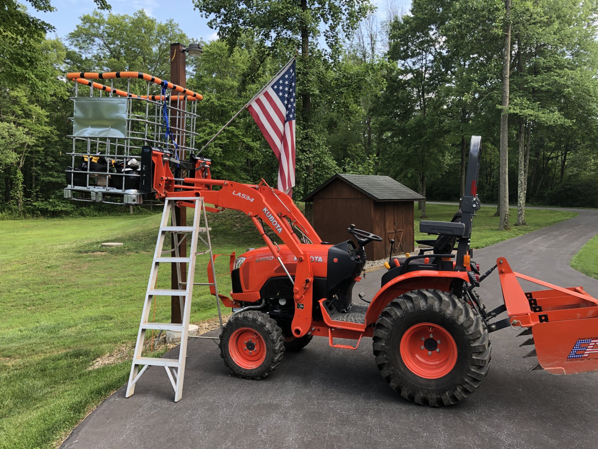

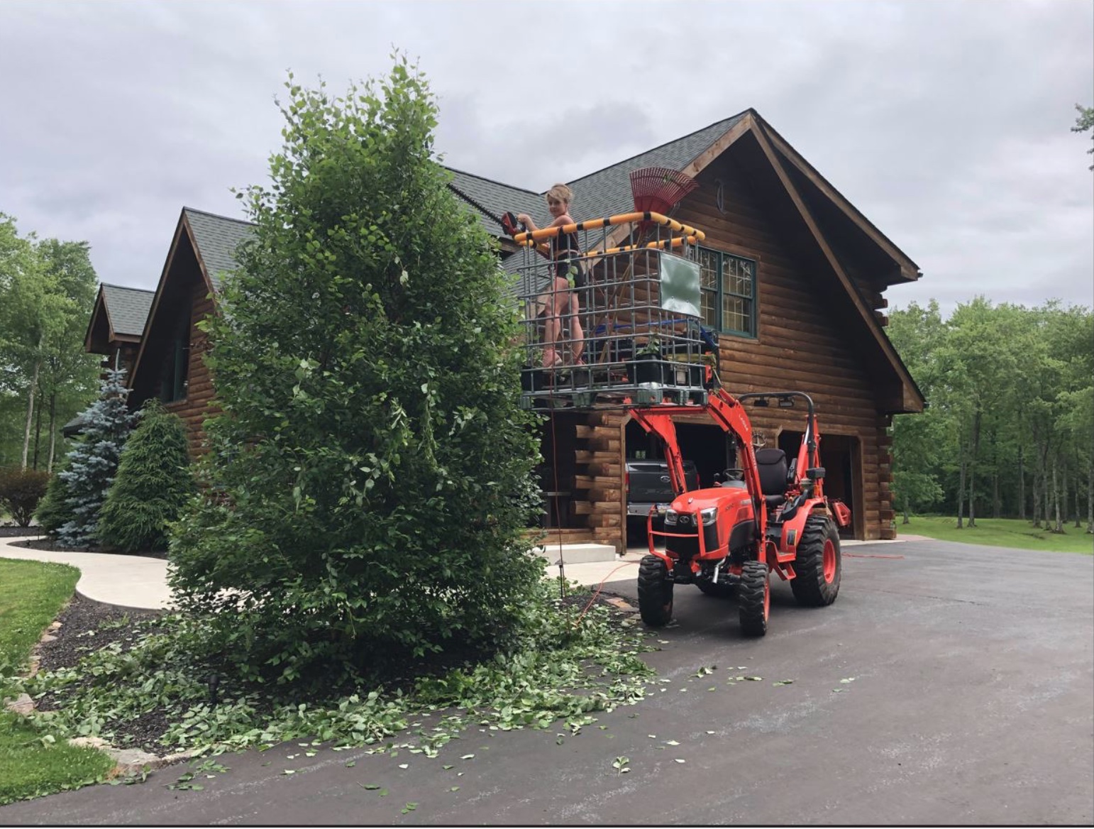

Not exactly what you had in mind...I "built" one, but it's known as a "woman lift", not a "man lift".

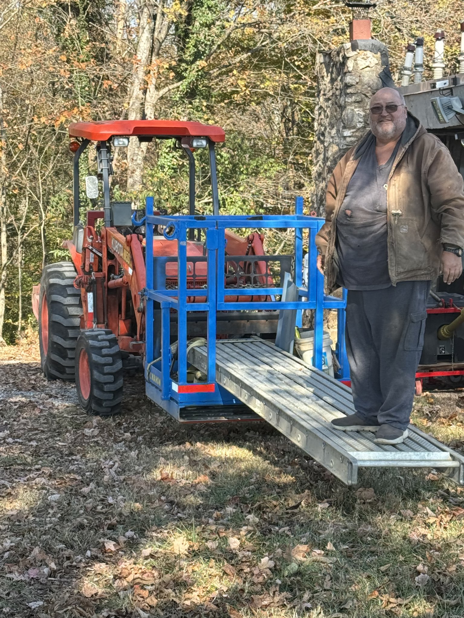

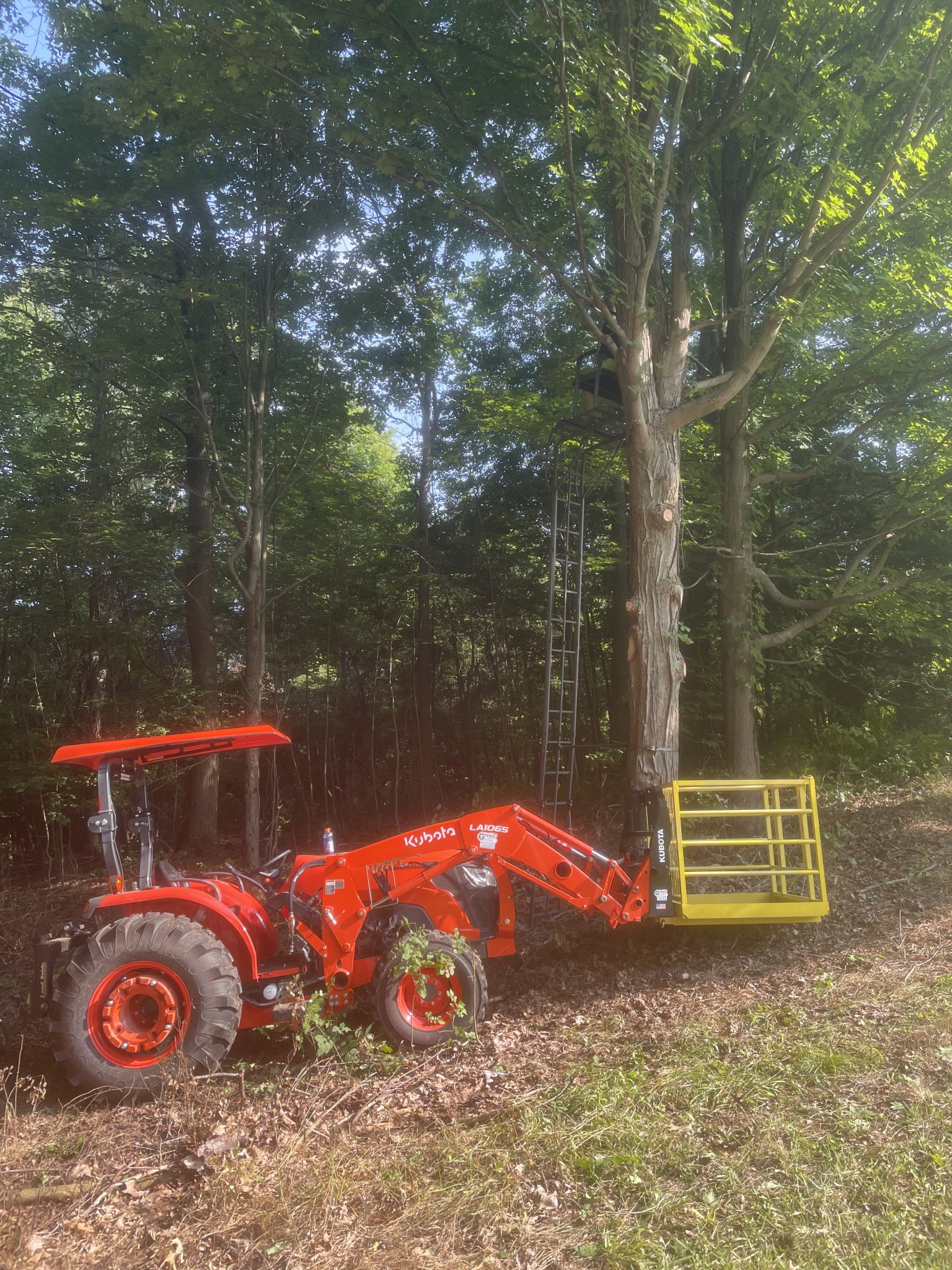

If you are wanting to use it on a tractor I’d look into ‘work platforms’ made for forks and forget the boom pole/ extension (just remember tractor has a center pivot from axle)
I have the same basket shown in the GrumpyFarmer photo and my wife loves it. Much better than her in the bucket. If you purchase a basket, pay attention to the listed weight of the basket. Some baskets are 70lbs shipped and others are 130lbs shipped. The 70lb ones are super flimsy.
As far as safety, hydraulic failure risk etc. Trying to clean gutters from a ladder or prune trees and bushes from ladder, also is dangerous and takes much more time and effort. IMO, The risk of falling from ladder is higher than the risk of hydraulic component failure on my well maintained 4 year old tractor.
I do take precautions with added ratchet straps around Q.A. and basket, ballast box mounted on tractor and the areas I am using the basket are mostly level. I am the only operator I would trust with my wife in the basket and she feels the same.

We have a platform basket for our tractor loader which secures to the forks. We use it when having a larger platform is perforable vs a ladder. Realizing that it isn't a replacement for a true aerial lift.

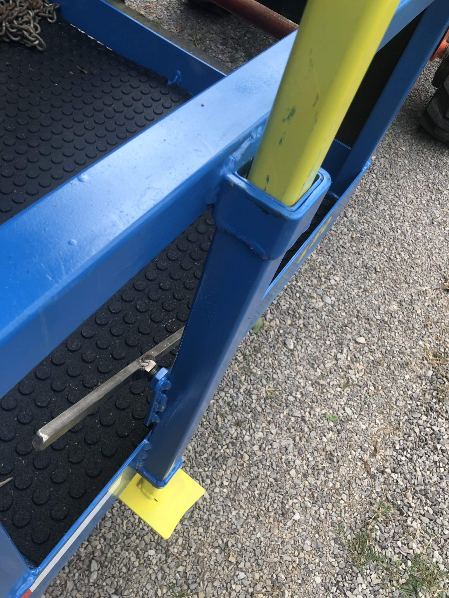

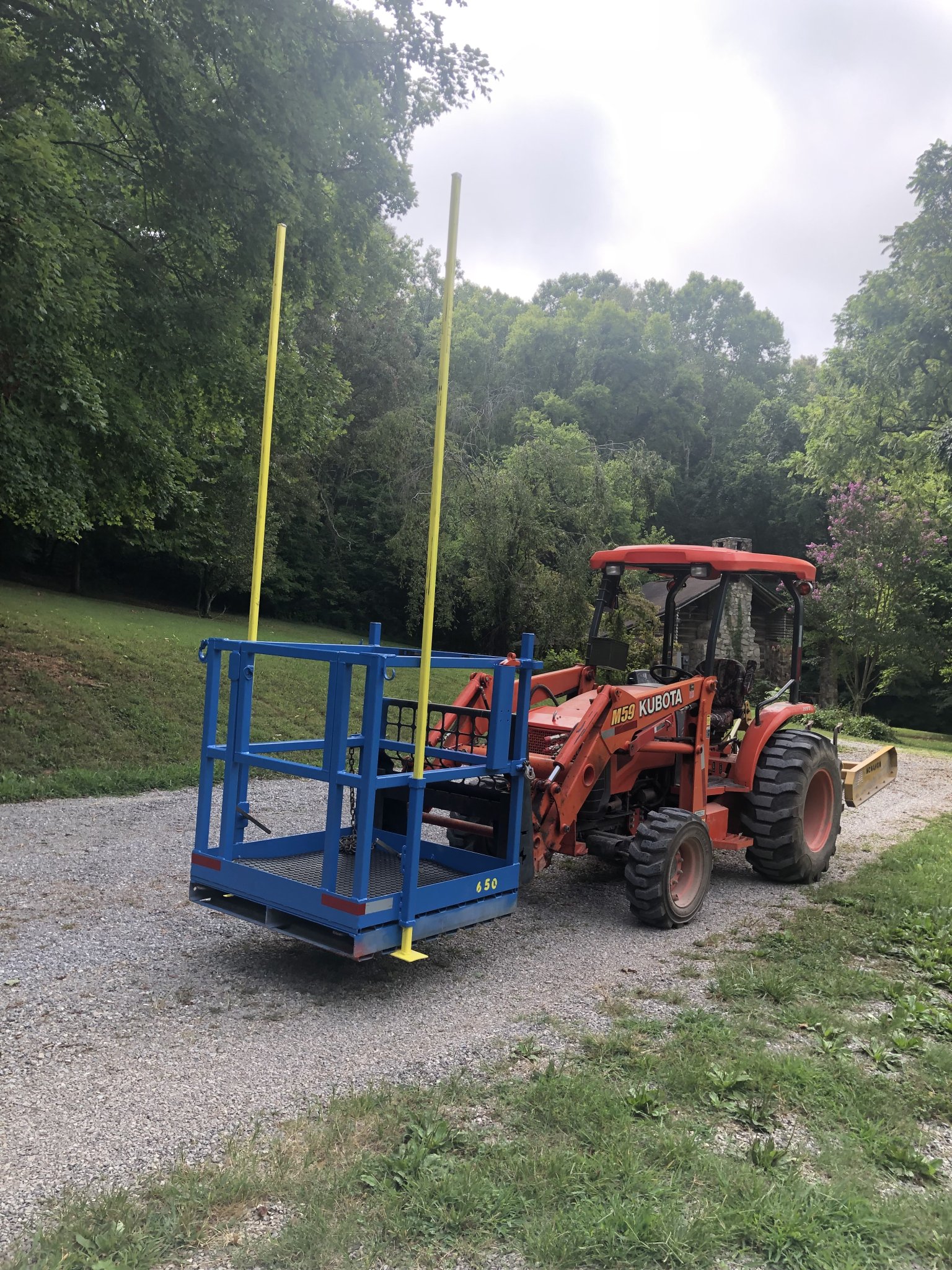

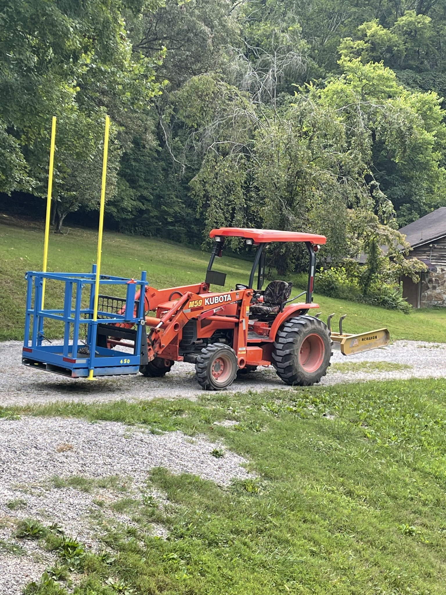

Added these safety stands when fabricating the man basket. One will hold operator up with tractor off and pressure released.
it was an idea needing to try. Admit I don’t always use them. Wife is good operator while I’m in the basket.
