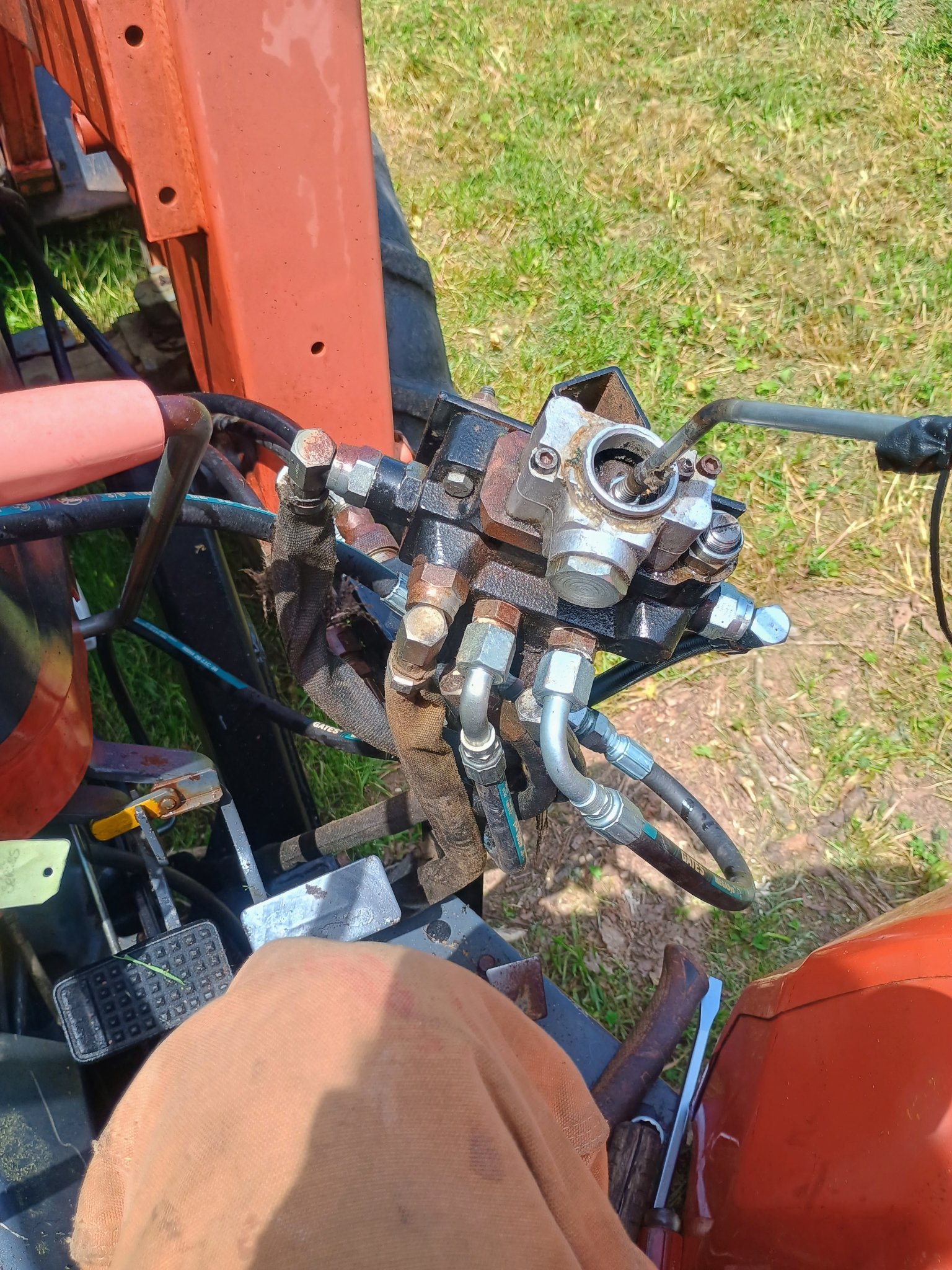

Ok, here go pics. Hope this doesn't bomb the server.
Question, in the 3rd pic what is the screw adjustment in the lug below joystick?
Bill G
9,176
4,782
Bill G
I cant quite figure out whats going on there. Looks luke a typicsl monoblock but...
How abour a picture from a little farther out showing the joystick and top side hose connections.
5,852
1,678
Try to take one from about where your right knee would be if you were sitting on the seat, looking forward at the valve. Try to be a few feet back to show the valve top to bottom, rear side of the valve.

Ok, here are more pics.
Thanks y'all.
The joy stick is wallowed out. I guess I could jb it, or cross it with another size.
I do have a TIG but my skills are limited. Thats why I was just looking into getting into a new controller. I spent so much time replacing the steering controller..
Got the busted hose replaced and loader lifts, tilt is still hinky.
Thank-you
Bill G
5,852
1,678
Easy to say...
You didn’t attach more pictures
and I will change “a few feet back” to “ as close to the three point control lever as possible”.. You might be able to stand next to the tractor and turn the camera “backwards” (like they do for selfies” and see the camera and snap the picture from the screen of the phone.
9,176
4,782
how about these
Those are much better. Replacing the valve is easy and not pargicularly expensive. But before you do that I think you need to test and adjust it to determine if its actually bad.
What we are missing right now is a picture of where the hoses attach to the tractor. In particular the long one going up over the hood and the one on the other inside of the valve.
