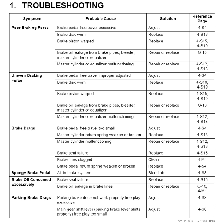

Here's the troubleshooting section for the brakes from the WSM for the M6060/M7060.

Unfortunately there's on information in the WSM for the low budget mechanical brakes that we have in our M6060 tractors. I suppose that on the bright side they're kind of basic so should be easy to troubleshoot.
