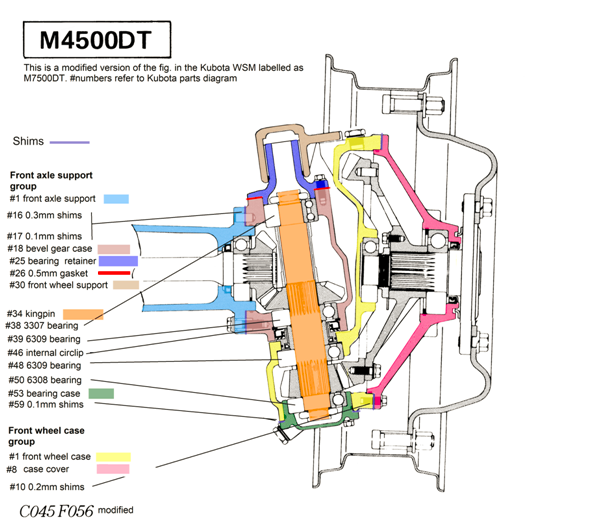

What the kingpin drive really looks like inside:
For this write-up

- Bevel gear case = BGC
- Front axle support = FAS
- Front wheel case = FWC

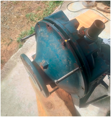

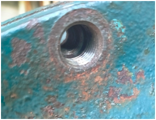

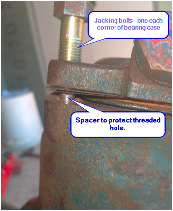

- Separate the #8 case cover from the FWC using the three long M14 jacking screws, each bearing on an M12 bolt screwed in from the opposite side.
one of 3 jacking screw holes in the case cover.
The long jacking screws can be used as handles for the case cover... - Keep a M12 bolt in place to avoid injury from the ~40kg case cover assembly dropping unexpectedly.

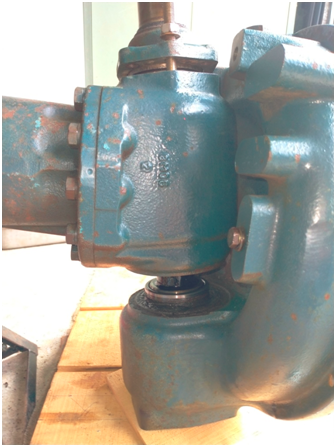

- Extract the kingpin with FWC from BGC:
- Method A: Hammer + soft drift.

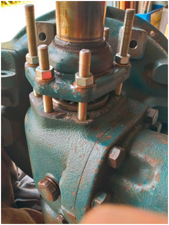

- Method B: Use #25 retainer + spacers + threaded rod to press out the kingpin, which also separates the BGC from FWC.
Neither of these methods comply with bearing dismounting best practice, so I decided to replace all 4 bearings each side.
- Remove #53 bearing case using jacking screw holes, kingpin bottom nut same way as top nut.

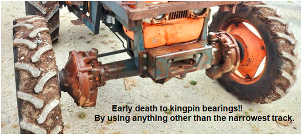

- Word on the street is that #50 lowest kingpin bearing tends to wear first, probably due to this bearing taking all the axial load, and on mine this was responsible for the iridescence in the oil. Next time I would consider replacing #50 with a 7308 angular contact bearing for extended life. What doesn’t help is users who space out the front wheels...
(NOT my tractor)

- Assemble internal stack: #41 bevel gear, #37 collar, #38 bearing. Fit to FAS. Add and torque bearing retainer. . Important: #26 gasket thickness (0.5mm OEM) affects backlash.

- 0.10 mm shim change ≈ 0.085 mm backlash change.

- 0.20 mm shim change ≈ 0.14 mm backlash change.
