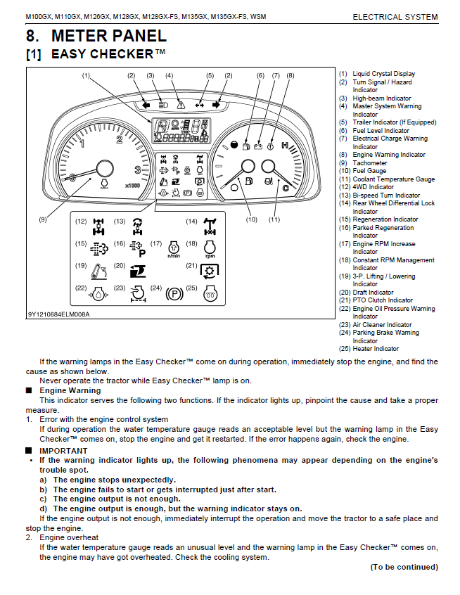

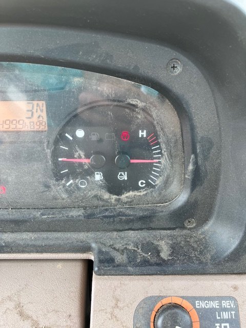

I have a 2013 M110X. While haying, I periodically get the engine warning light. It will be on for maybe 2 minutes then turn off. Sometimes it will be off for 10 minutes, sometimes an hour. It does not turn on when using with the loader. No real pattern other than that. Since it is not on constantly and Kubota does not store lots of engine data, the dealer has struggled in the past with diagnostics. Short of putting the mechanic to work bailing so he can get data when the code is on, any suggestions on how I can diagnose this? It is a bit different than the OBII system on my pickup but with the right tools, it seems similar. Any recommendations on what to check or how to diagnose? Thanks in advance.
