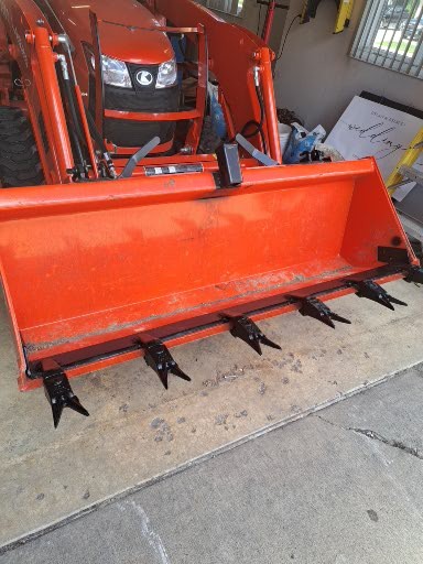

I have that same 60" so called light material bucket on my LX4020. I added a bxpanded piranha tooth bar to it and it is plenty strong digging and carrying a full load of stone or dirt. The LA545 loader on my tractor has only a very slightly higher lift capacity than your LA535 loader so I would not worry about that if you go with the 60" bucket, as long as you have loaded tires and a good counter weight on the 3 point. However the piranha tooth bar does greatly reinforce the bucket cutting edge so I can't comment on how well the original cutting edge would hold up on its own.
