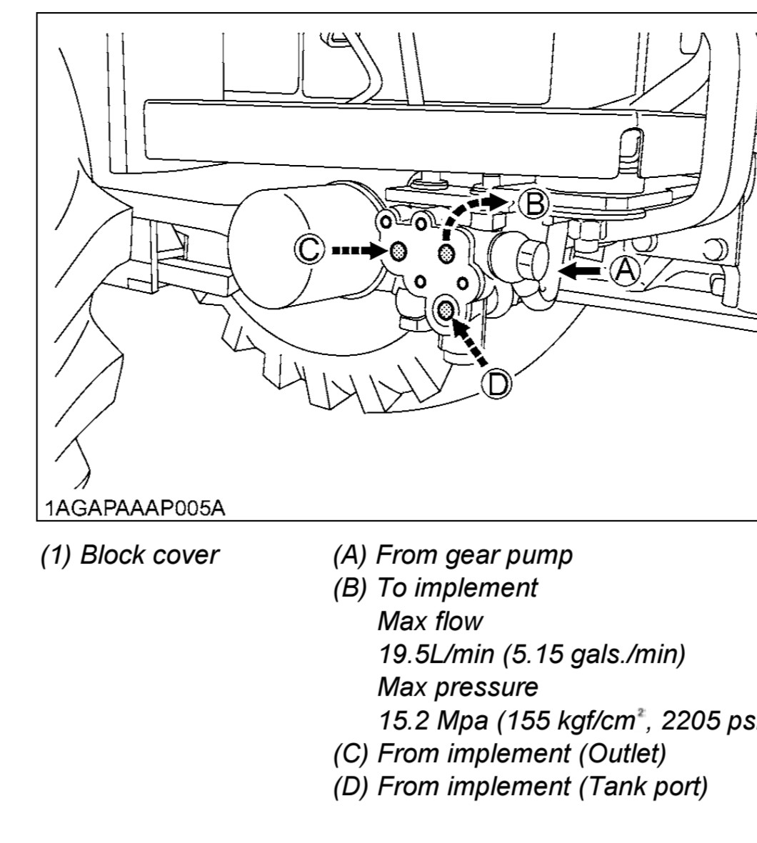

Hard to screw that up. There are only two hoses:
You completly remove the loader power beyond hose. Thats the upper left hose on the outlet block below the right floorboard - port C in this diagram.
You then connect the power beyond port on the loader valve to the IN port on the 3rd functiom valve using the new hose that comes with the kit.
Lastly you connect the T port on the 3rd function valve to the upper left port (C) on the hydraulic outlet block using the new hose that comes wiith the kit.
