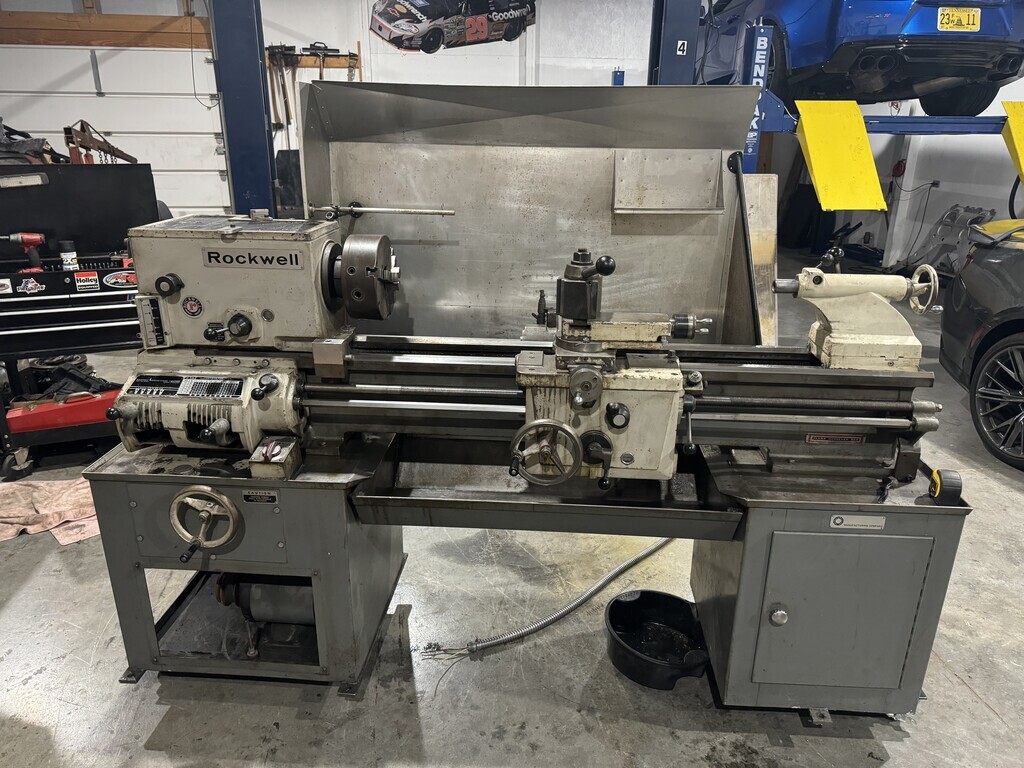

In 2003 I bought my 14" Rockwell in Pittsburg for $800. Very similar to the Clausing and at the time Pittsburg was loaded with this sort of old iron. Thats not the case around here and folks who favor these machines think they are worth 3X that if not more. Its all about location.
I just helped a guy on the Rockwell forum get his new 14" wired and running. He paid $2500 for it and thought he got a deal. Not exactly pristine....

I would look up lathes under completed listings on eBay to get an idea how these are valued. I have been to many machinery shop auctions here in Pittsburgh over the last decade and there is often very little demand for this type of stuff . That lathe would have sold for maybe $1,000. Don't be afraid to make a low offer. Good luck.
Good idea.
I did as you suggested and it appears that its not a bad deal, I'm not "stealing it" but I would not be getting "shafted" either.
Unfortunately "negotiating" is a skill set that I do not excel in. As a matter of fact, I kinda suck at it.
If someone tells me a price, and I think its fair, I buy it. If I don't think it's fair I just say "thanks" and walk away. I have made counter offers on some things, but in general I hate having to do it. Although I admit, making offers electronically is easier.
I wish I was better at it in person.
Basically if it goes through, I will have gotten a "fair deal" I believe.
