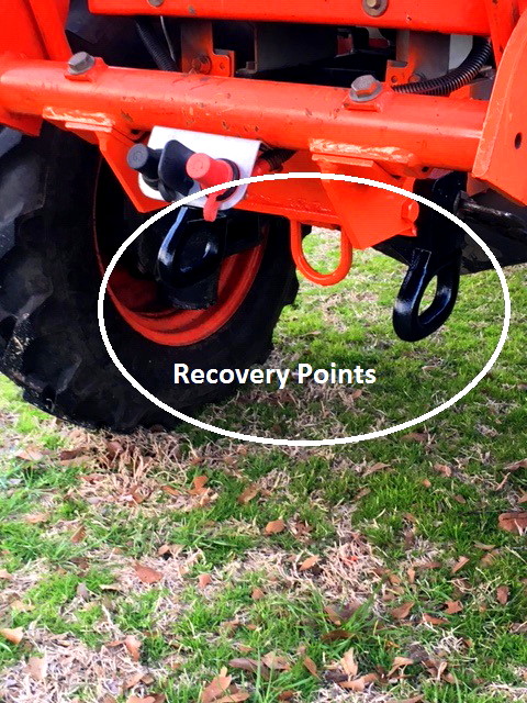

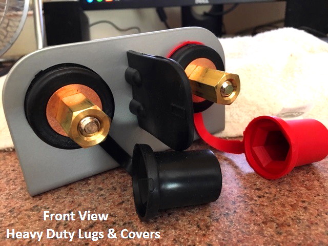

Similar to the OP....accessing the battery on my tractor is something less than convenient. While I keep my battery charged and in good shape.... should I ever need to 'jump' it, I wanted that procedure to be a bit easier.
To that end....I simply added remote jumper posts to a spot on the front of the tractor where I can get to it, but it is not easily damaged by brush/objects.

Is that something that you made up or is it commercially available? If it was purchased, where did you get it from?

intersting jumper block , clicked on the link ,NO mention of current capacity or voltage rating, at least not that I could see. Does anyone have those specs ?? Really is it important. While they 'look beefy', might only be good for 100-125 amps ??
I know Anderson Powerpole have specs....
8,195
4,125
Jeeez....
Its a 3/8" threaded brass stud on one end of an even larger jump post - big as or bigger than those on most starters and its sold for 12v cars and trucks.
11,046
4,700
3/8" spec isn't on the website page, someone posted that in another post.
Sure a 3/8" stud should handle 400 amps, but my comment is that the 'specs' should be on the datasheet.
