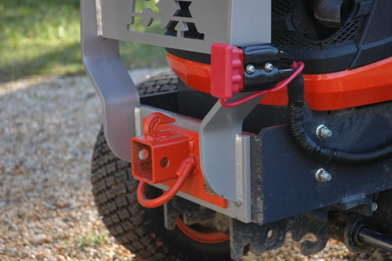

Serves multiple purposes. I can jump the tractor or I can jump a car or the genset from from the tractor.
I took a set of good jumper cables, cut them and installed matching Andersen connectors. The cable can act as regular jumpers being I put a connector on each end.
I put the same connector on my 3,000 watt AC 120V inverter and of course, the winch.
