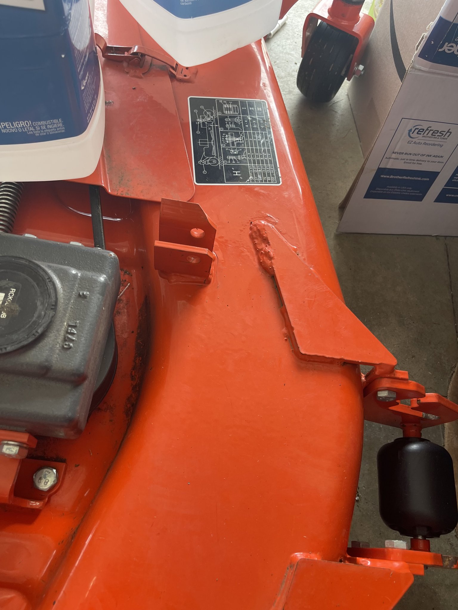

I'm running an LX2610 with an rck60-30bb mid mount mower deck. I want to be able to use a 3 point hitch land plane but can't figure out how to lock the mower deck in the raised position. The manual only references loader arms for this situation and my lx doesn't have a loader installed. Thanks

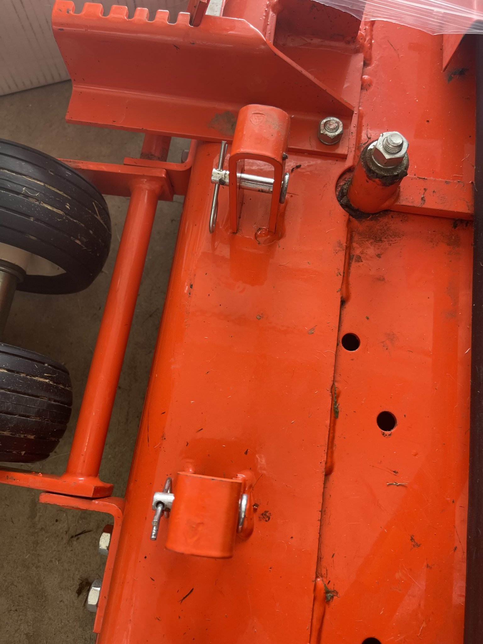

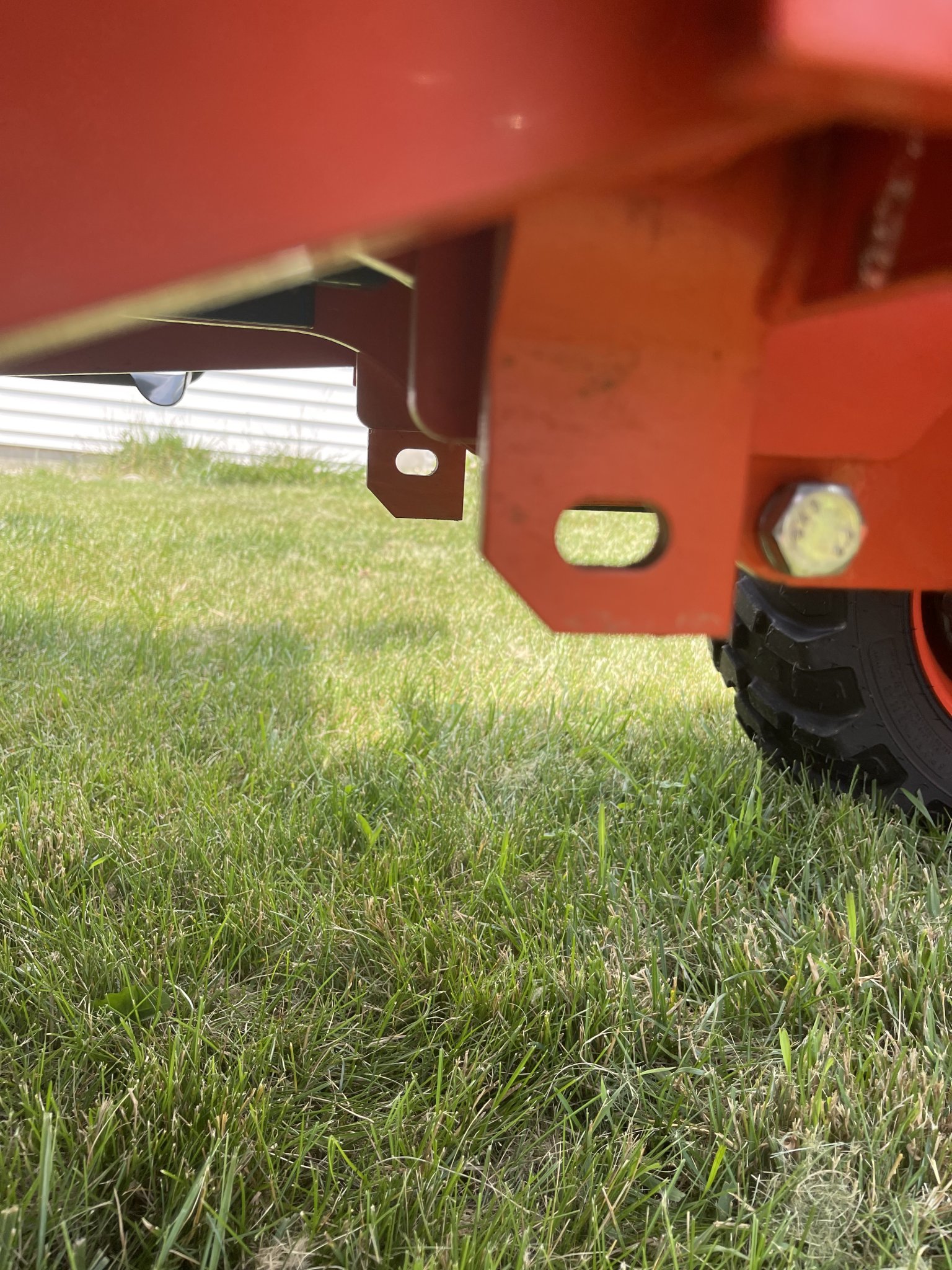

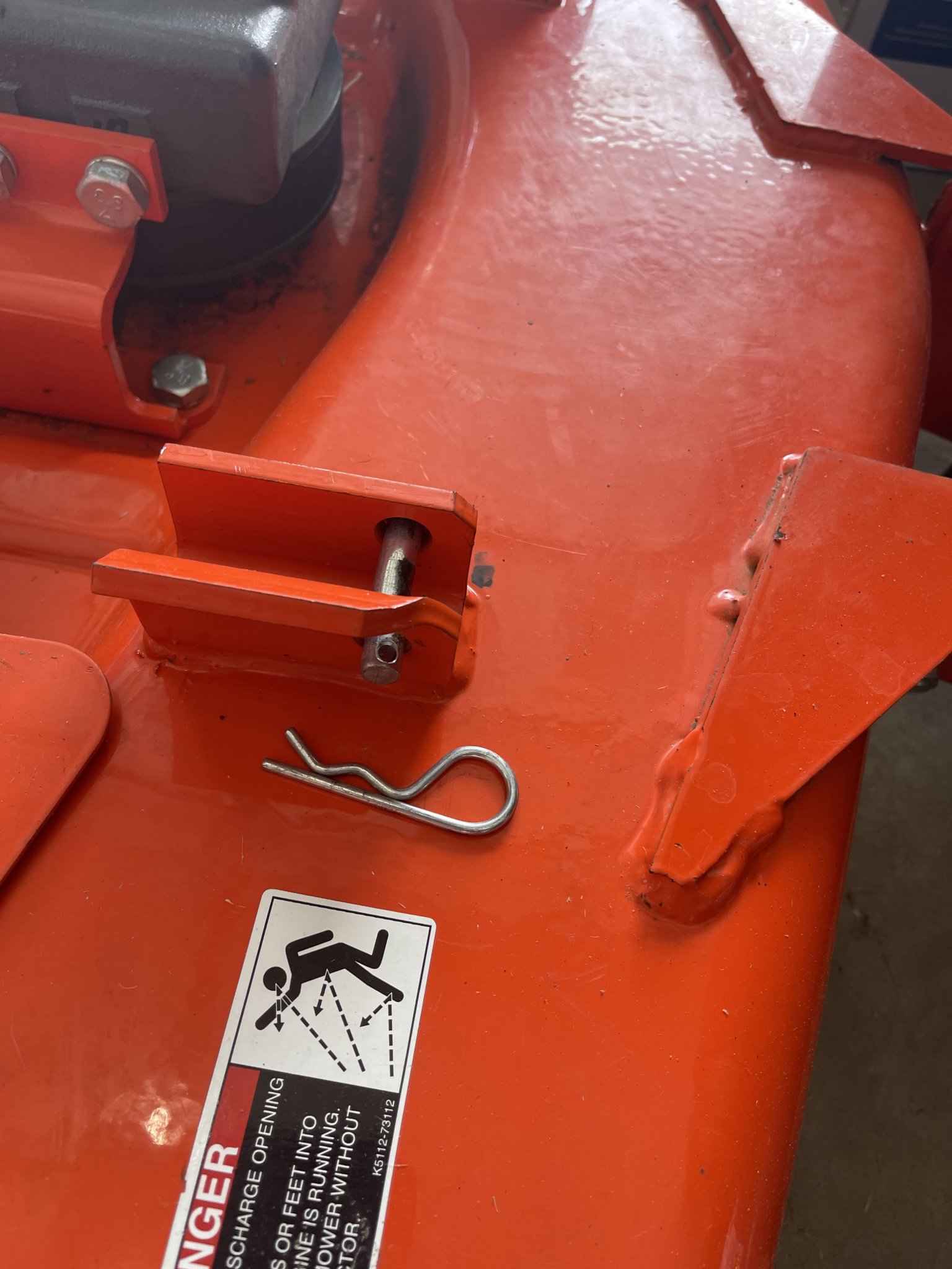

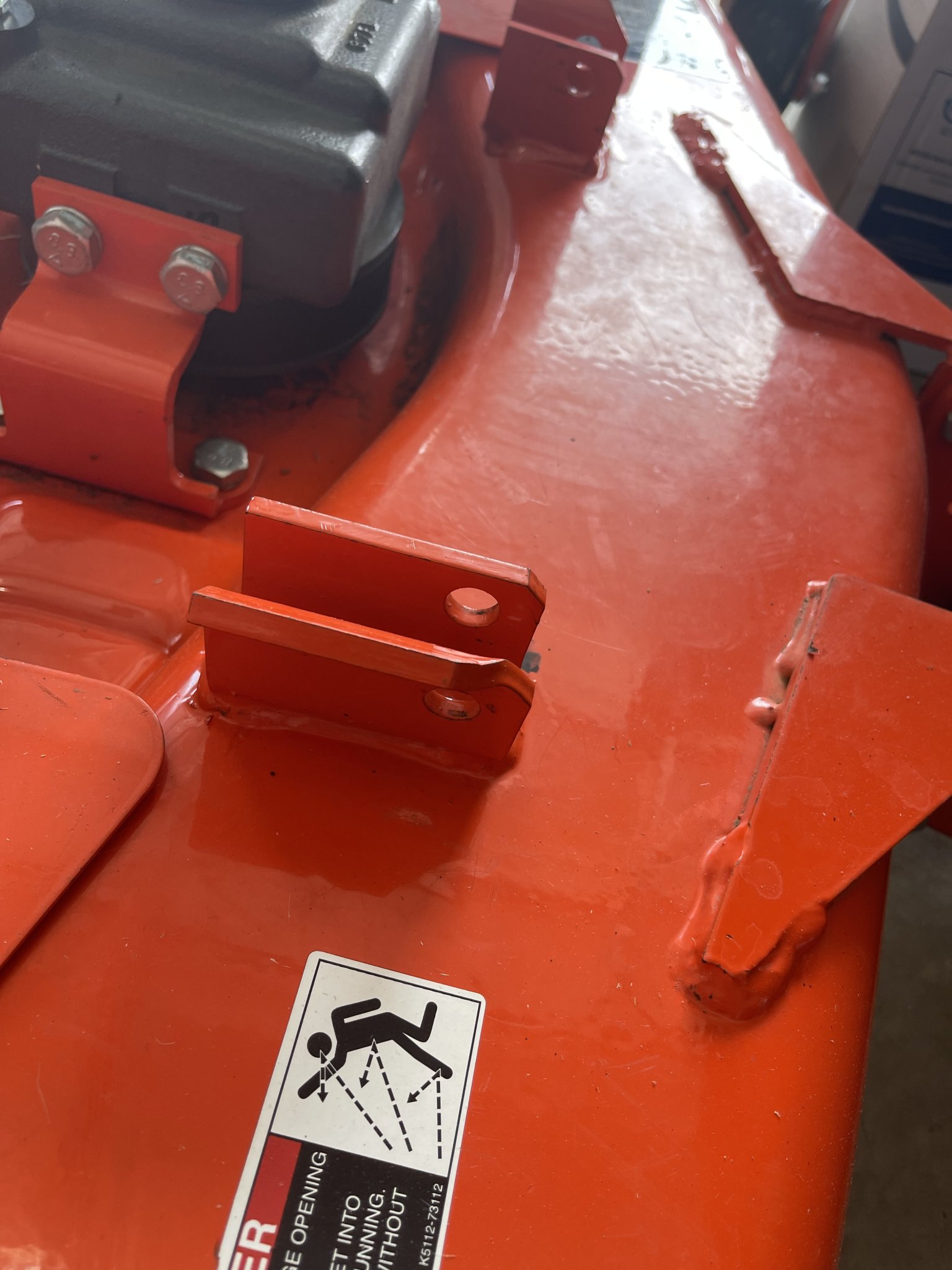

You should have two pins for stowing the deck up. Some dealers install them on the rear of the mmm deck (see pictures) and some store them as loose h/w in your storage bin. Pictures show were pins fit on mmm front and where they go on an LX2610. Hope this helps.
