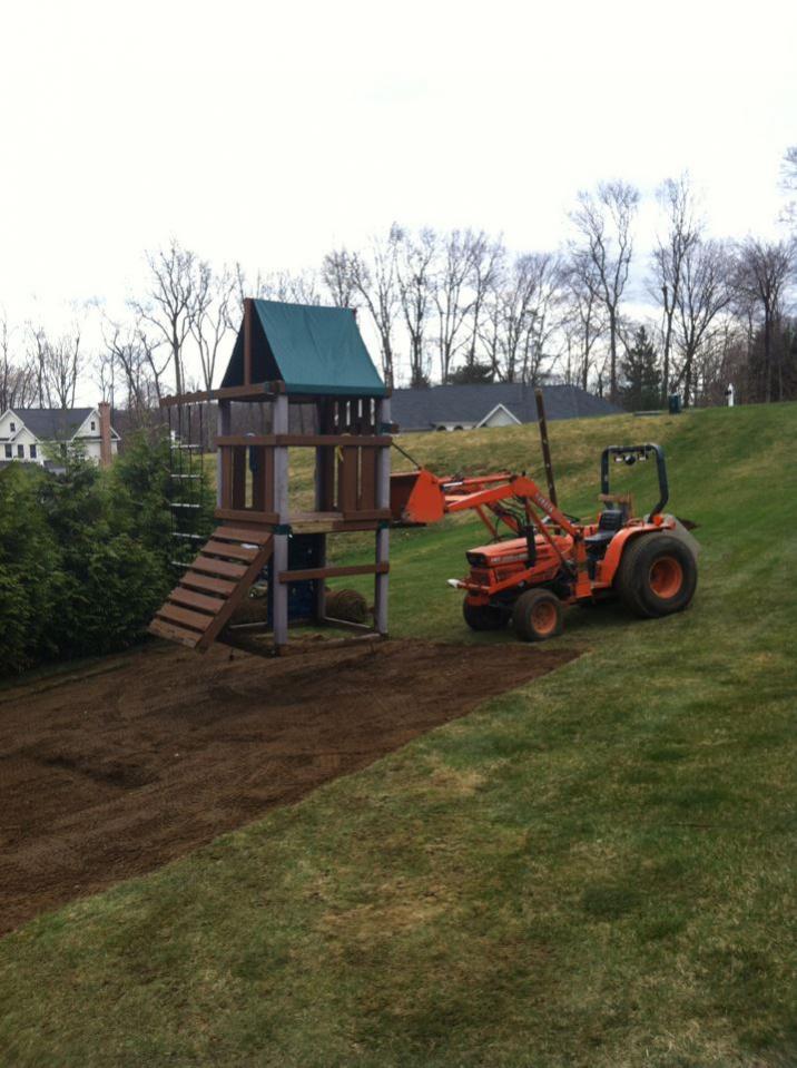

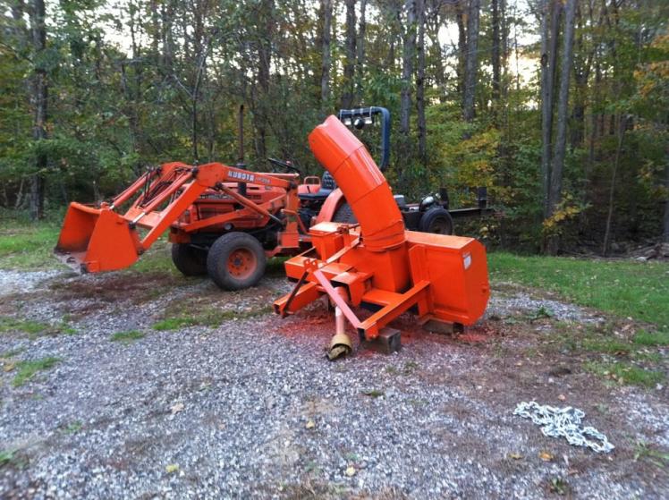

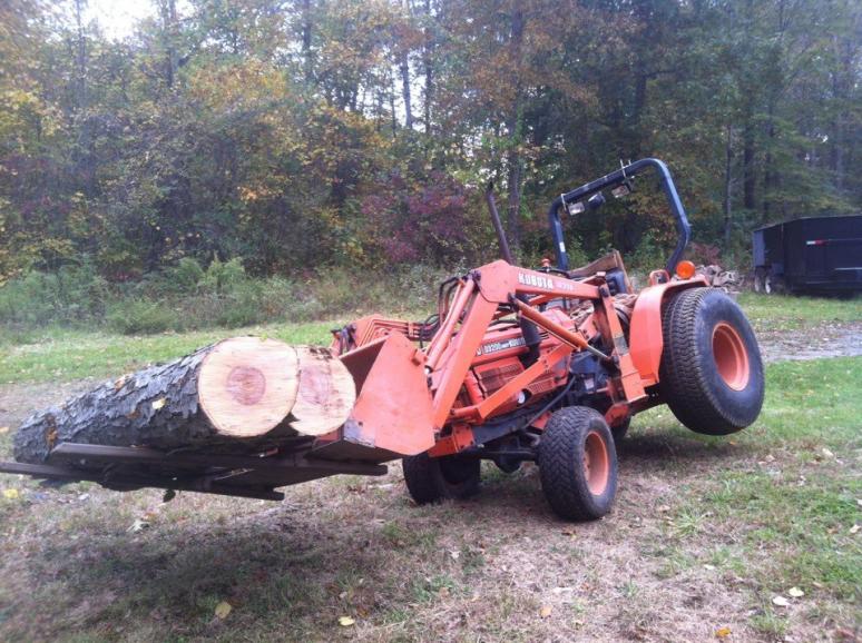

I have a B9200 with the factory BF350 loader and I love it. With a concrete counterweight I can lift over 800lbs (approx 2-3') and have had much more on my forks with a little finagling.
