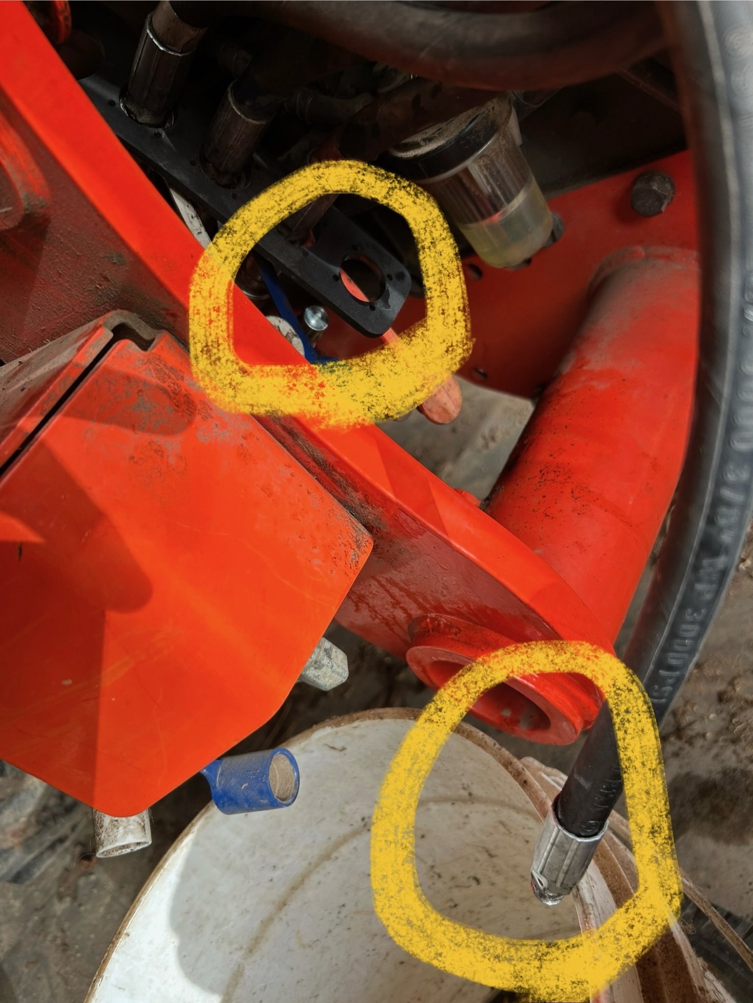

Thanks folks! @TheOldHokie I tried what you described.
First I confirmed that the problem persists even when the 3ph at the lowest position.
Then I disconnected the yellow coupler, removed coupler from hose, put the hose in a bucket (see photo - I think I'm doing what you described) and started it up to try again. After removing the coupler a small amount of oil came out (did not seem like a full hose's worth - much less).
With the yellow coupler disconnected, there's no upward lift on the arms now.
What does that point to? Could this point to a collapsed return hose, as @torch suggested?

Looks like I got the wrong coupler. Yellow must be the UP side. Put that one back togeter and repeat the test using the other coupler/hose.
