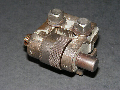

On this old craftsman it doesn't have a carriage stop so when I'm turning and get close to the end, nothing stopping it and no way to know where to stop.
Search for micrometer carriage stop, there are numerous ones available.

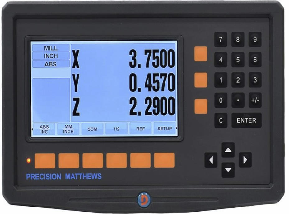

I put one of these DRO PROs ones on my lathe. It is a 'cheap' Chinese model, but has been fine for the 5 or 6 years it's been installed.
Your installation is what really matters. Properly done, these really aren't just a 'bolt-on' item. I needed to fab brackets and shields. I wanted the scales mounted securely, protected from chips and (for the carriage one) mounted in a way that didn't impinge on the travel at all. And I wanted the display mounted 'just so', requiring me to fab an arm and mount for it as well.
Putting a scale on the tailstock seems like WAY more bother than it'd be worth. If I need to drill to a precise depth, I'd just put a chuck on the toolpost and use the carriage...
My mill has an old Sony DRO - super nice, and it's been perfectly reliable for 15 yrs or more. It also has mag scales. I wanted a matching model for the lathe, but couldn't find one at a price I could justify...
