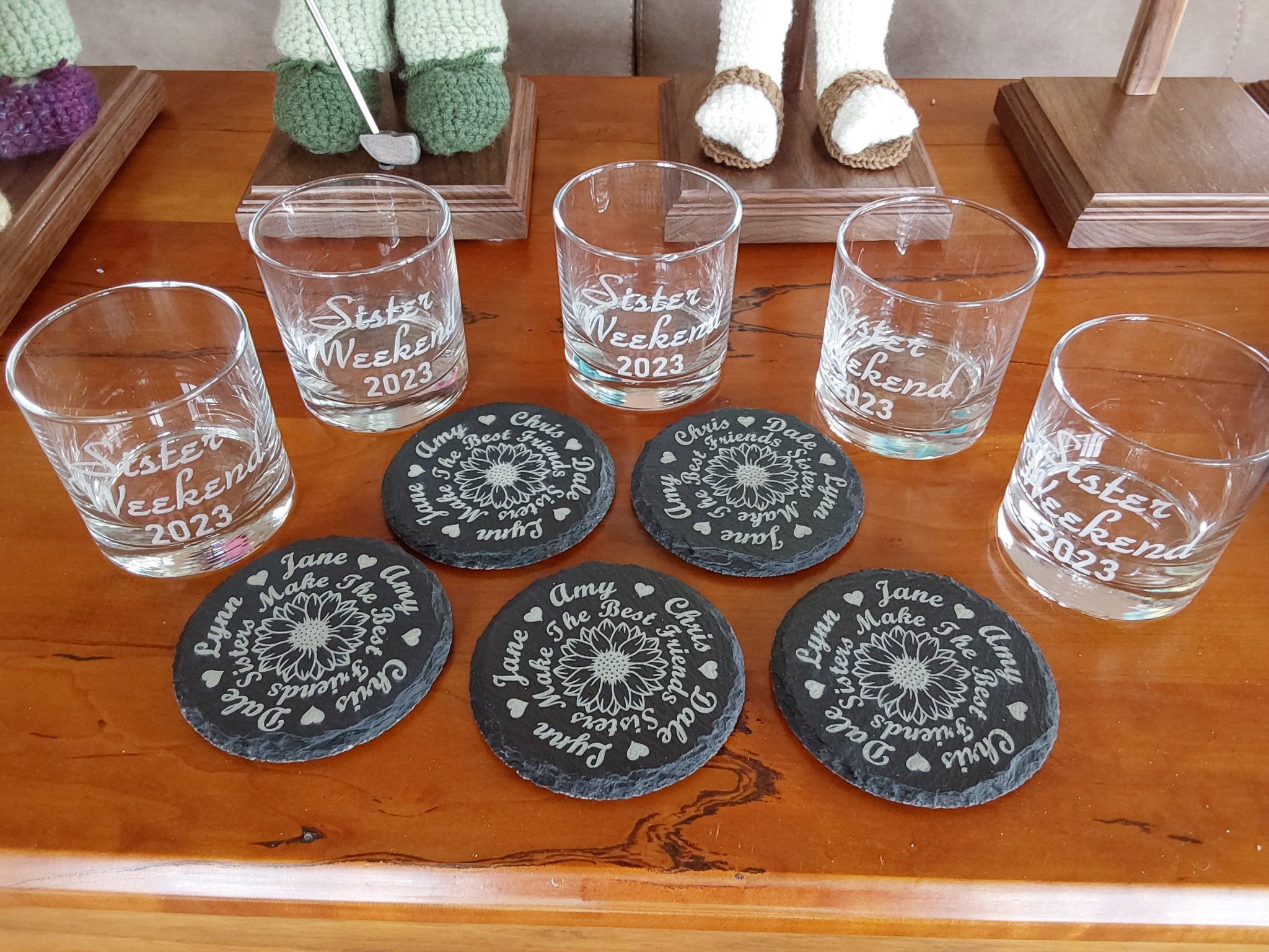

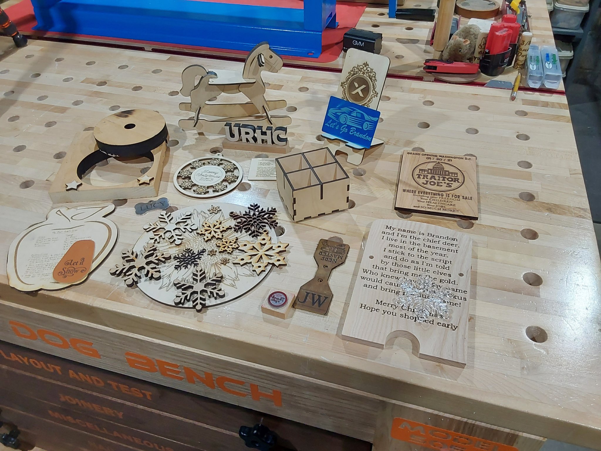

I have been through many different diode and a couple Co2 machines. The most important part is having an enclosed one with really good ventilation. They vaporize the material and you don't want to breathe the resulting smoke. Simple cheap diode lasers are a good way to get started for things like cutting and engraving on wood, stone, and leather. Step up to a Co2 for things like plastics, glass, and marking some metals. Then a fiber laser will get fast precision marking on metals. A UV fiber machine will give amazing results with just about anything. I have about 60 videos about different machines on my youtube channel, let me know what you're looking to do and maybe I can give you some ideas of the type of machine that would work. Here's a couple of pics of my projects

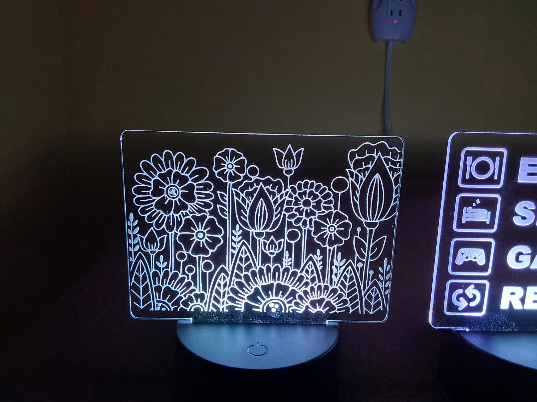

For some plastics and clear materials a diode laser wavelength just passes through a Co2 machines is required. Higher power and faster then diode machines but the result is a wider beam that can result in lower quality engravings. Here's a popular gift I make with a Co2 machine.

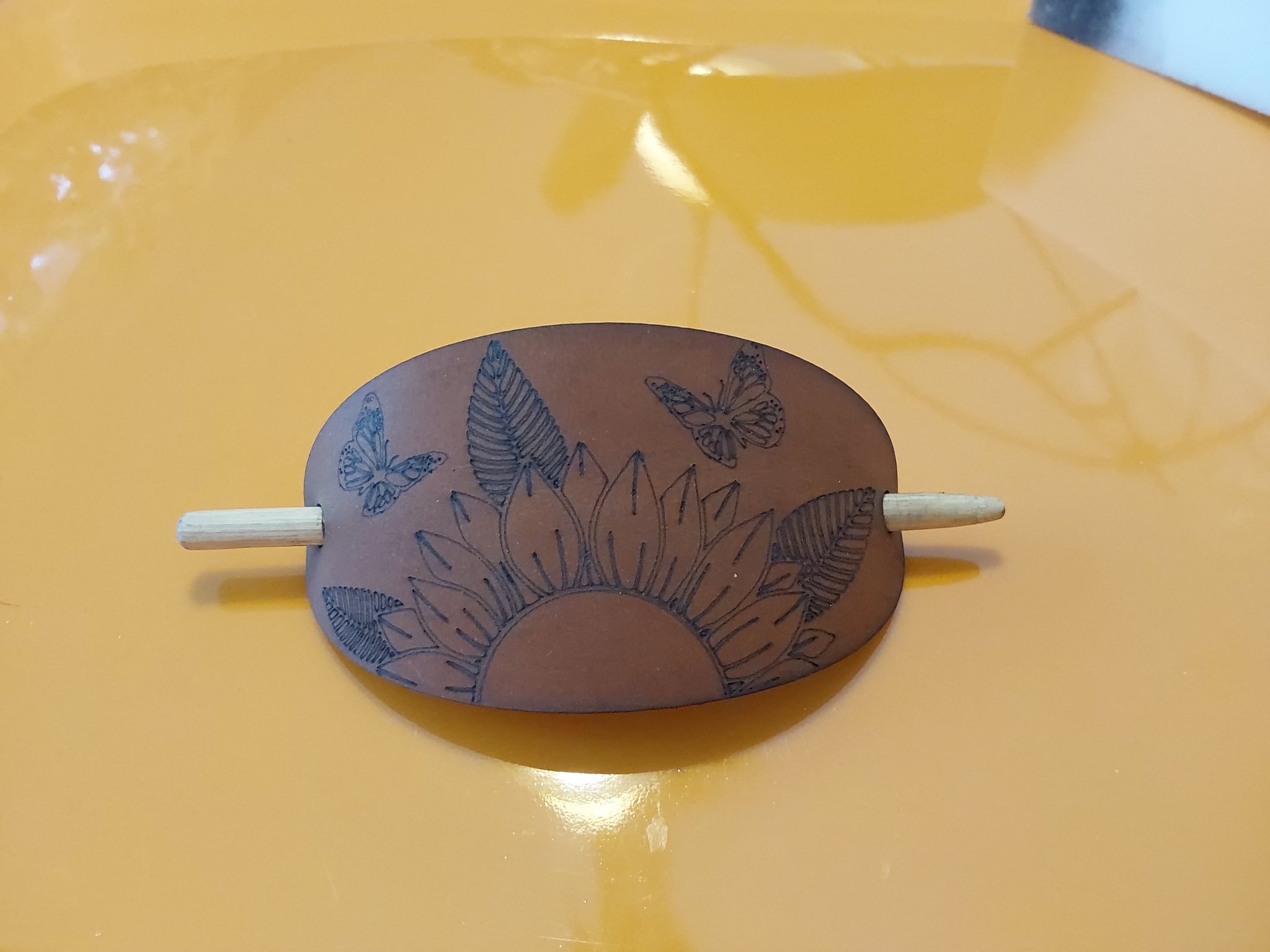

For leather either will work but a co2 results in less cleanup of soot in the end I find. Here's a video of some glass engraving and leather at the end. Skip through the beginning if you're not interested in some of the setup required.

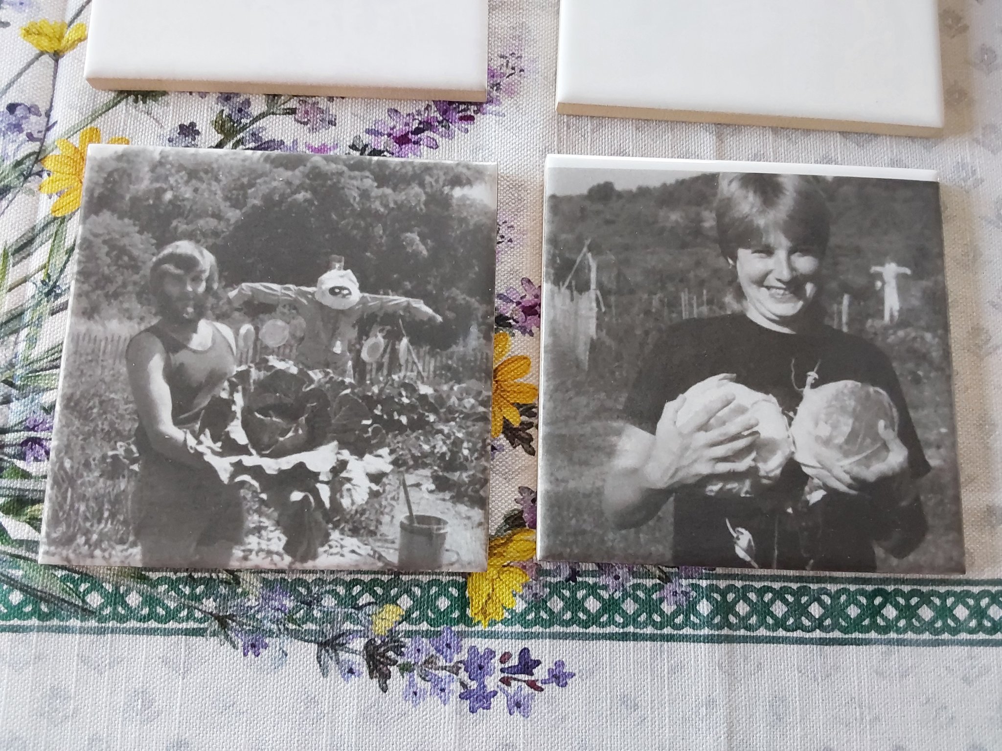

Here's some old photos of us a friend just did for me on ceramic tiles using a new UV fiber laser
