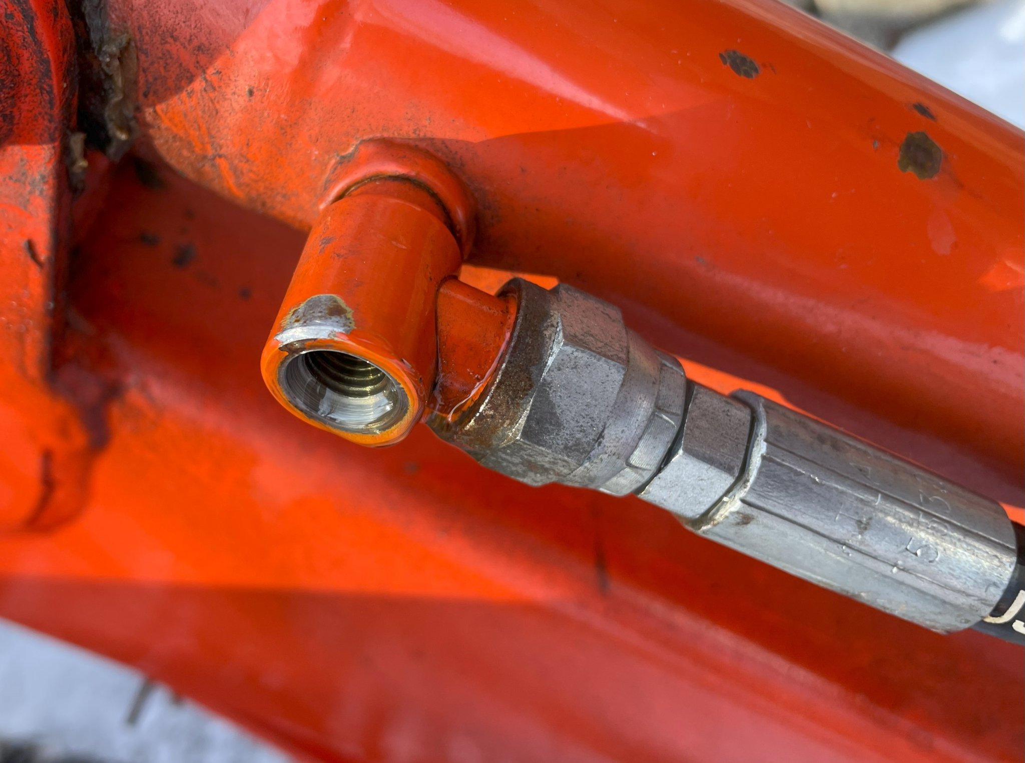

A aauclair56 New member Equipment Kubota B7510 with LA302 Loader and RCK54-24B mower Jun 4, 2024 2 0 1 Vermont Today at 9:53 AM #1 I noticed some fluid coming from my bucket cylinder upper fitting. It looks like an ORB style fitting. Has anyone serviced these fittings before. I am wondering if the Oring is damaged. Can the fitting be repaired easily?

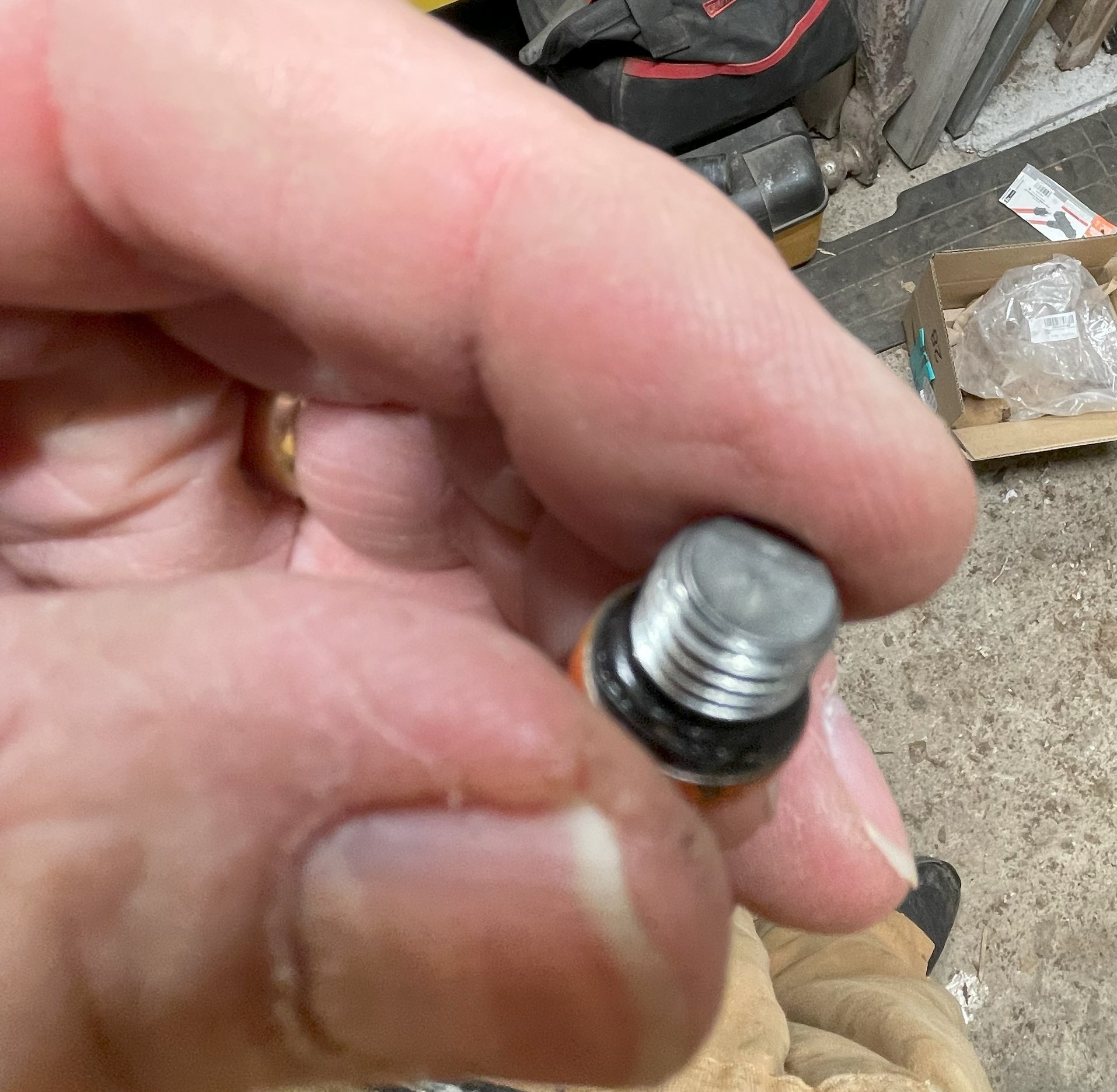

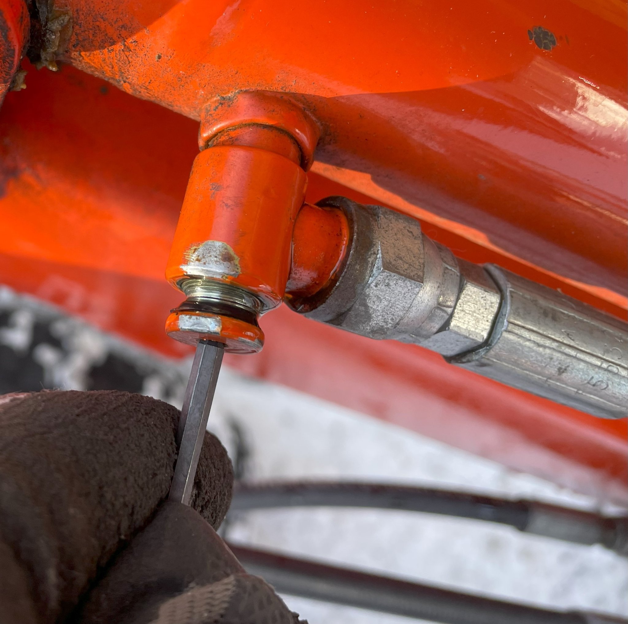

North Idaho Wolfman Moderator Staff member Lifetime Member Equipment L3450DT-GST, Woods FEL, B7100 HSD, FEL, 60" SB, 743 Bobcat with V2203, and more Jun 9, 2013 31,781 7,578 113 Sandpoint, ID Today at 11:31 AM #2 On the older model cylinder, that's just a plug and seal (upper pic). But on the newer cylinders they don't show it, it could be a plug or could be a banjo bolt. (lower pic) Pull it and see which it is. If a plug new seal and pipe thread dope will seal it up. If it's a banjo bolt new seals and tighten. Last edited: Today at 11:36 AM
