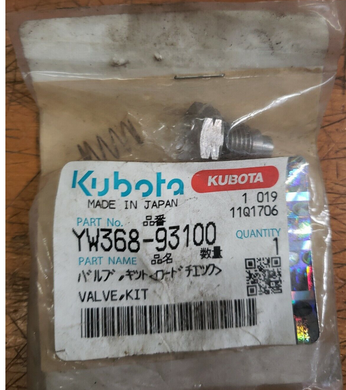

I get one thing fixed with Dan's help then find another problem. Now pulling back the joystick to raise the FEL causes it to drop unless it's pulled back quickly. I don't see how this is relevant but I did add a WR Long C-Flow kit in order to use my new Lane Shark front end mower. Lane Shark works as it should but after using it for a few hours the problem started with the FEL arms dropping before raising. How can this happen?
