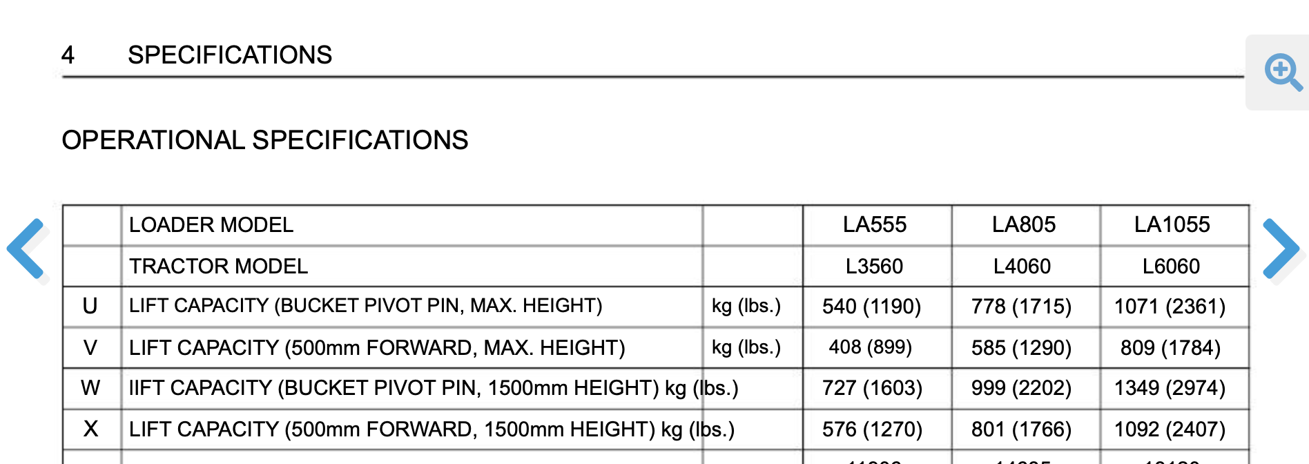

I’m wanting to purchase a L6060 HSTC but I have had one question that I have asked many dealers that they just can not seem to answer and it is a deal breaker for me. My simple question is: will this 1055 ‘Loader’ lift a 48”x48” typical pallet that weighs 2000# ( I only need to lift these 5’). I will have the tires loaded with rimguard and have 600#’s of wheel weights but I’ll also have a 1250# hydraulic box blade on the 3 pt! I need to know if the the loader will lift this smoothly and without max rpm’s. This won’t be done real often but when I need it I need it.

Your problem is not RPM or ballast. According to Kubota:
Max lift at pivot pins is 2361 lb
Max lift 20" forward is 1784 lb
So I would say chances of lifting a 2000 lb pallet to 5' are slim to none.

Good day. Welcome (almost congratulations on purchase…almost😉). The pic below is for a 2021 line up brochure. I don’t believe this answers the whole question….it might get you close. I think what is missing is weight out away from the pivot pin. If it is a must criteria then id want to know for sure before purchase. Do you have access to the loaded pallets and a trailer? If want to be absolutely sure, haul it to the dealer and ask them lift it off your trailer. Or if at you place ask them to bring the machine out and show you they can lift it…if it does they can leave it there. Is there any reason not to consider an M…bit more SWLL with an M. Good luck 🥃

"Max lift at pivot pins is 2361 lb
Max lift 20" forward is 1784 lb"
Plus , if not mistaken, would have to deduct the weight of the pallet forks and SSQA from those stated capacities?

It's at or close to either side of the limits!
Yes Sir I agree about the ballasts and have gone over the specs a ridiculous amount of times. When I ask about it the first thing they say is well( your going to need more ballasts if you do) lol! I understand it is beyond the specs so I’m guessing that’s why no one will answer my question. Thanks for your help Sir.

You can get hold of the loader curve. It's a graph that tells you how much weight to what height. 5 foot is less than max height of 112 inches nearly 10 foot), so it will lift a bit more weight than the spec says if you're only going to 5 foot. 1,784lb (spec lift) is not that much less than 2,000lb. If you really meant 1,900lb, then you'd be close. But yeah, deduct SSQA and forks, you're probably pushing things. So I guess the real question is whether you mean 2,000lbs, or actually 2,100 with pallet, or actually 1,900 and you rounded up.
And, if you didn't need to go to 5 foot, then 3ph forks would lift that easily (2,600lbs at 24 inch behind). Depending on where you're trying to put something, can you build a 3 foot loading ramp, and 2 foot lift on the 3ph?
