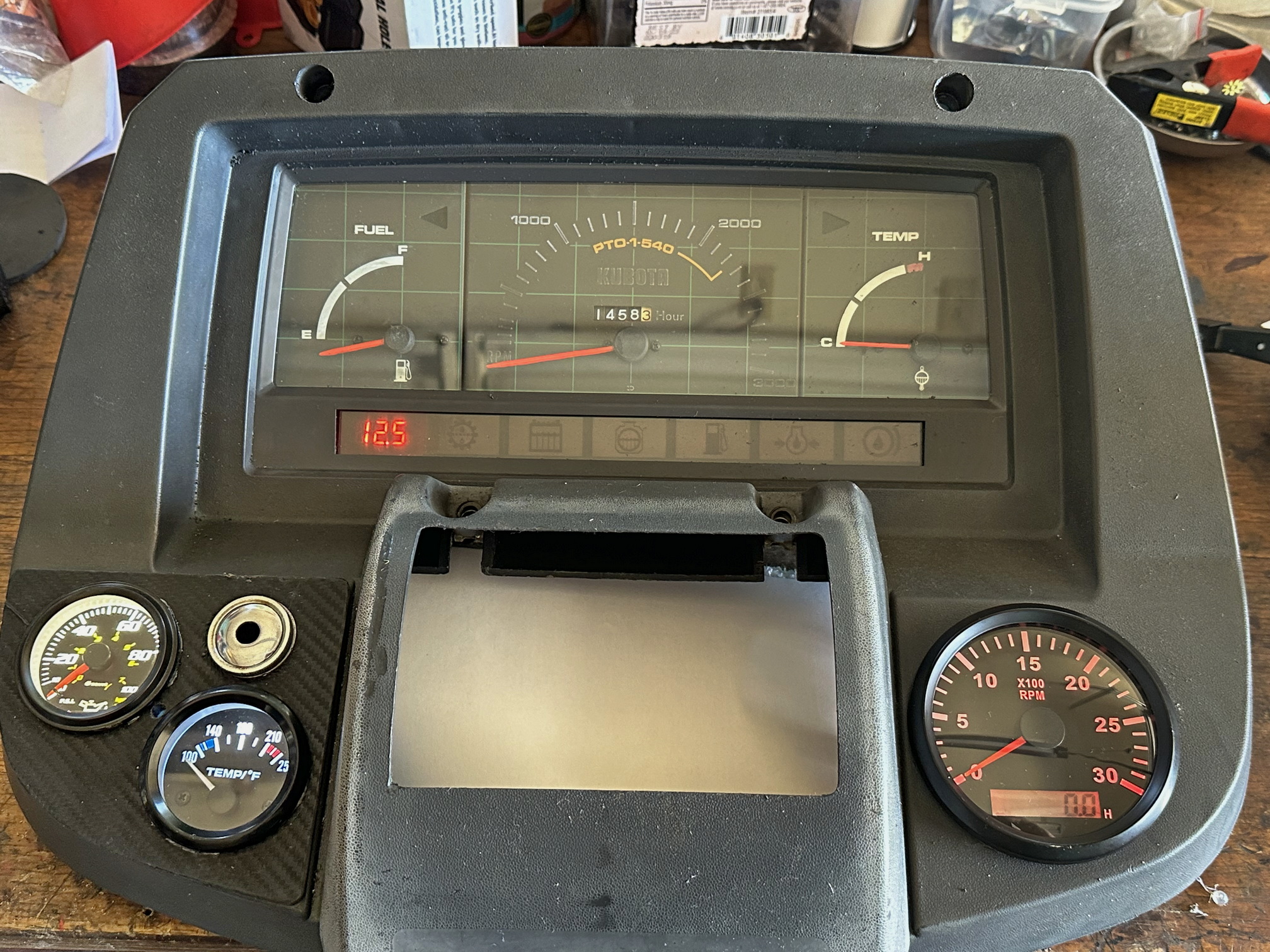

Thanks Mark_BXD25. I would love to get all the original gauges on the dash working but it doesn't seem realistic. Since the tach is mechanical, it has to be the head unit. I can't find on on the web.
Both the fuel and temp gauges don't work properly and I've run the diagnostics in the repair manual - they both show defective readings. Again I can't find them anywhere. I wonder if anyone has tried changing the resistor on these gauges when they are out of spec?
I've attached pics of the new gauges and rear panel gauge wiring. Note I took the advice on this forum and added the voltmeter. Also, I fixed all my orig. gauge needles using toothpicks. Just drilled small holes and superglued - then painted them.
