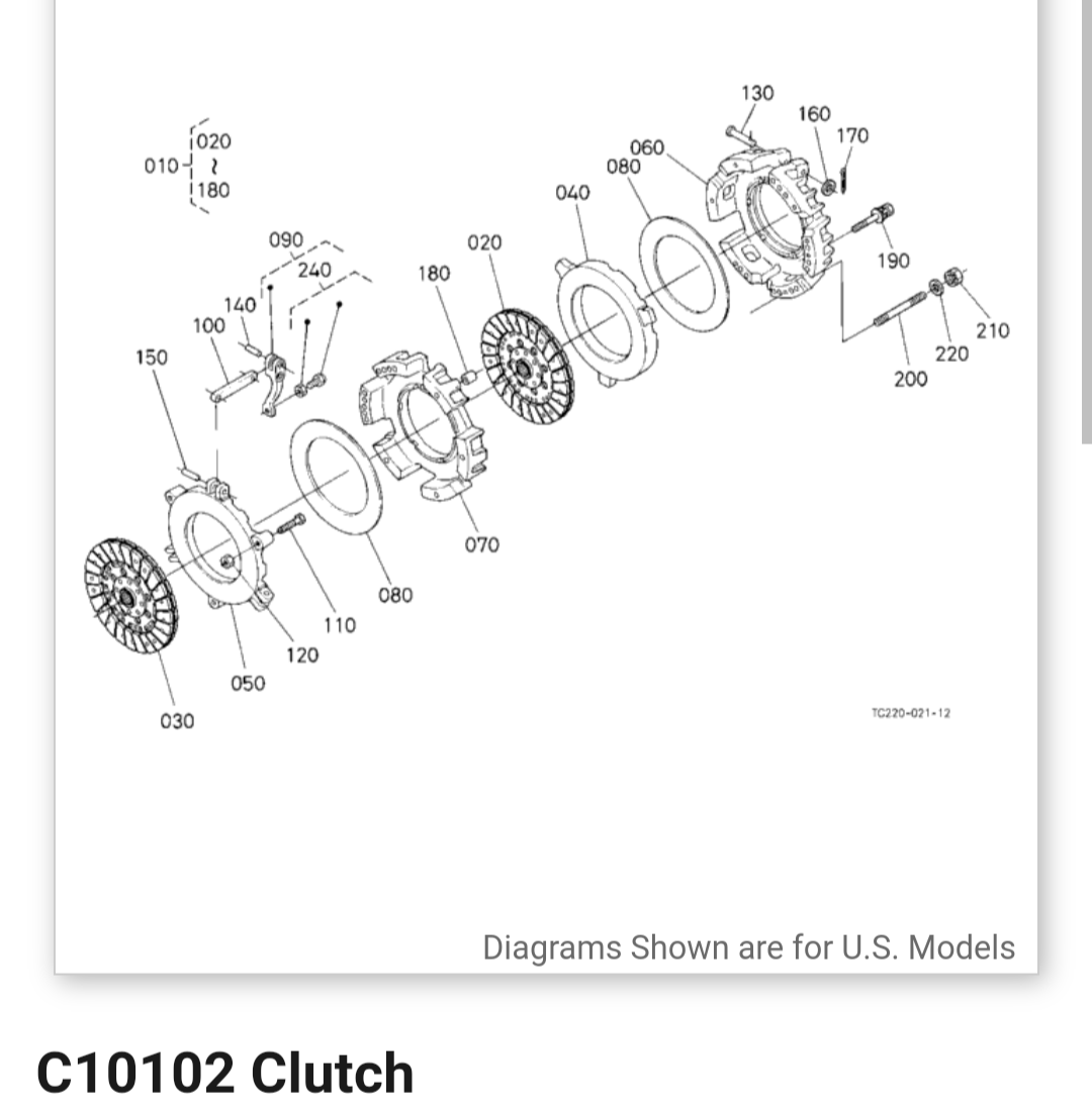

I have to swap the clutch on my L3901Dt(manual). It is a dual clutch. Apparently this tractor comes with both a 10.25 and 10.5 bolt pattern on the clutch?
Does anyone know the bolt pattern distance? The clutch kit part# is C10102. This is directly from the dealer but they do not know either. I am 3 hours from a dealer so I want to get it right on the first swing.
Anyone have one around to measure?

I only see one clutch assembly for an L3901DT on Messick's parts. What part numbers does the dealer have?

C10102 is the group part number from the dealer. I have the schematics but no bolt pattern is shown.
That's the diagram # for the Clutch group. If there were variations, say for serial # breaks, there would be duplicate part numbers for item tag numbers on the diagram. There aren't any duplicates on the parts list. Which parts do you need?
