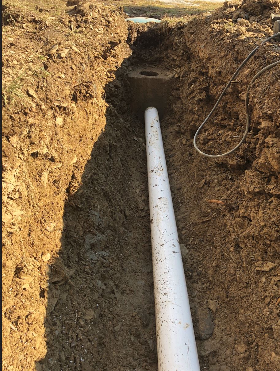

Well, I guess I differ than most. I wouldn't be afraid to drive over a leach field. Have done so many times with much heavier equipment. Fla seems like many standard septic leach fields are done predominantly in sand and many of the new one's use the plastic dome tunnels (not pvc pipe). Likely down 2 feet or so because of high water table.
Driving over tanks/lids - I like seeing 18 - 24" of cover to do that.
For this one, I was actually sitting on the tank to dig the line for repair.
Yu can see here how shallow the tank was.
If OP is really curious, get yourself a soil probe and do some poking. You'll feel how deep it is.
