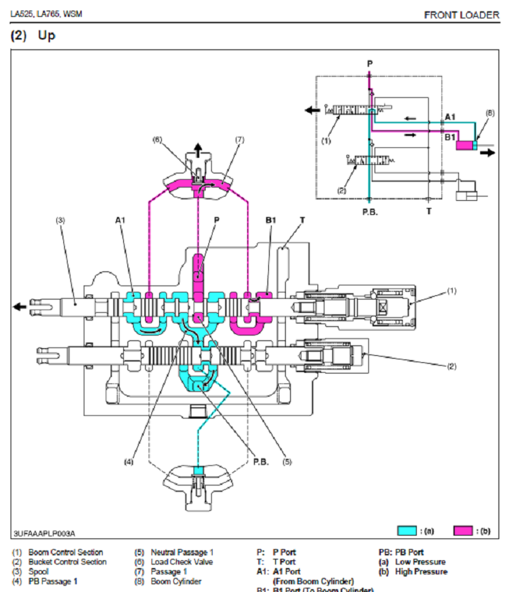

The 3pt functions when the loader is being raised. In other words the loader is getting power from the tractor but the 3pt only gets power from the loader when the boom spool is shifted.
Q: Whats special about the boom spool?
A: Exhaust oul from the loader lift cylinders goes out the power beyond connection to the 3pt.
I will bet operating the bucket does not get the same result as the boom.....

I assembled a LOT of those.
L3400/LA463, even the newer LA525 loaders-the system is the same design.
If you swap the power beyond and return hoses on the hydraulic block OR the loader valve, you will get exactly what you describe, and for exactly the reasons stated above.
Is it possible that the loader hoses have been removed or swapped for some reason?
The two hoses that were frequently swapped at the hydraulic block on the tractor (below the right side floorboard) both had the same ends on them, so easy to screw them up. The other hose has a different end.
What you are describing is "conventional" valve behavior. I could not find a WSM and I cannot speak for the older LA463. It may well behave that way. If so the curl function should also cause the 3pt to lift.
But the valve on the LA525/LA765 is not conventional and would not behave like that if PB and tank return are reversed. The LA525 sends boom exhaust oil to the power beyond port not tank. Operating the loader lift would send all oil to tank bypassing the 3pt entirely. Hence my earlier comments.
You are correct operating the bucket has no effect on the 3 point
Do you have the WSM for the loader? Knowing exactly how rhe boom circuit works would be helpful in diagnosing the problem. Based on your testing it appears to he the same as the valve on the LA525. Assuming it is I am still having trouble visualizing how PB could be blocked in this fashion. Are there any hydraulic valces other than the loader on the tractor? Third function, rear remotes, etc?
Are you familiar with the hose connections at the hydraulic outlet block? Assuming no other valves in the circuif if you disconnect the loader valve tank return hose at the outlet block and start the tractor there should be no flow coming out of that hose. If there is an oil flow coming out that line something is FUBARed inside the valve.
