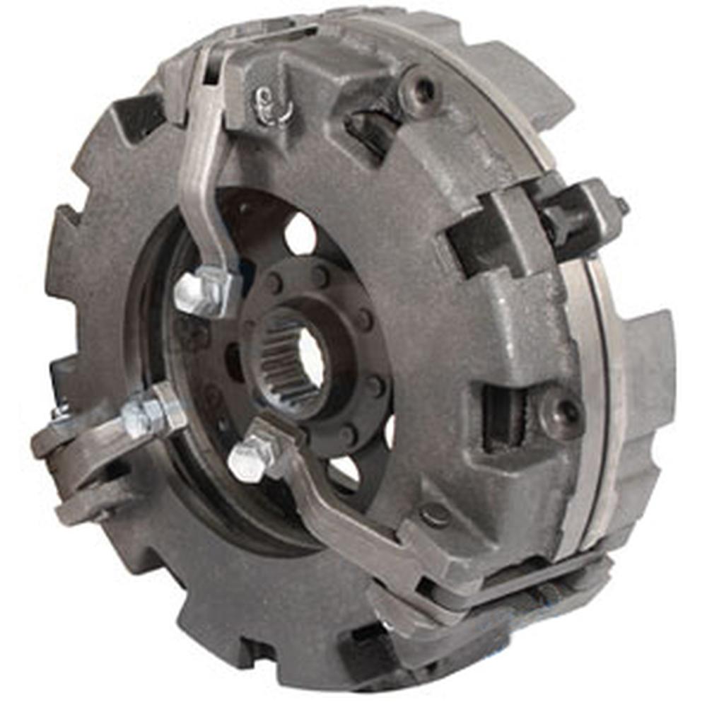

I found the below image online and was curious if it would work.
I assume you have a manual/gear transmission since the HST has an independent PTO... Short answer, sorry, no. BUT you can use an over-run PTO coupler... which might help you some. It doesn't allow a mower to transmit power back through the transmission.

I don't know for sure... but pretty sure the L2800 is single stage clutch... even though I found several places selling L2800 duel clutches!!!
