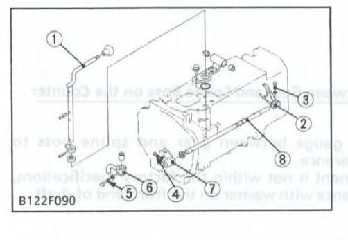

yes I have that picture but what I need to know is in order to replace the bracket the pto shaft that goes through it must be removed, how does the pto shaft come out, will it come right out the top ? it doesn't seem likely with the speed change lever on the bottom.
or does it come out another spot.
30,088
6,257
You have to split the tractor at the clutch and remove the roll pin that holds the cam on the end of the shiftier rod in order to remove it.
