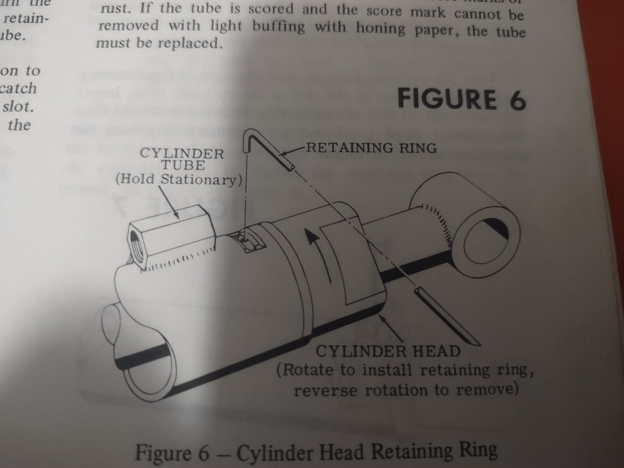

One of my lift rams developed a pretty good leak. I believe the correct rebuild kit is PN 70050-00301 for the lift ram. My loader has no identification plate on it but I gather it is a L1200 or L2773? To disassemble the packing cap do you depress the spring clip through the slit window and pull out?

I believe that the magic is that is a circular key and that you have to find the ends and get them into the slot. One of the ends will need to be pulled out a little bit and then it is placed on a ramp on the cylinder. Rotate the cap and the key is pushed out of the slot and then you will be able to pull it out the last little part.
Hope that makes some sense but I recall seeing some posts on here that showed that.

Finally had some time to get into this. The first thing that I found was an issue was the internal snap ring that holds compression on the seals was in about 4 pieces.
I can't rely on the old clip dimensions but the bore is 1 7/8 so I assume that's the size I need? Which would be a SR300-187.
