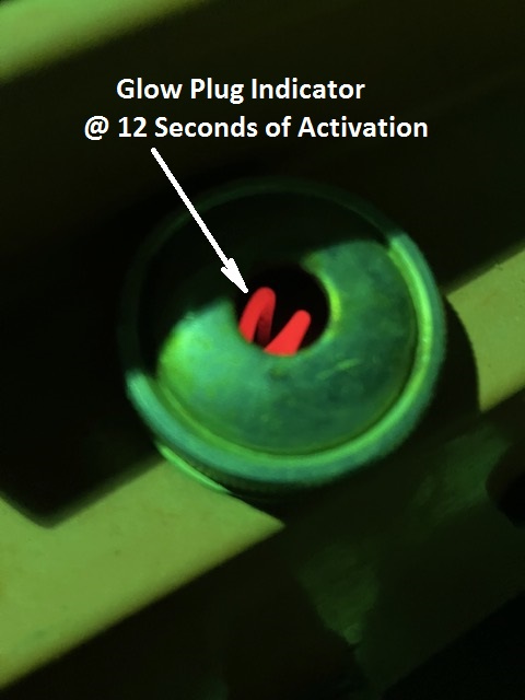

Look to see if you glow plug 'indicator' gets red hot when you hold the key to the key to the left for 30-45 seconds.

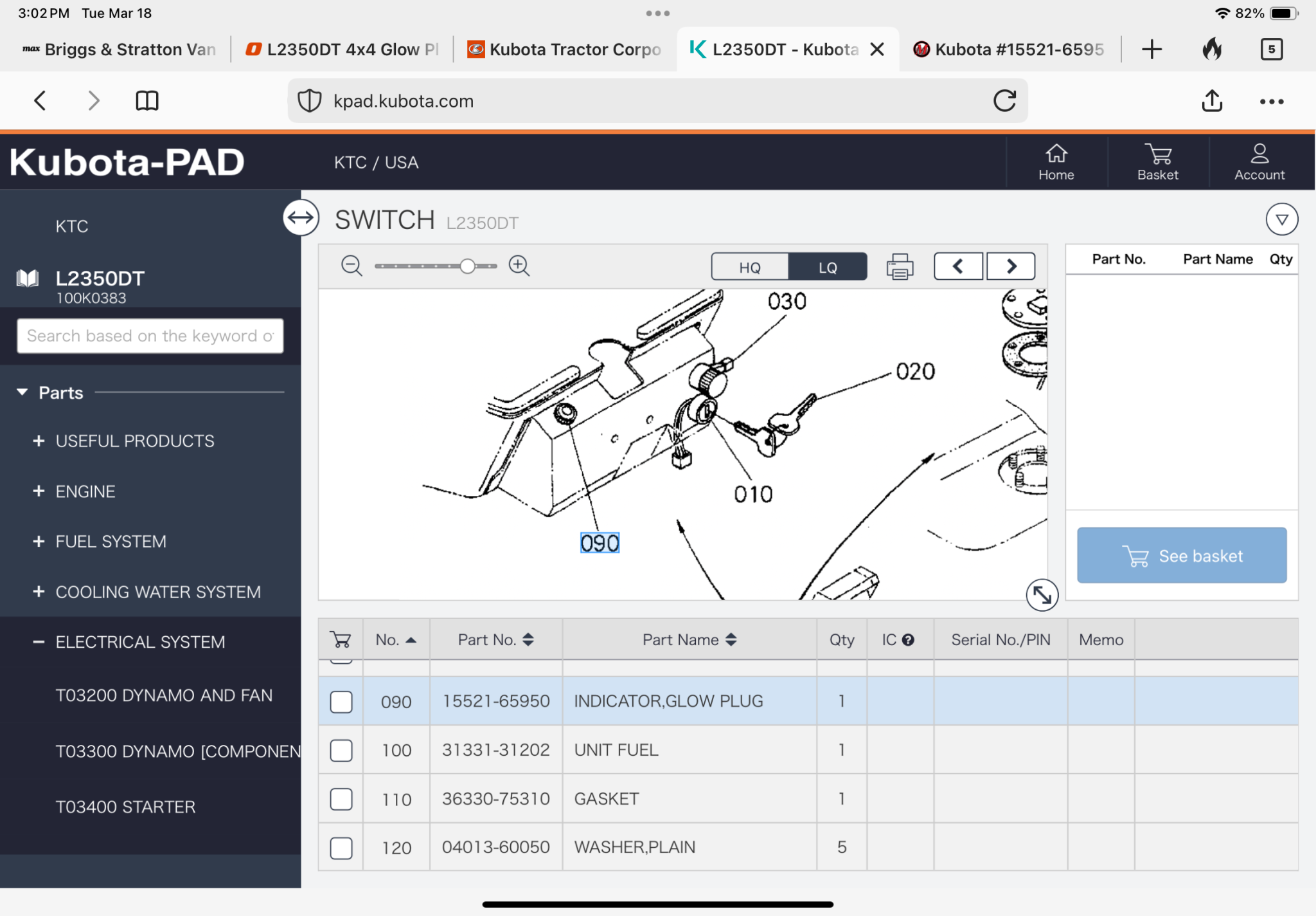

As I understand what you have (from these posts) is a very simple system that is similar to an L185. I looked on line to find the INDICATOR for the L2350
then I looked up that part number and see an INDICATOR

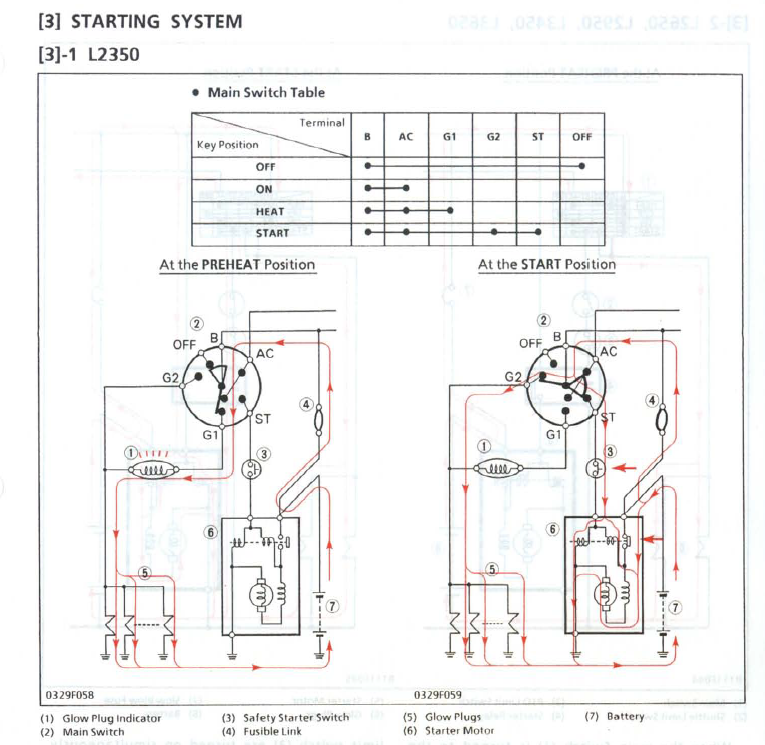

You have the WSM, envelope top right. 😉
The glow plugs are fed from 2 switch positions.
Path 1: Is Pre heat , from switch through the glow Indicator then to the glow plugs
Path 2: Is crank, it from switch to glow plugs.
Wiring diagram are on M.10-5
Glow plug paths are on M.10-7

Thanks for the info and diagram. Based upon the diagram in the Pre-Heat position, The only way I could have a Lit Indicator and no voltage at the glow pugs is if it is grounded down circuit from the Indicator prior to the Glow Plugs. Correct??

Based on the diagram. nicely supplied by NIW..
if one (or more) of the glow plugs is 'shorted', then yes, indicator lights up and no voltage to the plugs.
i suggest disconnecting all the glow plugs and measure them. Typically they are about 1 ohm each.
also while diconnected, put voltmeter to the 'feed wire' , turn key to 'preheat', you should get 12 volts.
You are correct that the indicator must be grounded on the low voltage side for it to glow.
That ground path is normally through working glow plugs, but could be a short in the wire or a defective glow plug that has zero resistance. I think it would be possible for a ground path back to the key switch on the crank wire but that would probably cause other problems. I guess the indicator itself could have failed and is shorting directly t ground through the case.

When you turn the switch to glow, the glow indicator (heating element) glows?
Your not talking about a Light bulb on the dash right?
If it is the indicator, How long does it take to heat up?
If it's quick then a glow plug or wire is shorted.
But if the wire to the glow plugs was shorted when you when to start it would melt that wire or more likely blow the fuse link above the starter.

GP indicator on mine (same tractor) will visibly heat up (red) in low light in about 20 seconds.

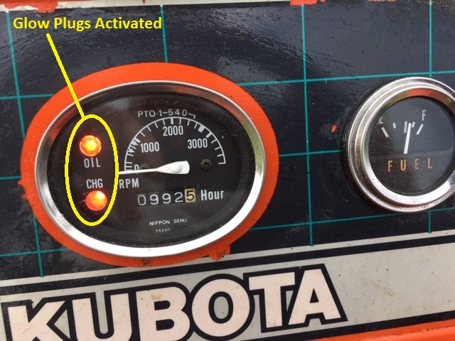

Is this a correct statement for your tractor? = There is no light bulb that indicates the glow plugs are heating.
My L2350DT has two lights on the dash that indicate the glow plugs are preheating AND a GP indicator ( a spiral resistive wire) that will glow red (hot) if the key is held in lefthand position long enough.
That is interesting but confusing to me. On my L185 the key-switch has four positions Off, Run, headlights low, headlights high. There is a separate switch that that operates the glow plugs when turned left and the starter/glow plugs when turned to the right.
The oil pressure light and charge light are on when the key is turned to the on position so the lights have no indication on the glow plugs, but do indicate that power is ready to be applied to the glow plugs. Once power is applied to the glow plugs then the glow plug indicator will glow (in dim light)
Please explain how your key switch operates and how it applies power to the glow plugs.
I hate to disagree with you but the only reason the lights come on, on the dash have nothing to do with the glow plugs, it's a light test so you know they are working.
Later models they called it the easy checker system.
Look at the schematic there is no glow plug to dash wiring.
