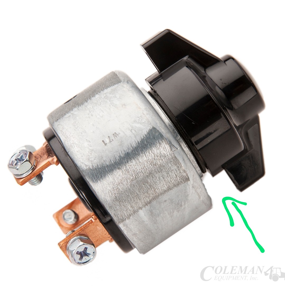

Does anyone know what thread or what nut size will work to hold the starter switch to the dash? My tractor was missing the black knob when I bought it years ago. But now the nut that holds it to the dash has vibrated off an the switch is flopping. Just trying to figure out how to get a nut that will work without buying a new $100 switch. If I have to I'll take the switch out and take it somewhere to try to figure it out. Just hoping to figure it out without taking it out of the dash.

Hey @Mikew22
I have the nut and washer for switch 37150-32200 (glow plugs/starter switch) and need to get your address.
Please reply to the message and I will get it out to you.
By the way it measures 22 mm inner diameter on the nut.
