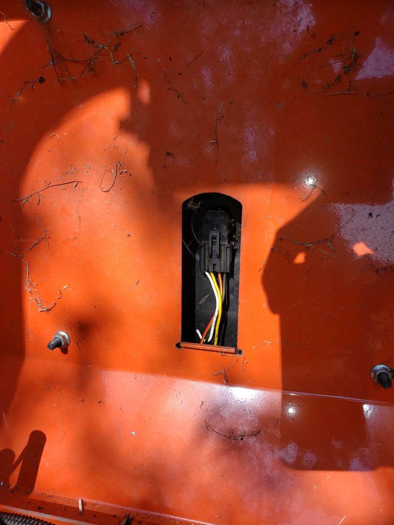

Here is the seat safety switch, located under the seat pan.

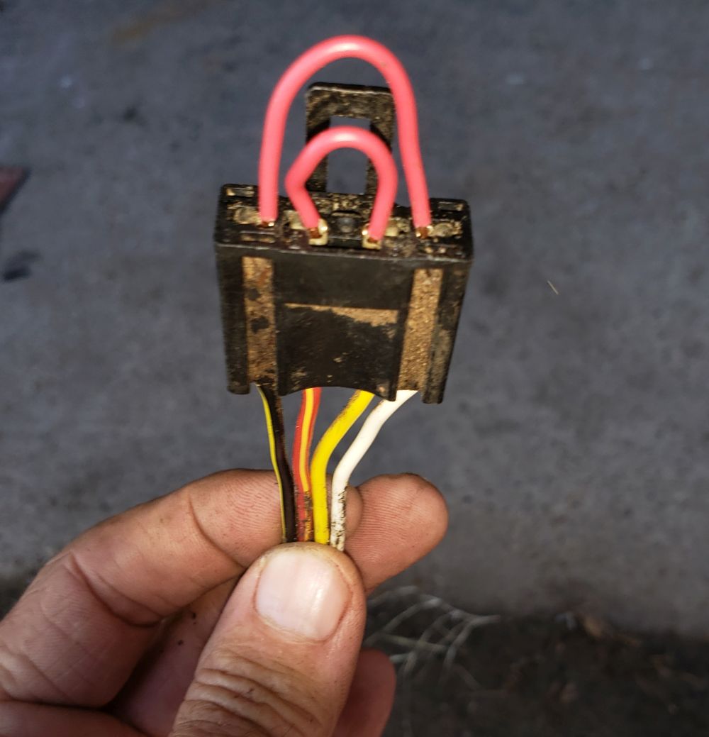

Pull the connector and jumper it as shown.
If it now starts you found the problem, bad switch. My connector was full of trash and cleaning did nothing for it. So you can hand kubota parts a handfull of money and replace the switch or just bypass it long term. This process is reversible. Cut the connector off leaving a couple inches of wire and stick the connector back on the switch and forget it exists. Strip the 4 wires on the harness. Twist the wire pairs together as shown.

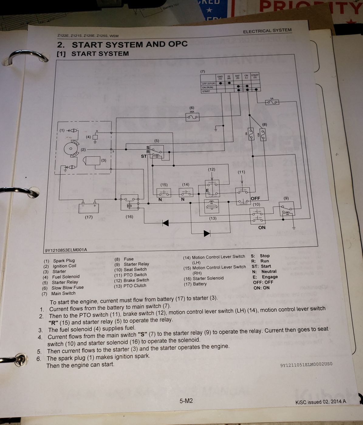

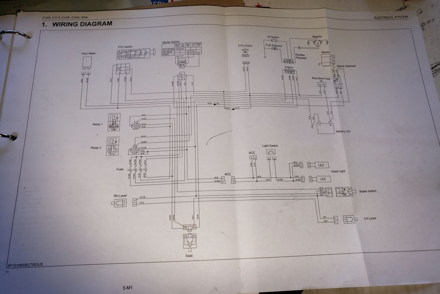

Just in case you have to delve deeper, here are some wiring diagrams.
Bless you sir, for posting these diagrams. I am doing an engine swap on my Z122E and I couldn't figure out where the green wire from the engine harness went to (the old engine was destroyed and my brother, in his haste, started pulling wires without keeping track of where they went). Oil switch.
