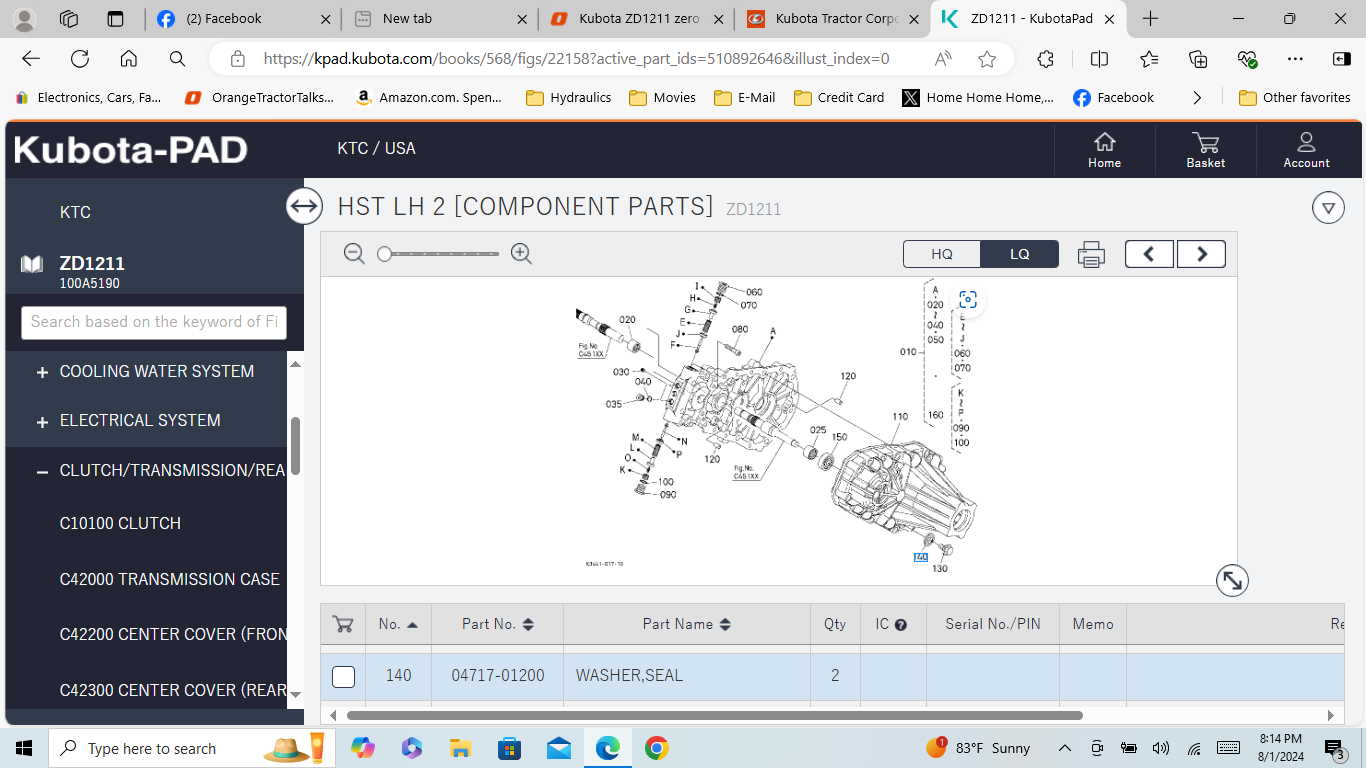

My model (just the straight ZD1211, not the LH or RH) does not have axle drains (at least according to the manual)
All ZD1211 units have a drain at the bottom of each rear axle housing.
Part #130 is the final drive drain plug, there is one on each side.
