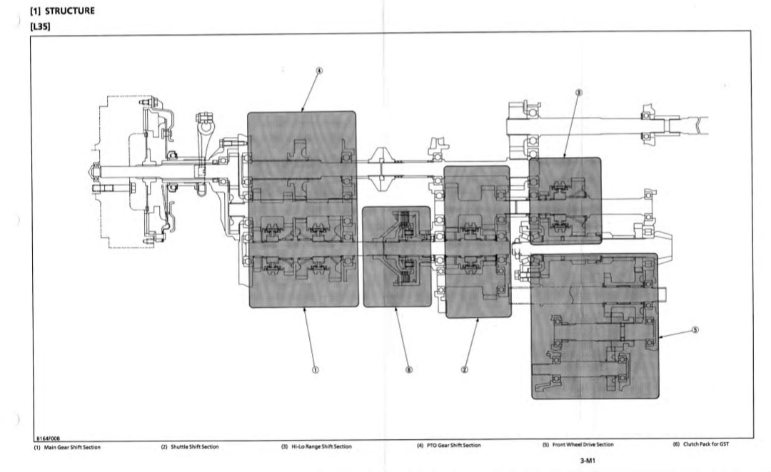

kinda 'neat', almost a clock it's so slow. Sadly ,L35 isn't in Canada Kubota's Parts finder, so I couldn't 'see' what's inside. Since it still drives,not a total failure, BUT agree, it's have to be split to SEE what's causing the noise. maybe someone an post 'what's inside' drawings or has seen, er, heard this before ?

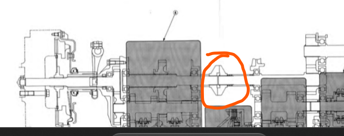

I listened again and the clunk seems slower than engine RPM, so wondering does that orange circled one way clutch spin at engine RPM or slower ? 'clunk' sounds like something hitting another 'something' once per rev, then nothing....maybe a spring loaded cam,no longer spring loaded ?centrifugal force makes it 'clunk' but without spring, it 'folds' away, doesn't break...over and over and over....
