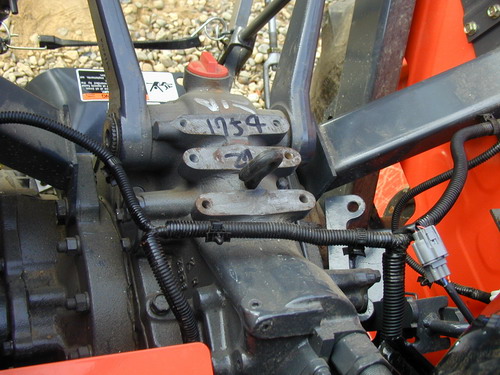

Only thing I can think of, look for the breather tube under the seat - see if it's clogged. Might be heating up and extra air pressure can not escape....
Under the seat... only photo I have is without the seat attached.... The question mark, rubber tube thing...
