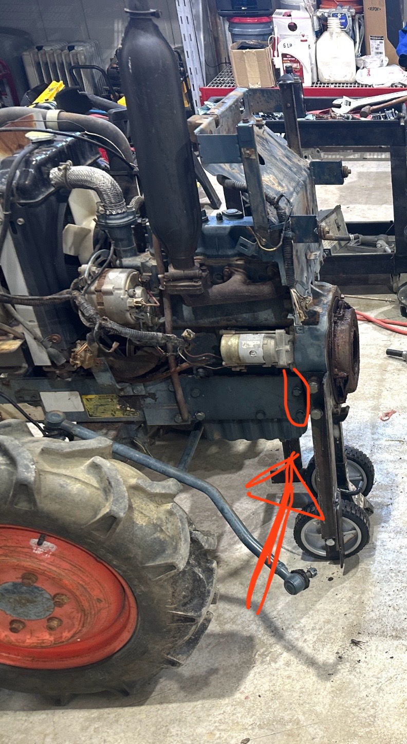

A couple of things to be sure to do; 1- cut wood blocks (one on each side) to place on each side of the tractor frame at the front axle. These keep the engine from flopping to one side when it is separated. 2- mark the holes on the flywheel so you can install it in the same bolted position. When you go to install the flywheel bolts screw them several turns by hand to be sure you have the flywheel clocked correctly. If the bolts don't thread easily, quit rotate the flywheel one bolt hole and try again!!!!
I'd suggest blocking the rear tires so they can't shift forward or back. Use a long handled floor jack under the engine (with a piece of wood between the jack and engine oil pan), then when the lines and bolts are removed you just roll the front forward.

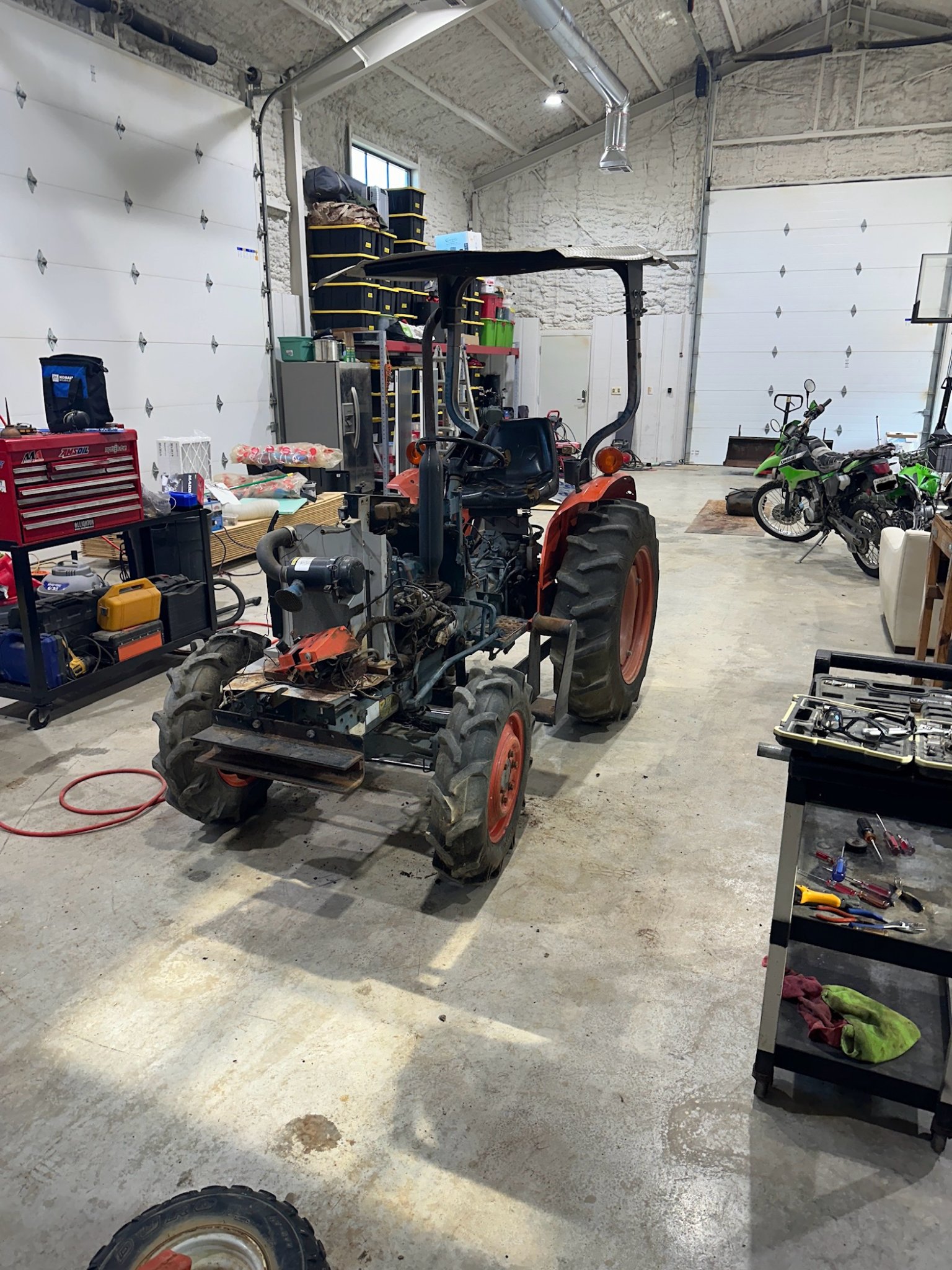

So we have the clutch bought and we are ready to move it into the shop….but we have the 2245 QT front loader on it. Any special way to unhook it? Looking for a manual but can’t find a free one online sadly.

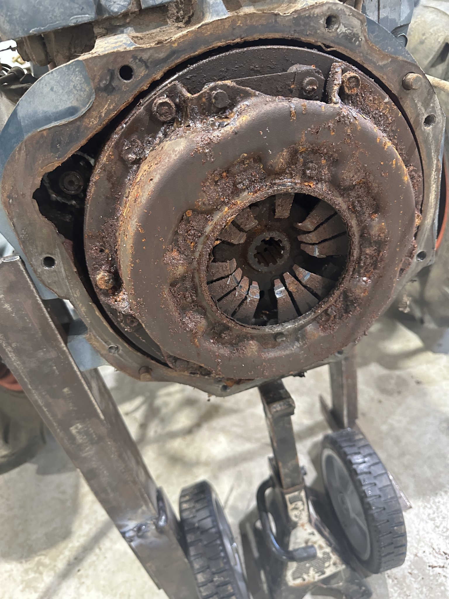

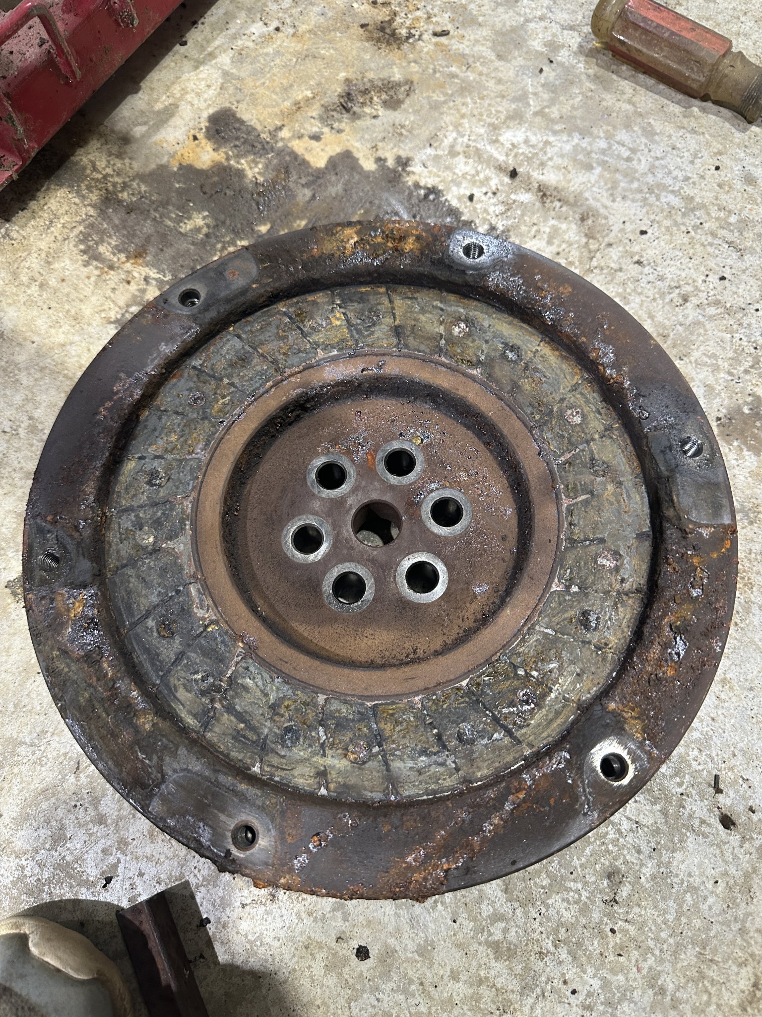

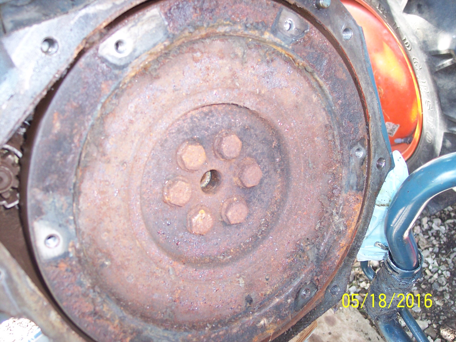

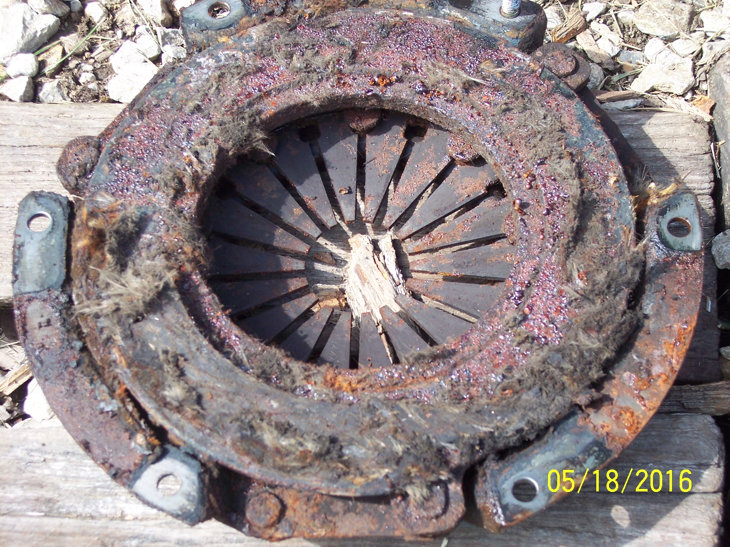

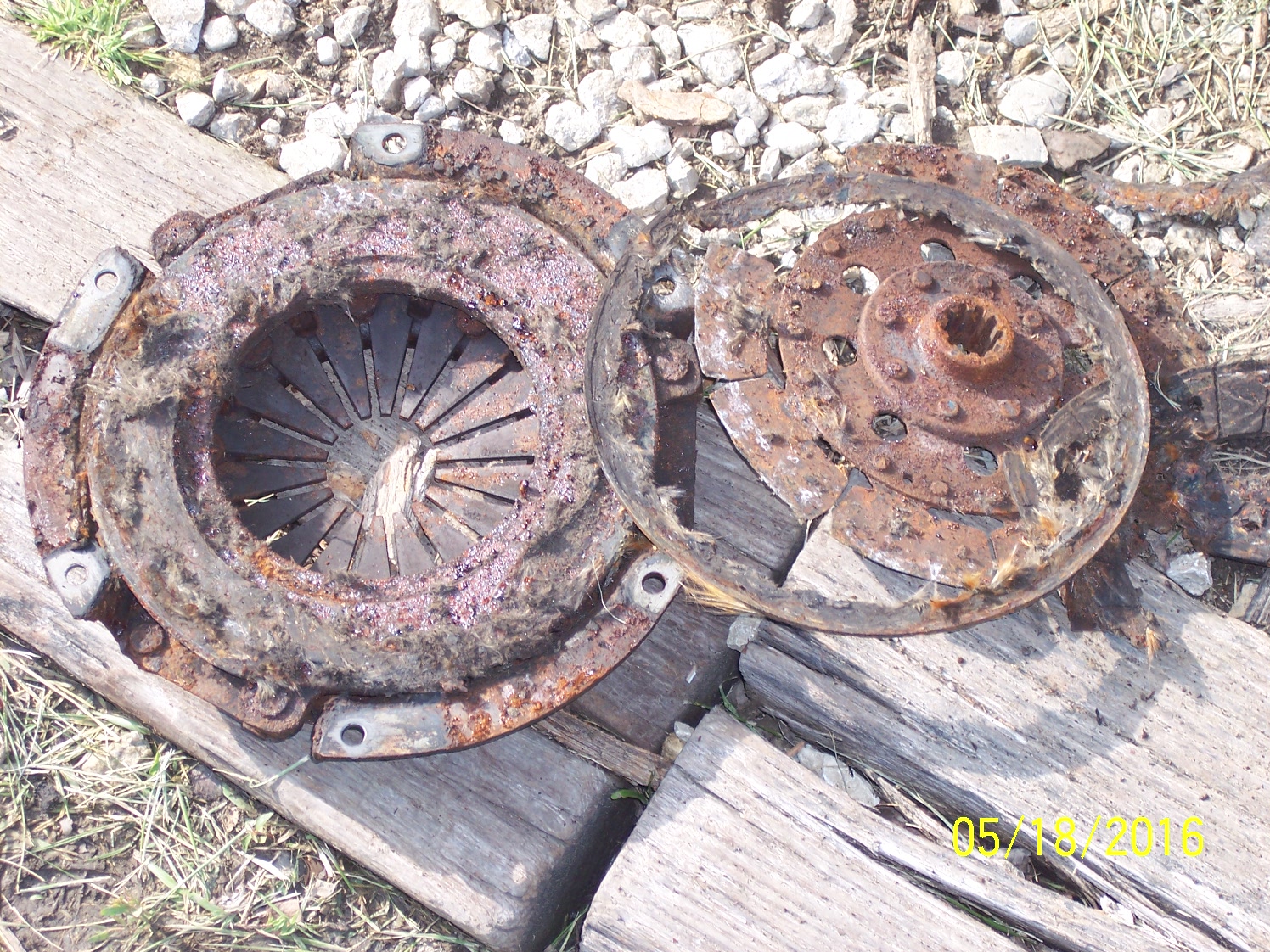

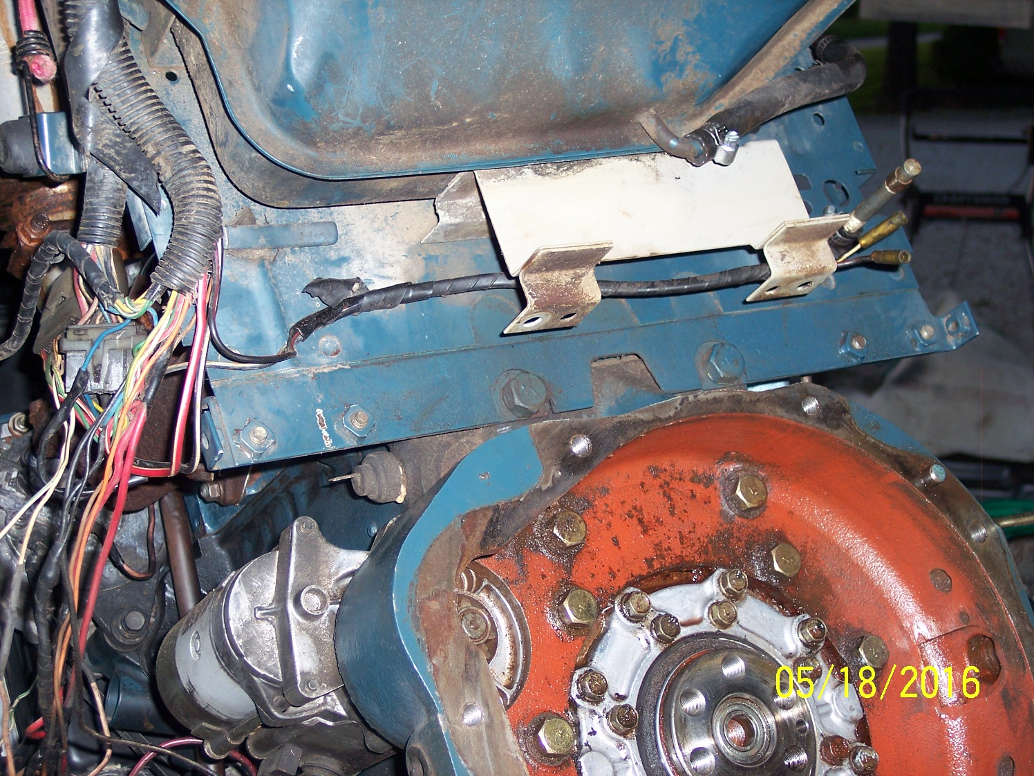

Well, what are my options fellas? Do I try and clean up the flywheel and have it resurfaced or by a used one on EBay? New is $1,100 !
Also, what would cause the white corrosion? Is that from possible antifreeze/water? It’s been sitting for over a year out in the elements…

White is aluminum oxide corrosion (just like rust)
Just clen it up.
For the flywheel:
DO NOT resurface it.
Just sand the surface with something like 40 / 60 grit sandpaper and call it good.

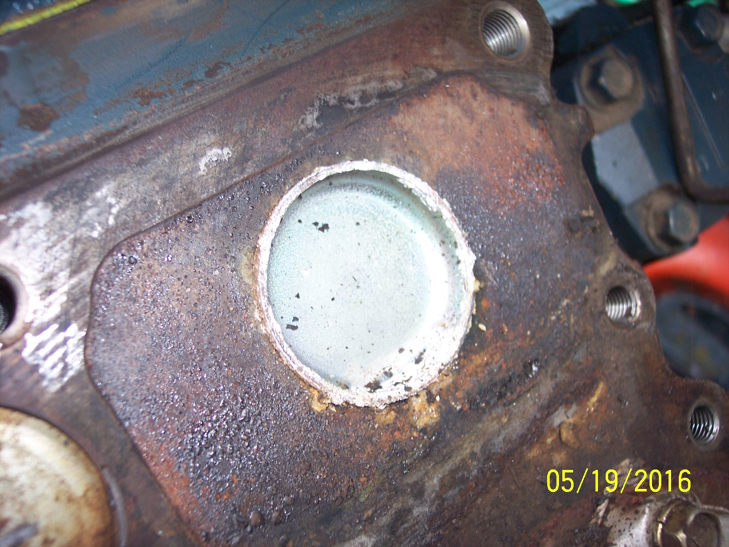

Seems to me there is a freeze plug above that bell housing. I had the same tractor with the same looking clutch and that plug gave up the ghost releasing the water to cause the trouble.
I had to remover the fuel tank to get to the damaged plug. It wasn't too much fun!

Yes like D2Cat said, pull the bellhousing off and check the back freeze plug.

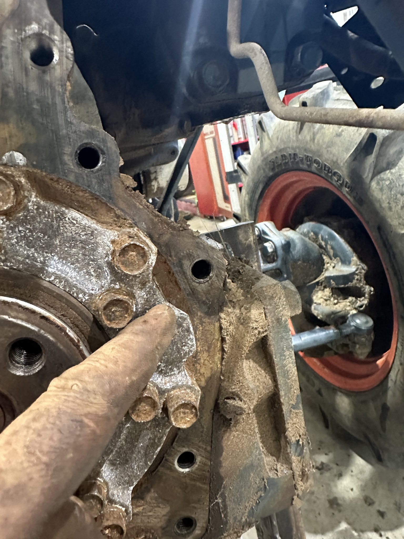

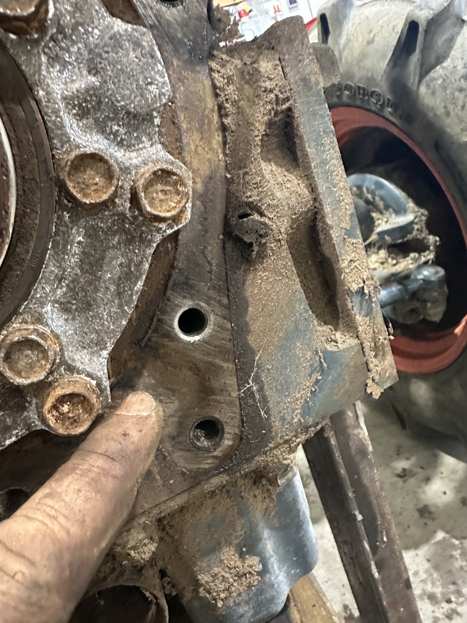

Well, pulled it off and the freeze plug looks in great condition. On the pictures you will see where I circled…getting moisture in these areas?? Looks like they are coming from the bolt holes? Is that normal…I dont think so…. I cleaned the area and we will see if it’s leaking from the bolt holes.
On another note, should I see coolant come out of these bolt holes when they are removed?? See red circled bolts.

It's not uncommon for coolant to be behind some of the bolts, but I'm not sure yours is what i would call common.
Since you have everything still hooked up to the cooling system, I would do a pressurized coolant test.
Clean all the bolt holes with brake parts cleaner and dry them before you test.

I blew them out last night and no leaks or water shown at all. I guess possible residual?
29,631
5,853
I've had that happen to me the coolant just hangs out in the holes.
A leak test might still be good to make sure a plug or gasket is not leaking.

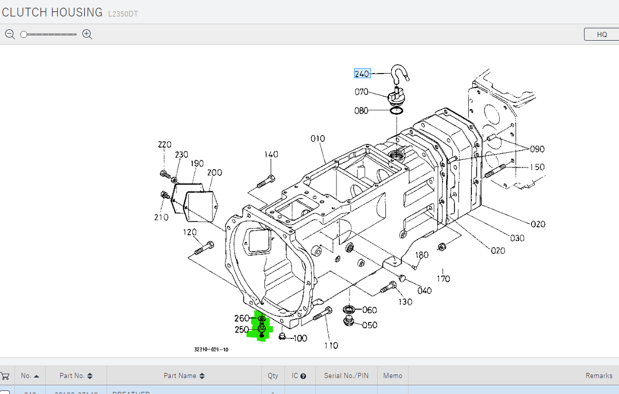

How does the split pin drain look?
If it's plugged it will cause condensation to not drain and that can do it too.
