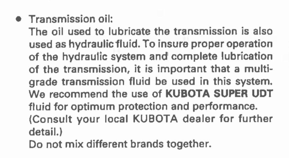

Here's what the OM says
With GlideShift, I'd use the newer SUDT2.
