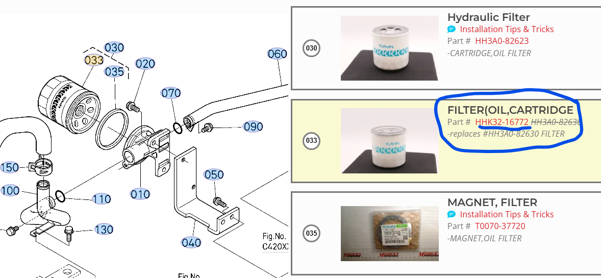

This is a shot from the manual.
This is the engine oil filter: Kubota OIL FILTER(CARTRIDGE,OIL) - HH164-32430
The one I'm struggling with is the same shape/size as the original grey painted one on the right side but I obviously couldn't read the number on it. I see now that the part number you mention might be the one w/the magnet on it. Maybe the one I have isn't meant to use a magnet - but wtf would they do that?

yea...and it looks like they are supposed to work together anyway...Maybe

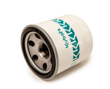

When you put the magnet in the filter did it look like this?
And was not higher than the seal?

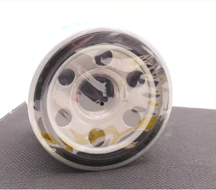

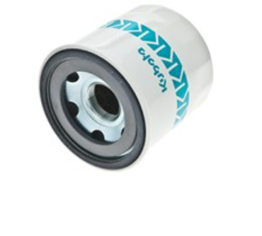

Put a vacuum on the filler, and pull the filter and take a picture of it.
HH3A0-82623
I'm betting that the HHK32-16772 does not except the magnet, because it has a raise rim inside the gasket.
HHK32-16772
HHK32-16772

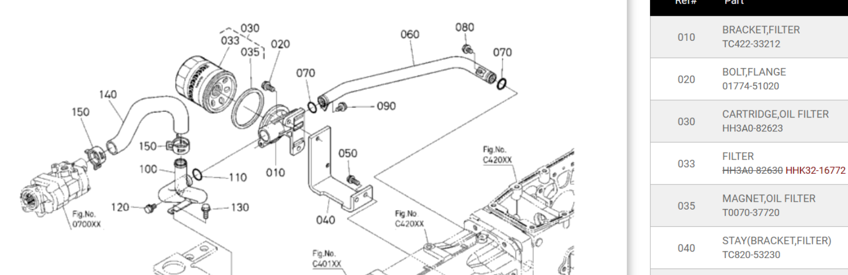

You may have something there! I'm heading to the dealer tomorrow to get another couple of gallons of UDT2 and I'll get them to show me both filters. If the one I used has the ridge then that solves the mystery in one way. The problem is that per the diagram the one that comes with the magnet is the same filter but with a magnet included. I'll problably bite the bullet and buy the one with the magnet depending. ...and do the shop vac trick.

If @North Idaho Wolfman is correct and the schematic is wrong, I think that the dealership should give you a new (correct) filter and some hydraulic oil at no charge. Anyone would reasonably assume that it's the same filter with or without the magnet, based on Kubota's schematic.
