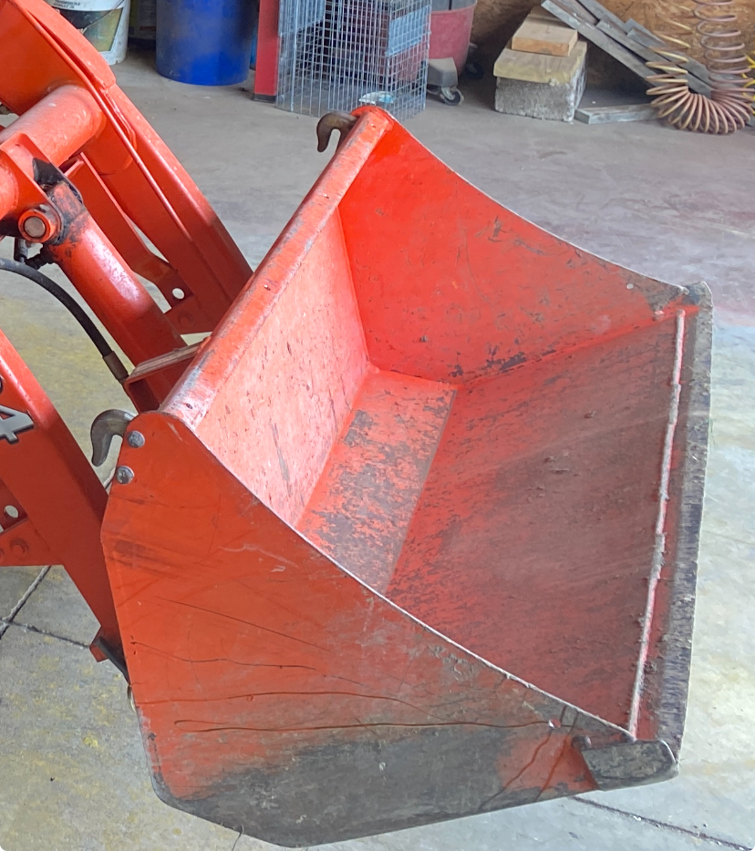

I went the cheap route and bolted on some weld-on hooks to the sides of the bucket with 3/8” bolts.
5,777
2,961
Interesting! First time I’ve seen that done!
Certainly thinking outside the box!
I suppose you could hang a bit of excess chain over the bucket top lip, and that would keep the chain in the hook until you got it under tension.
11,370
4,885
Ideally install 'inline' with the loader arms 'for best results'.
Might consider a thick flat bar or angle iron 'stiffener' on the inside of the bucket to prevent top lip from curling down.

I like my hooks welded on a 2"×3" - 3"×3" plate, then the plate welded inline with the loader arms. *The more surface contact the better.*

Hooks inline with the lift arms are best. For center lifting, drape a chain on both hooks and connect in the middle to center the chain.
