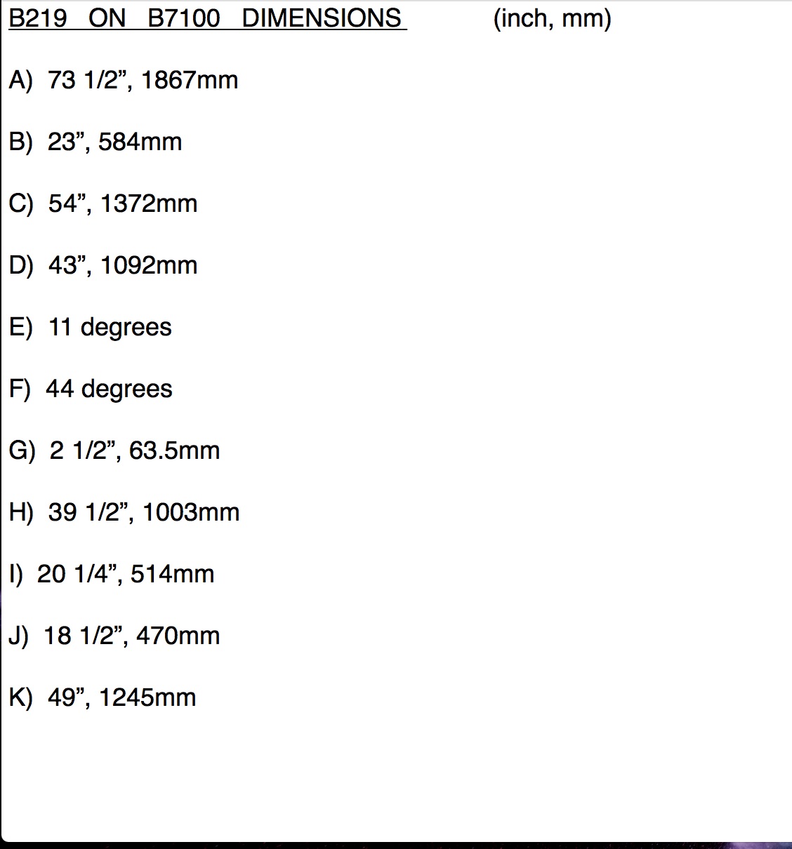

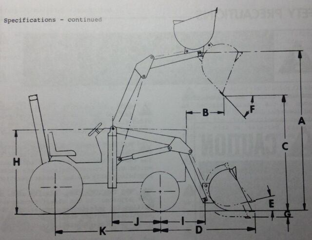

First post. I've been looking for a kubota b7100 D gear transmission with loader. They come up from time to time locally. I'm getting close to purchase time when one pops up. My question is, what is the dimension of the tractor from factory loader end to 3 pt tip, and same for width and height with rops? Non turf tires. I have a coop I was thinking of changing to shed that might be the right size. The alternative is tear the coop down. Thanks for any help.

Tractordata.com has the dimensional data for all Kubota models listed and the attachements, but you will have to do a little math to get the total length with the loader.
