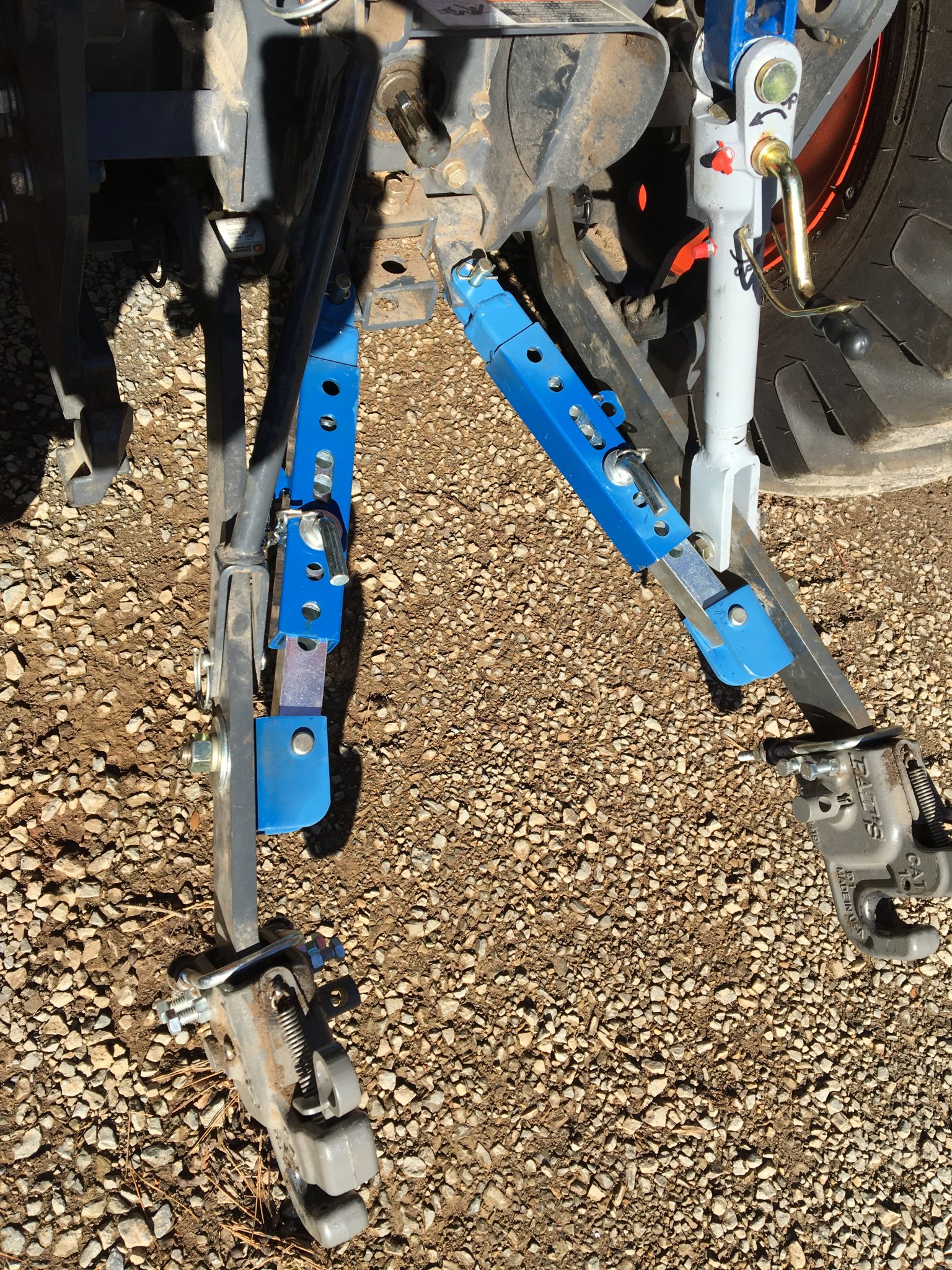

Congratulations on your B26. A little tractor with a big heart. You can find Wholegoods price lists for Kubota TLBs and all their options by internet search. Usually published by government price quote. Good to know prices of buckets, bucket ears, 3rd function kits, thumbs, remotes, etc.
Installing the lower pin bar requires removing one rear tire to insert. Use high spring tension lynch pins there helps keep branches from unlocking. Black ones at TSC.
Never liked the short T/Rex 3pt arms on the B20 or B26. Nor the turnbuckles. Upgraded the B26 by adding Pat’s Quick Hitch, bar stabilizers and gearbox leveling box. If you do grade work a must have.

Hey @Smokeydog woukd you mind sharing the part numbers of the items you bought to upgrade the stock kit. I am currently looking to purchase the kit from homegoods or maybe part it out to include the upgraded parts that you found helpful. I am new to using a 3pt so any info I would greatly appreciate. Thank you for sharing!
Sorry that was seven years ago. Should have kept better notes.
Sway bars from eBay about $120pair and had to be modified cut/weld to fit.
Same bars modified to fit M59 so built tough.
Leveling box from weaver tractor supply. Had to use one of the sway bar end yokes to connect leveling box.
