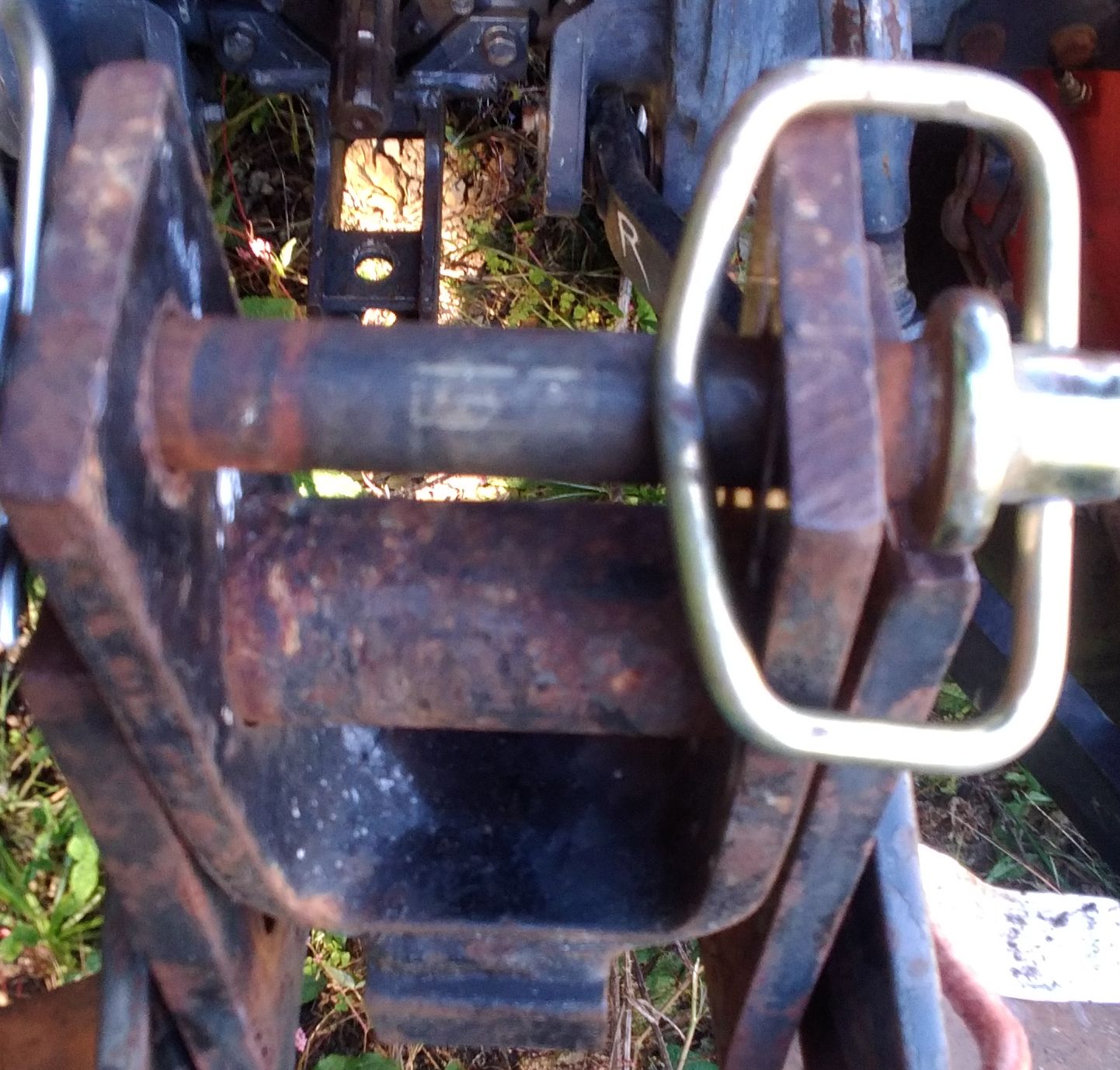

G garrettohio Member Equipment Kubota L2900 Sep 16, 2023 77 2 8 Ohio Today at 11:12 AM #1 On the top link a standard category 1 pin was to short the way it was when bought it.acording to what I can tell this piece pictured is suppose to raise up and the frame supports fasten with one big bolt.how exactly should it go?

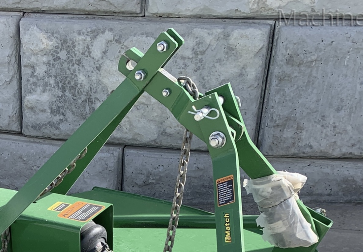

R Russell King Well-known member Equipment L185F, Modern Ag Competitor 4’ shredder, Rhino tiller, rear dirt scoop Jun 17, 2012 5,242 1,326 113 Austin, Texas Today at 12:04 PM #2 Back away a little bit and take another picture from the side. Here are some pictures that might show you how to arrange it. But I suggest you get an operation manual that shows how to hook it up. King Kutter. Manuals

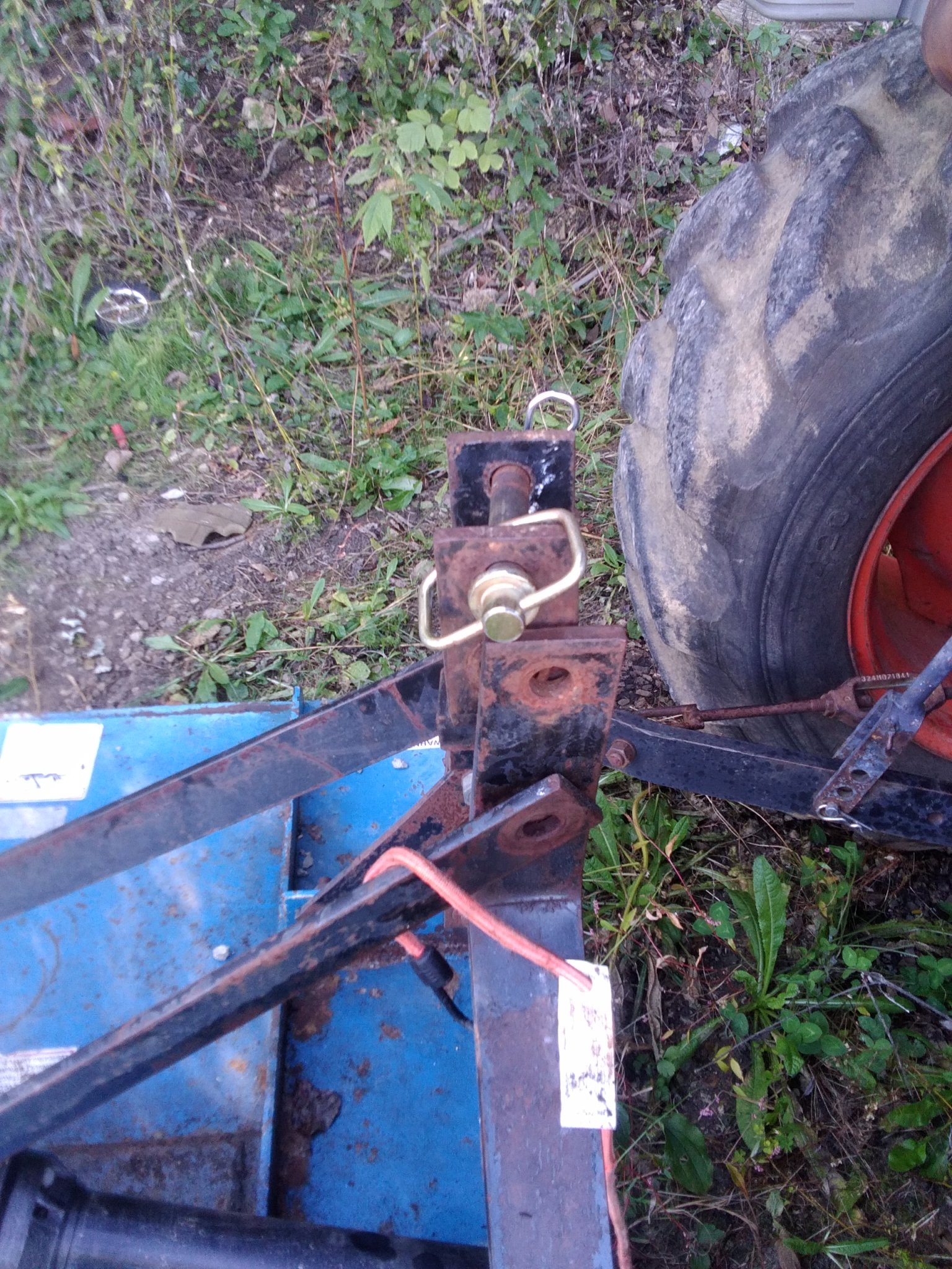

G garrettohio Member Equipment Kubota L2900 Sep 16, 2023 77 2 8 Ohio 17 minutes ago #3 From researching it's a king kitter with floating top link bracket. Attachments IMG_20241019_155330.jpg 607 KB Views: 0 IMG_20241019_155321.jpg 687.6 KB Views: 0 IMG_20241019_155313.jpg 712.8 KB Views: 0 IMG_20241019_140017~2.jpg 268.2 KB Views: 0
