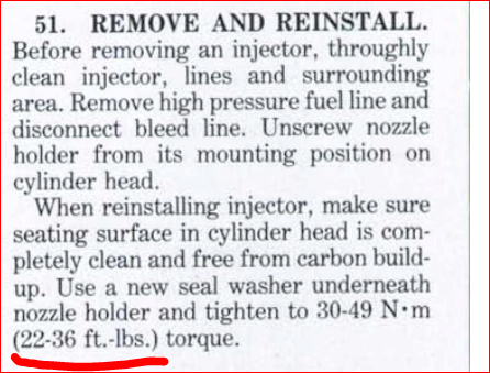

T two4cadence New member Jun 14, 2024 7 1 3 California Jun 14, 2024 #1 I understand this tractor is "grey". I don't have a shop manual for this engine. I took the two injectors out to clean them and they are ready to go back in. I need some torque numbers to finish the maintenance. Thanks

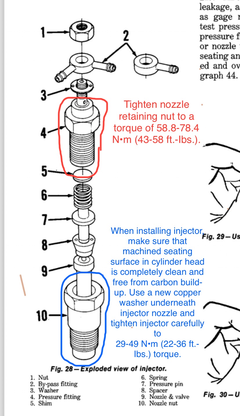

85Hokie Moderator Staff member Lifetime Member Equipment BX-25D ,PTB. Under Armor, '90&'92-B7100HST's, '06 BX1850 FEL Jul 13, 2013 10,667 2,438 113 Bedford - VA Jun 14, 2024 #2 Your L1501 is almost the exact same as the L185 The workshop manual can be found here: https://kubotabooks.com/AutoIndex/index.php?dir=Tractor Owners Manuals/ go to page 26
T two4cadence New member Jun 14, 2024 7 1 3 California Jun 14, 2024 #3 85Hokie said: Your L1501 is almost the exact same as the L185 The workshop manual can be found here: https://kubotabooks.com/AutoIndex/index.php?dir=Tractor Owners Manuals/ go to page 26 View attachment 130853 Click to expand... Much appreciated!
