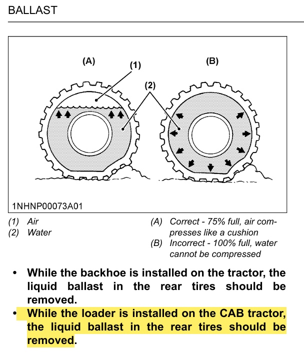

Per the manual for my LX3310:

I need some help understanding the hi-lited sentence regarding the removal of the liquid ballast in cabbed tractors. Copied from an earlier post above:
EDIT: I DO understand the sentence, but not the reason :)
