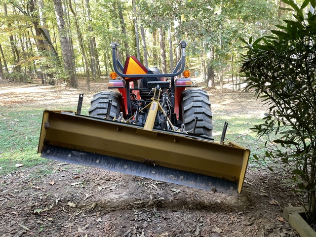

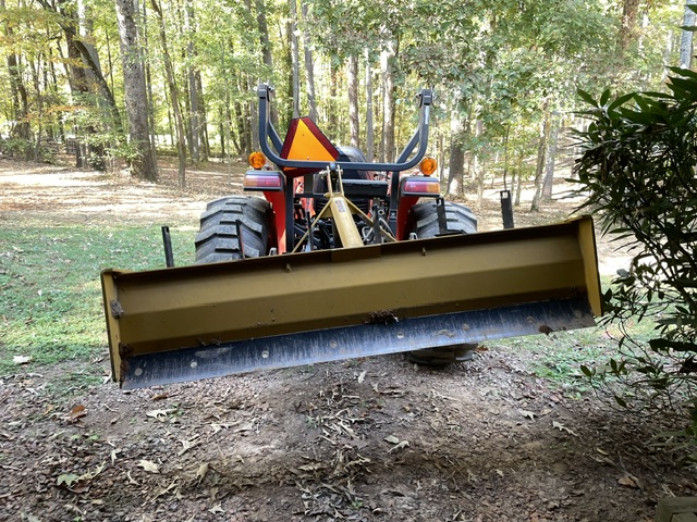

If I known what I do now about the MX line, here’s what I would have done if buying new; Loaded tires, 3 sets of wheel weights, wheels set wide, 3 remotes for top and tilt with one extra. Saying all that, this is how my tractor is setup but I did it after the fact, which cost be a little bit more money.
4-1 buckets are very heavy, takes away from what you can pickup. A regular bucket with tooth bar and a grapple are in my eyes a better option.
Look into a heavy rear implement if doing loader work, with all my weight and a 780# box blade I can lift a rear tire at will. My 900# tiller makes all the difference.
Here is an extreme example of a hydraulic top link. But shows what it will do. Fully extended vs. fully retracted.

Man I appreciate the visual! That makes it make so much more sense.

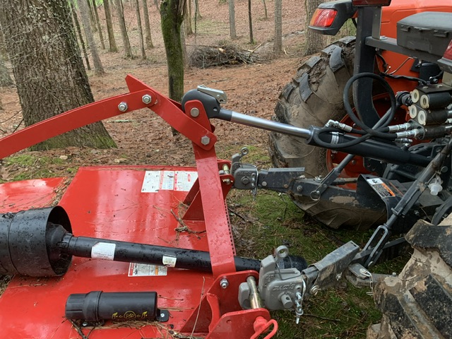

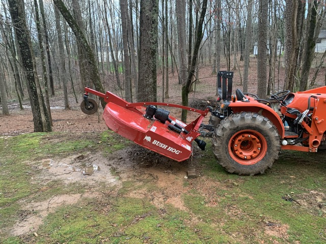

Here is the side link at both extremes. 3 point is fully raised in both pictures. Worth noting, I moved the manual link over to the left and set it sorta in the middle, if needed I could lengthen or shorten for even move angle either way.
