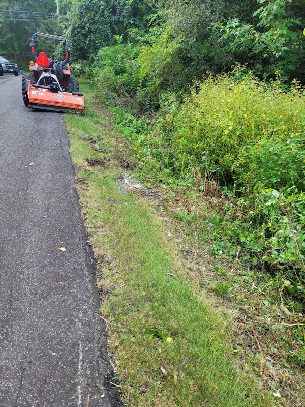

I picked up the Woodmax FM62H. I use it alongside the driveway.
I have a top n tilt so I just tilt it some. The hydraulic offset keeps me from getting 'too close' to heaven. I wish it had more. A wider mower would help here.
I also used it in the woods to clear a trail for the dogs. It has hammers on it in lieu of knives.
This year I am going to try cutting the lawn with it also.

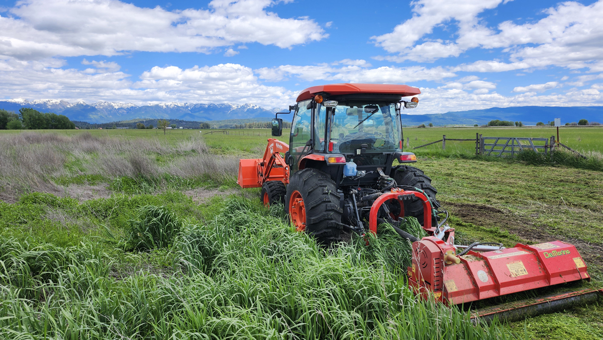

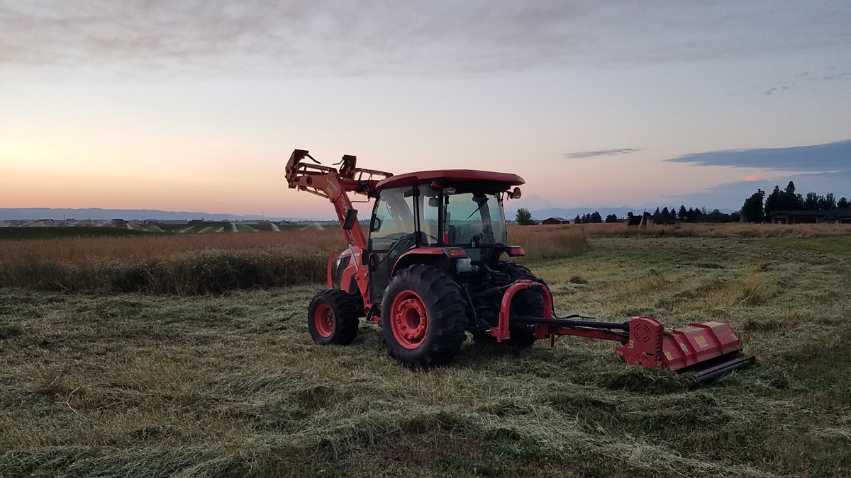

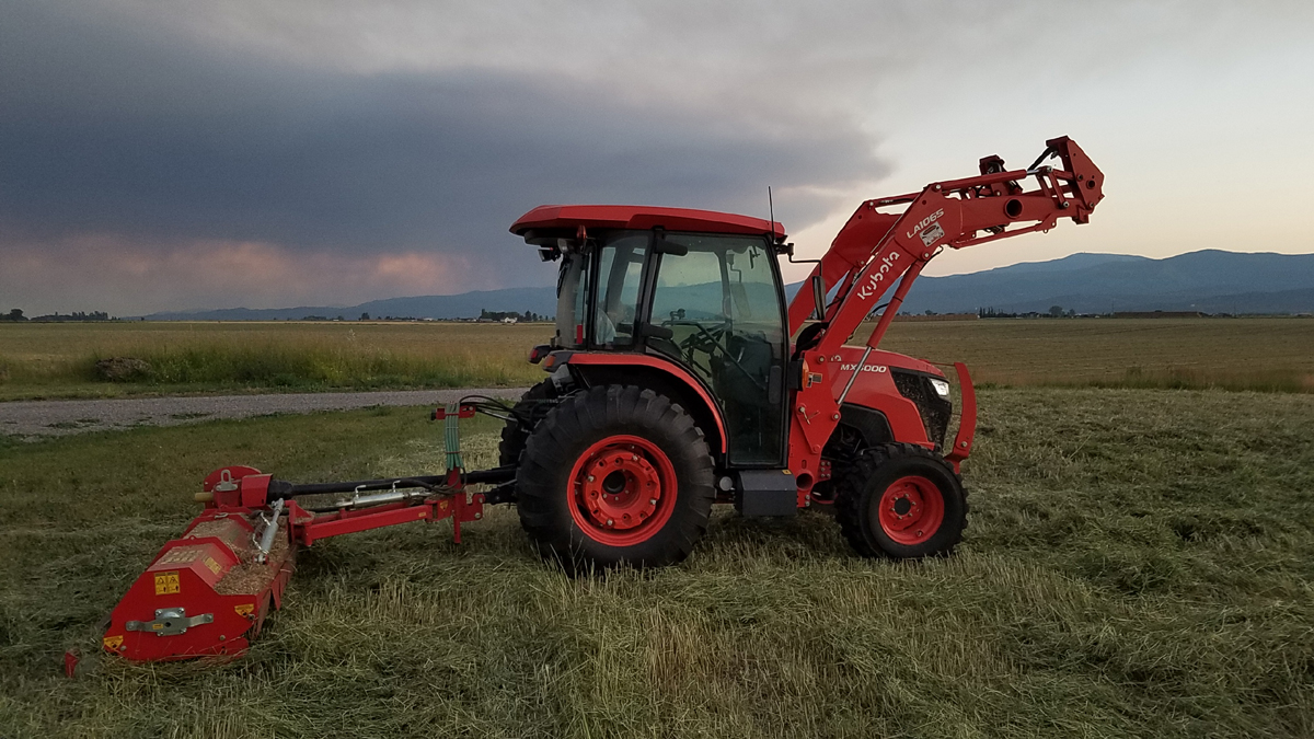

I have a Del Morino Centurion Super 158 which works very well behind the MX6000. It's only a 5ft cutter but it does have the hydraulic offset and cutting head angle feature. Technically I could cut the face of a hedge but I don't have any of those, so for me it's useful for cutting banks and such. One of the advantages of these offset flails is that you don't have to drive over what you're cutting before you cut it. The right side wheels/tires will run over whatever you're cutting unless you take a 3ft to 4ft pass and then you don't run over anything, but that adds to how long it takes to cut 10 to 12 acres. There's a Flipper Super model now with a 6ft cutting head which would be great, but they're pricey.
Would I buy this exact model again? Yes, I would, or anything made by Del Morino for that matter. Their products exude quality and Good Works Tractor Co., does a great job of supporting the end user.

now that's an offset!

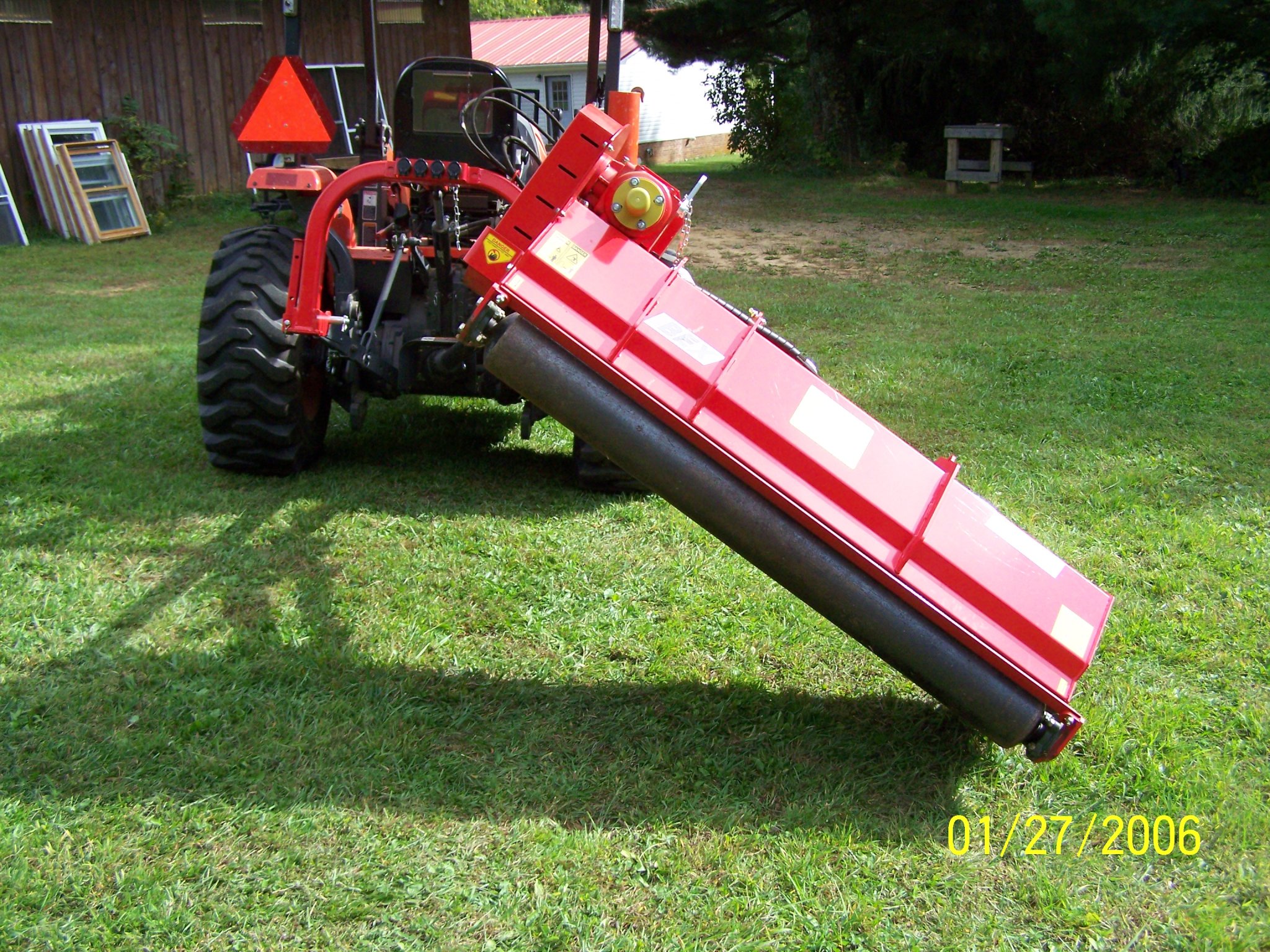

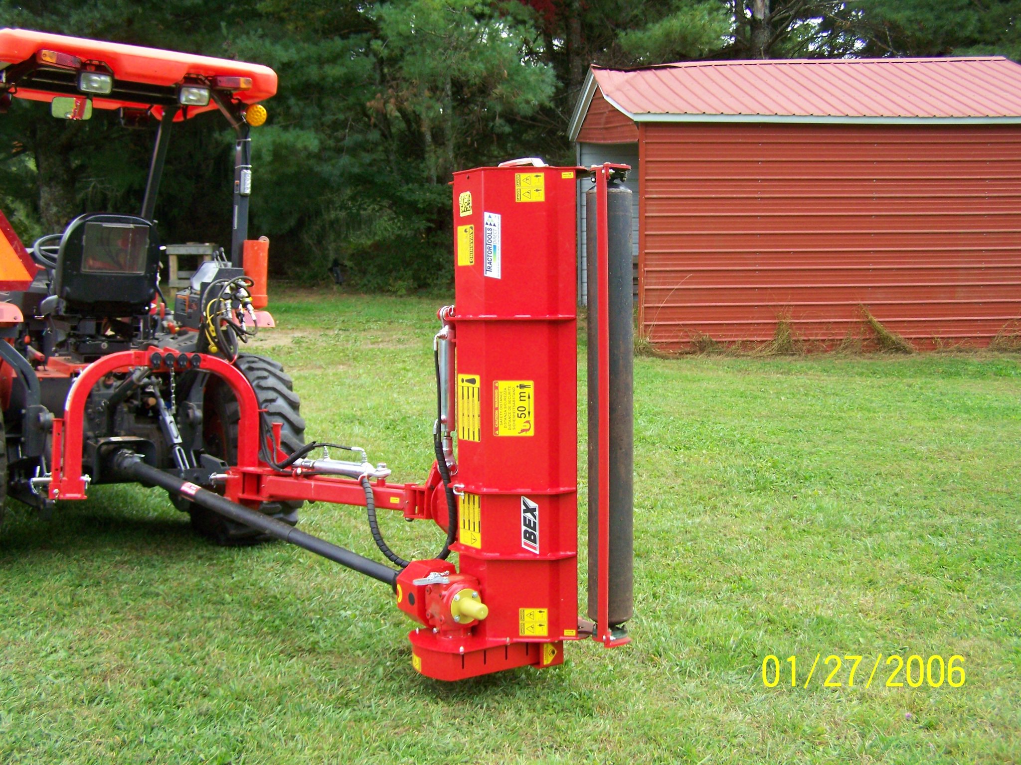

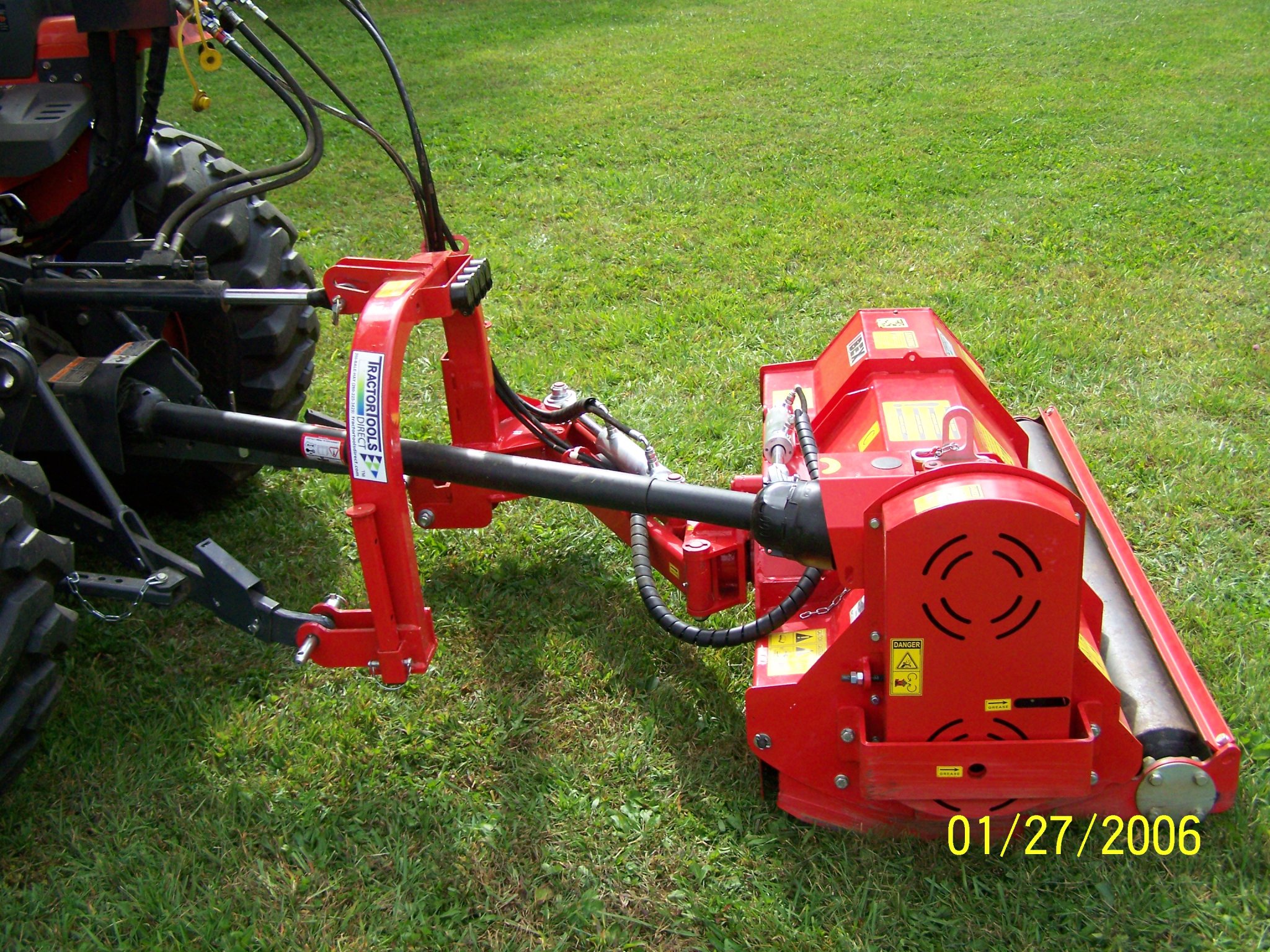

I bought this from tractor tools Direct. It's a rebadged Del Morino.
It worked well but I was uncomfortable about the leverage on the 3ph because of the offset. I would be less concerned if it was on a cat 2 hitch.
I intend to buy a unit without the hyd offset. Pay no attention to the date on the photos.

Yep, that IBEX is "identical" to my Del Morino Centurion Super. I don't know the nature of the relationship but it seems that IBEX gets them from Del Morino. Tractor Tools Direct has a decent price and appears to be lower than Good Works Tractor Co., where I bought mine.
@notforhire , were you having problems running the flail on your L47? If that's the case I'm surprised to hear that.
I highly recommend Del Morino or IBEX, and if you take the take to look at the design compared to many other models you'll notice that the Italians have it figured out with gusseting in the right places and quality components. The stuff looks to be engineered rather than thrown together.

What size tractor you have? I’m getting my L6060 in 2 weeks so wondering how it would feel extending out.

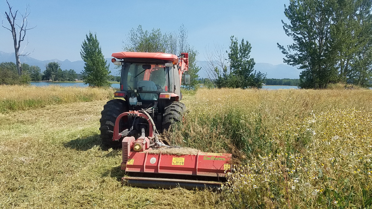

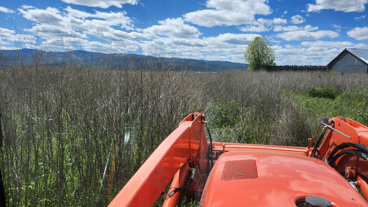

I cut some really tall stuff that was over the top of the cab in places, but the flail made quick work of it. You can see the first pass as I cut my way into this paddock.
Before.
After.
