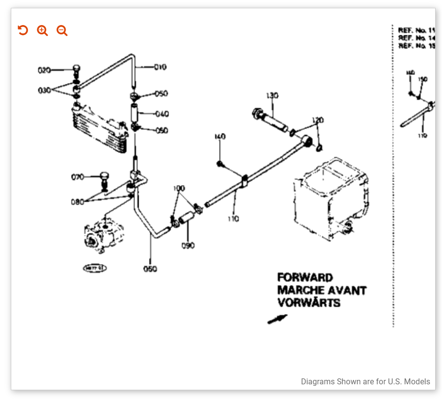

Bubbles suggest it is sucking air. Check the suction line rubber hose and clamps #40 and 90. Really just check this whole area.
